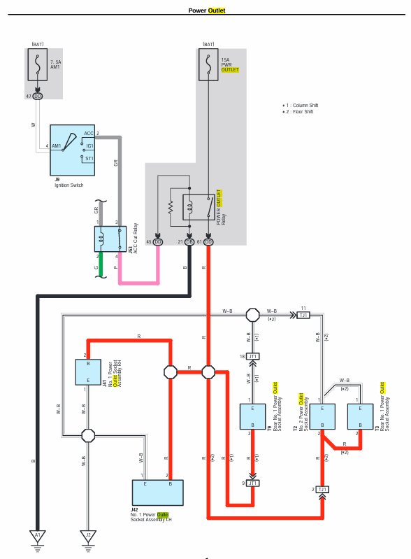

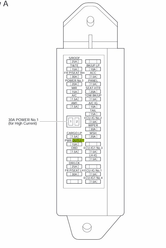

    Hey y’all! So I’m new here and I saw the thread for this but it wouldn’t let me reply so I’ll just be that guy and ask again. My apologies. I just bought my 2015 tundra last week, and I love it, but I went to plug in the adapter for the phone charger and nothing happened. I read through the other thread about this and checked every fuse under the dash and under the hood and I’ll be damn, none are blown and the outlets still have no power, can anyone give some suggestions?? I appreciate your time!

    You need power and ground. If you say power is good, then you need to check if the ground is good. A multimeter will be very helpful. I would also use the multimeter to double check the fuses.

    Same issue in my 2015. Replaced blown fuse, but still no power. Did you resolve the pwoblem?

    The wiring for those outlets are very short, not much slack, it's easy for them to get disconnected if any work is done on the console.

    There is a POWER OUTLET fuse as well as a relay.
    They all seem to have a common ground too.
    That fuse is under the dash..
    There is also the AM1 fuse, but I think you would have more issues if that were the problem.
