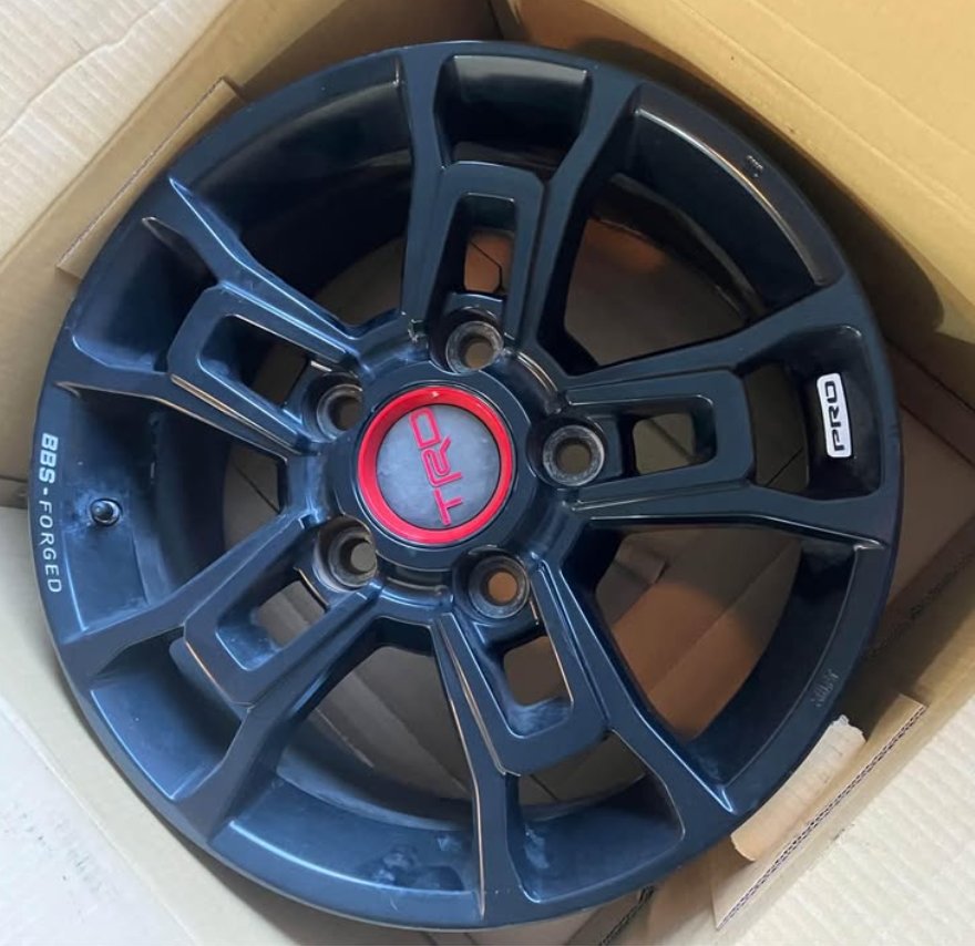

    Bought a set of '21 TRD Pro wheels off FB marketplace. There are plenty of places around me that do powder coating but only one I could find that advertises wet paint. Got a quote for $700 from a reputable powder coat shop with plenty of reviews, compared to $1400 for paint. Having read mixed stuff online about powder coating forged wheels and compromising the wheels integrity from the additional heat cycle, curious if anyone on here has done it with no ill effects? The powder coater I talked to said he knows BBS says not to powder coat their wheels, but he's done thousands of wheels, a lot of which are Porsche BBS forged wheels for a local clubs track cars and has never had an issue. Any input is greatly appreciated!

    They're in good shape, reason for painting is color change from black to bronze, a la land cruiser heritage edition. I have an SR5 with chrome, got an army green front and rear bumper from a pro, just ordered the TRD pro grille surround/bulge in army green, and last piece of the puzzle is doing these wheels in bronze.
