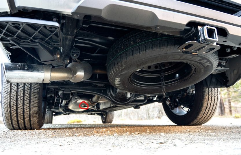

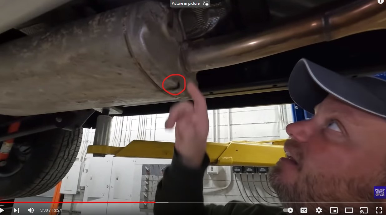

    This is 100% condensation from either the front or the rear condensation drain holes in the muffler. My truck makes an equally large puddle every morning during the 10 minute warm up cycle in winter.
    If it doesn't smell like gas, then it's not gas. It wouldn't be ATF because the transmission would have to go back another 4' from where that pic is taken.
    Edit: Added Pics.
    Here is the rear drain hole location:
    Here is the front drain hole location (credit to @testerdahl for the video - I had to snag a screenshot from his vid for the front drain hole)

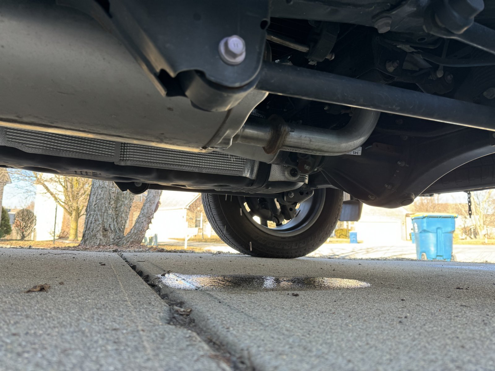

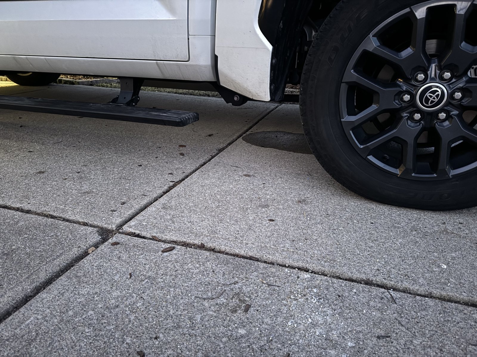

    Confirmed it doesn't smell like gas. Took a look under after letting it run for four minutes.
    I'm surprised at the volume of liquid but it's right out of the drain hole.
