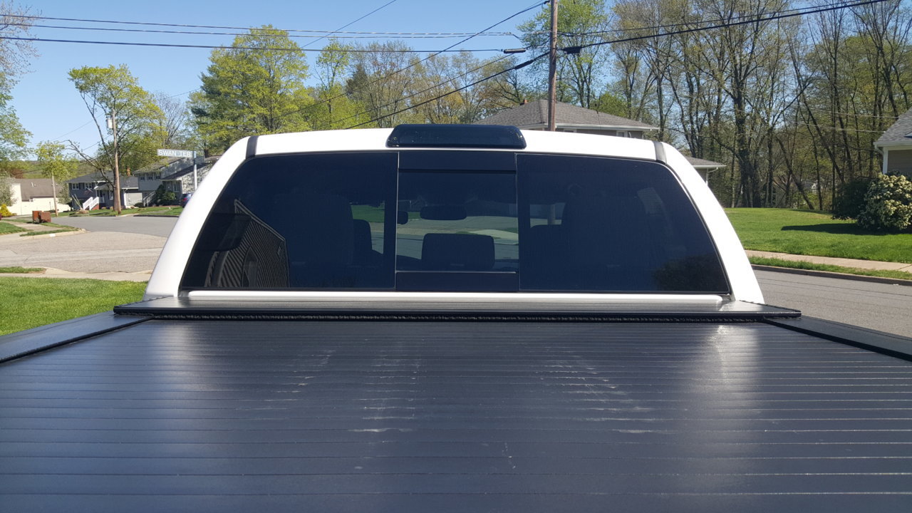

    Good morning my fellow Tundra junkies. I'm looking to install a rack in the post stakes only if possible. I have a sliding cover which keeps me from installing any types of mounts within the bed. Any help is greatly appreciated. Id like something with a streamline look. thx all for your help.

    I can't tell if your sliding cover goes over the front stake pocket holes from your picture. If they don't these look like a good option. You simply put them in the stake pockets and then bolt them in place from the inside of the bed. There's already a pre-drilled hole for the bolt. That would allow you to bolt the legs of a rack to them (vs clamping them to the rail of the bed. You would still need to modify the bottom of the legs to work with these but it looks like it would be pretty easy depending on which brand you buy.

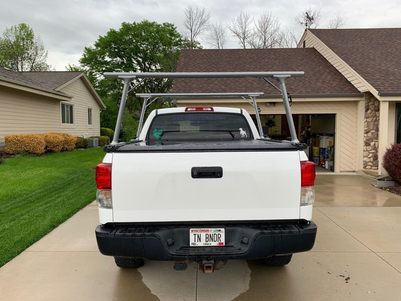

    I just installed a Thule Track Rack. It works with my roll up tonneau cover and the racks easily slide off when I don't need them.
    I think Thule makes one that just uses the stake pockets but they are low, which wouldn't work with my cover. And I wanted them higher for a rooftop tent eventually.

    Can you share a picture of this setup?
