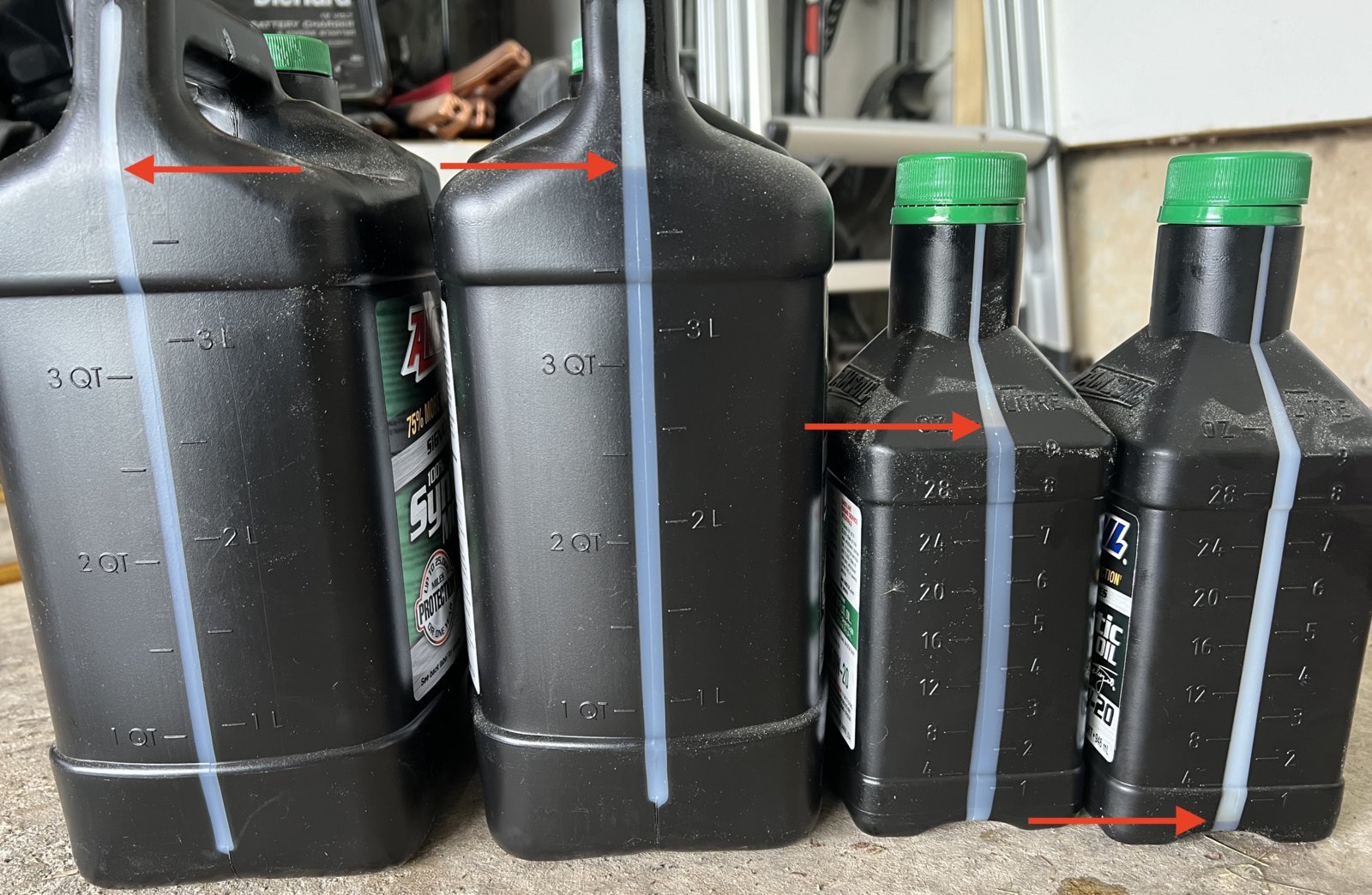

    Well, the first surprise came when I discovered that over 9 quarts of oil had drained:

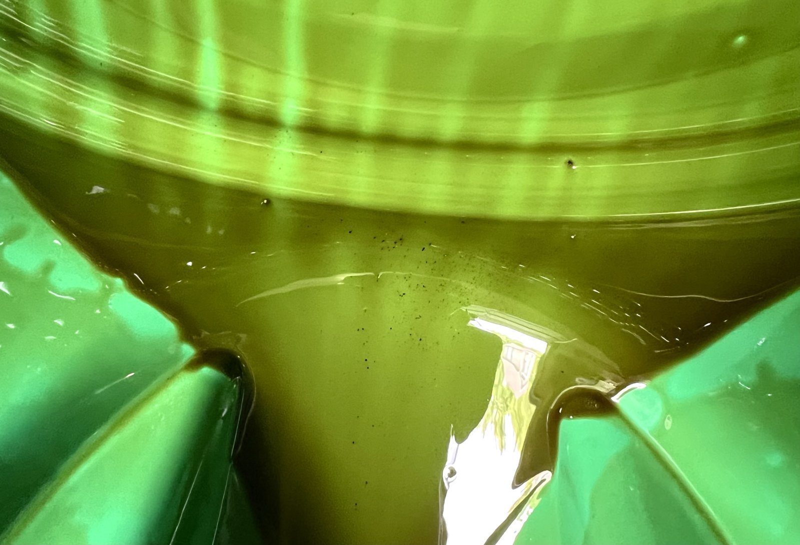

    And this is what was left in the drain pan. Not sure if this is "normal" or not:
    The 9+ quarts is what really bothers me. I've done 100+ oil changes over the last 30 years and never have I seen more oil come out than what I put in. It didn't smell or look any different than what I expected. But just to be 100% sure before I accuse my dealer of wrongdoing, I'll be sending in a sample to Blackstone for analysis to rule out any type of contamination or dilution. Wear metal levels will be interesting to see as well of course.

    Reason #73 why I do my own maintenance.
    These motors take over 9 quarts completely dry but a drain and fill only calls for 7.7 quarts. Some genius filled her up good
