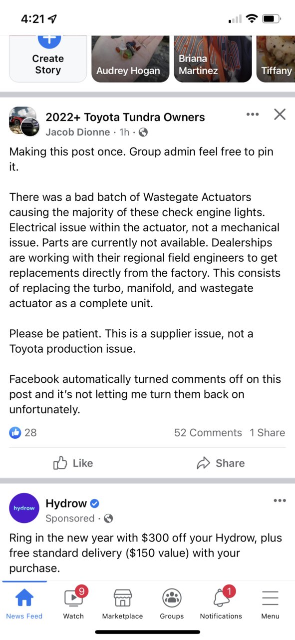

    Just found this on Facebook. If this has been posted already I apologize.

    He said it’s an electrical issue inside the actuator, but then goes on to say that the wastegate actuator, turbo, and manifold will all be replaced as one unit. Not sure how crazy of a fix that is on these new engines. I imagine the biggest issue will be just getting the parts and not the job itself.
    Who knows how many trucks with that check engine light have this issue. He says he is a Toyota master check so I assume he has a bit more knowledge about it. Figured I’d post it here in case others have more to add!

    Manifold meaning exhaust manifold? Damn.

    Don’t they have integrated exhaust manifolds ?

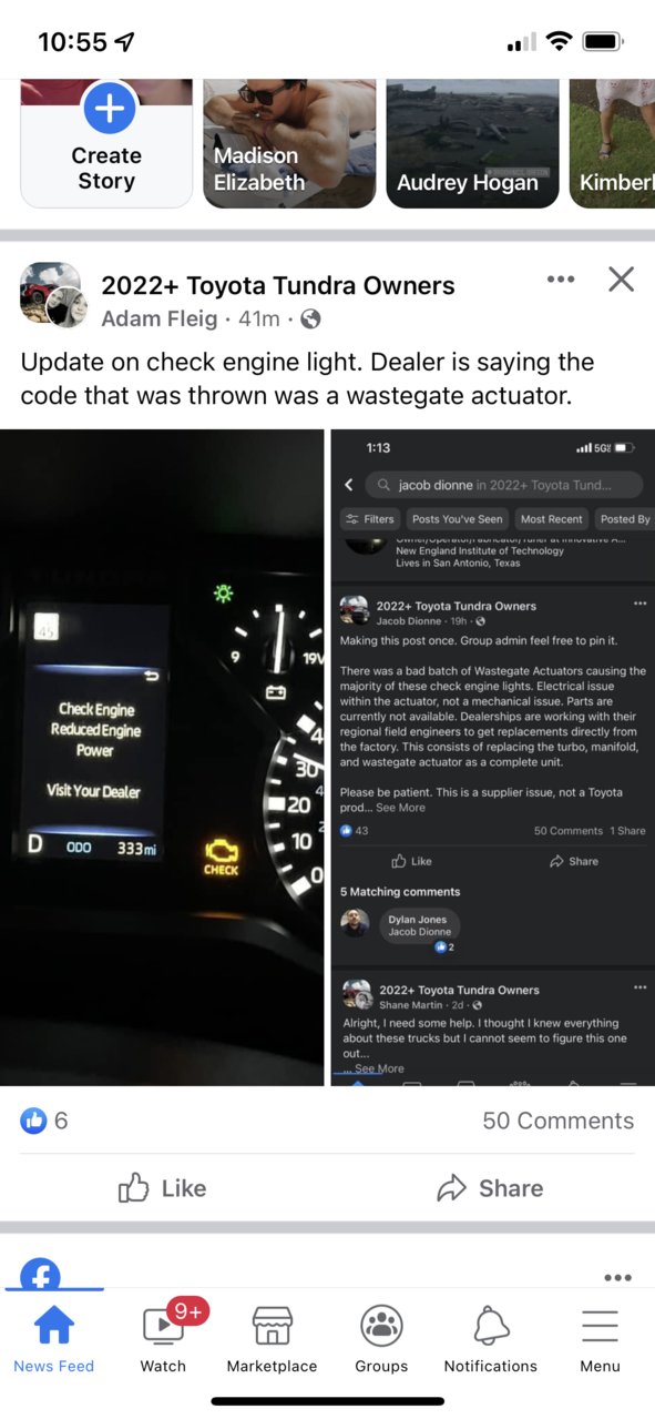

    I wonder what the code is? Wastegate stuck open/closed? Either way, power will be reduced because of lack of boost or to avoid an overboost condition.

    I would imagine something vague. Reduced engine power or something like that. Who knows what it would show when the code(s) are pulled.
    If this ends up being more than just a few rigs I’m sure we will hear about it. For now it was just a post on the FB Tundra group. Just had been seeing a few check engine lights pop up here and there on that group and figured I’d post it here. Maybe someone will see it who is more in the know and give more detail.

    I’m really curious to find out what’s going on. Since it’s wastegate, there should be a P code DTC associated with that check engine light. I guess typical Tundra owners don’t own code readers…

    Unless it is a faulty part from the factory which is what is being said.....I see check engine lights popping up on new tundras almost every day since they released them...so it is probably not far fetched that there is a bad part issue. Not to mention the number of holds on trucks from the distributors. Just yesterday I saw a QC hold on 1794's in some SET region trucks

    Again, same Fb group, but someone is saying their check engine light is due to the wastegate actuator. Take it for what it’s worth. Not sure why multiple people would lie about this, but people can be weird.

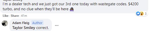

    Its a thing....and the parts to fix it are not available...the payments keep rolling as your truck sits. Until Toyota can narrow down the batch of parts, it will be a crapshoot whether you are buying one with an issue or not.
    With the number of these that are popping up and the rate that they are popping up at, it might be a full couple of weeks or more of production with the bad parts. Since it was first mentioned I have seen a lot of them....and that is only the people on social media...there are many more out there that are not on social media.
    I did see one tech that said they have 3 of them sitting on their lot so far that are waiting for parts for the issue that they don't know when they will be able to fix.

    Yeah, just found and added a screenshot of the guy claiming they have 3 with this exact issue at his dealership. I guess we will see how widespread this is over the next few weeks. I'll still be getting a new Tundra FYI. Fortunately, I want a bare bones SR5 or Limited (not sure which yet) so I will be waiting a long long time before one of those hits a lot.

    This wastegate actuator problem is real. My truck started having the same issues last night so I brought it into the dealership this morning. The dealer said the same thing as the posts above and kept my truck until they can fix it. My truck has only 1,159 miles on it lol
