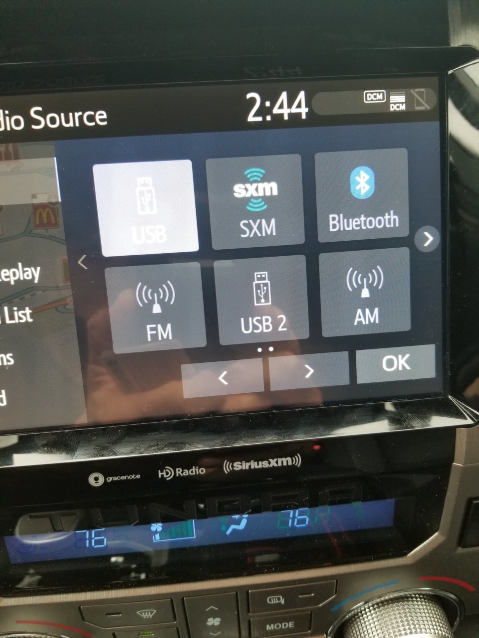

    Can anyone tell me what/where USB2 is?

    No. The only one marked that way is on dash board. I thought it might be behind the Radio unit. I have the same thing with my Ford.

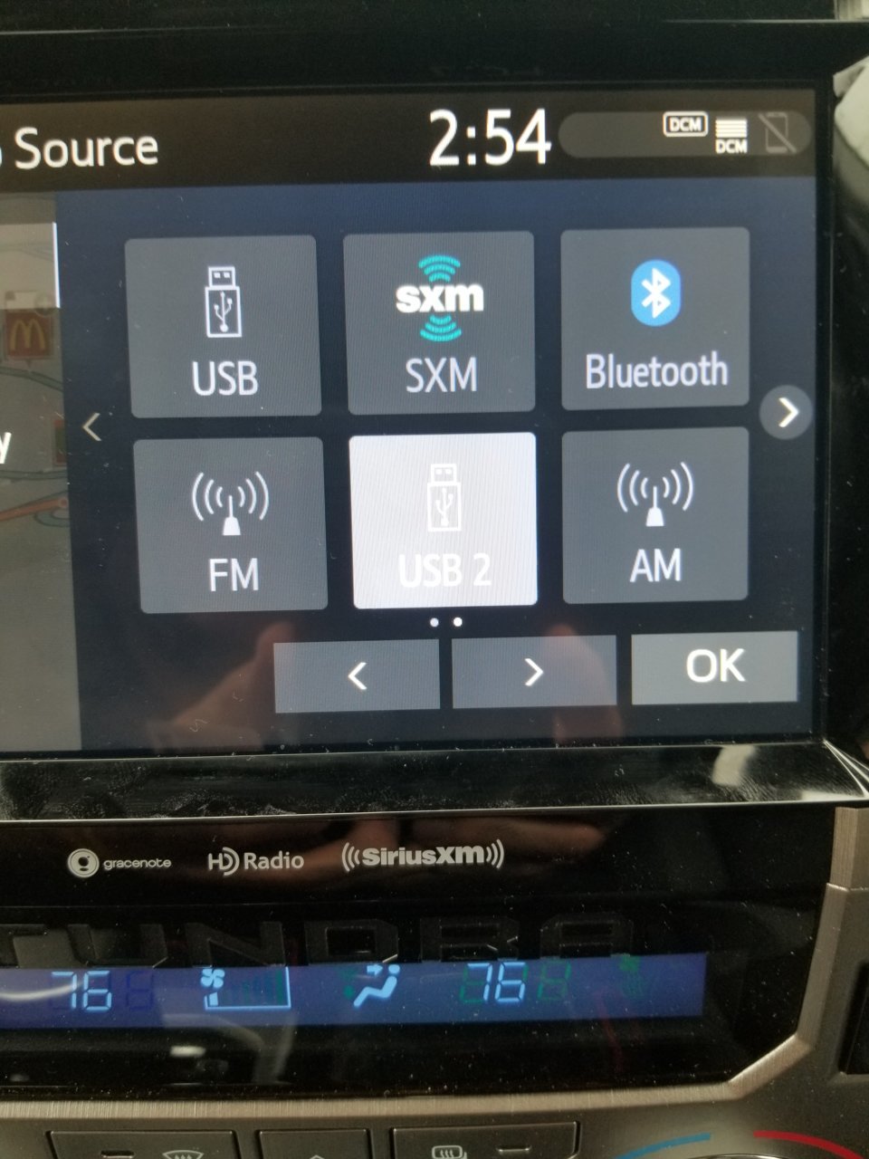

    The USB2 only shows up on mine when I hit the "reorder" prompt. Maybe look in this section for a picture of the backside of the HU. Maybe there is another connection back there.

    Are you using a hub? This is from page 122 of the Navigation and System Owners Manual.
    If a USB hub is plugged-in, two
    devices can be connected at a
    time.
    ●Even if a USB hub is used to connect
    more than two USB devices,
    only the first two connected
    devices will be recognized.
    ●If a USB hub that has more than
    two ports is connected to the USB
    port, devices connected to the
    USB hub may not charge or be
    inoperable, as the supply of current
    may be insufficient
    I haven't tried it but I'm going to.

    Do you have an android phone plugged in? One with an external memory card? I know in the past I’ve seen (not on a Toyota head unit) the external memory card on an android device show as a second device in the head unit.
    otherwise my bet is that it is related to what @MT Madman posted from the user manual

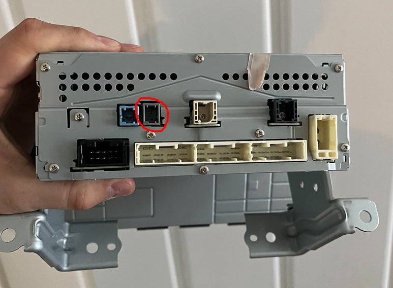

    I know Tundra234 already stated this, but since I just replaced my 2021 head unit and it's sitting on my table I can confirm that there are no additional empty usb ports on the back of the head unit. If memory serves me correct from installing, I believe USB data enters via the grey circled female slot.

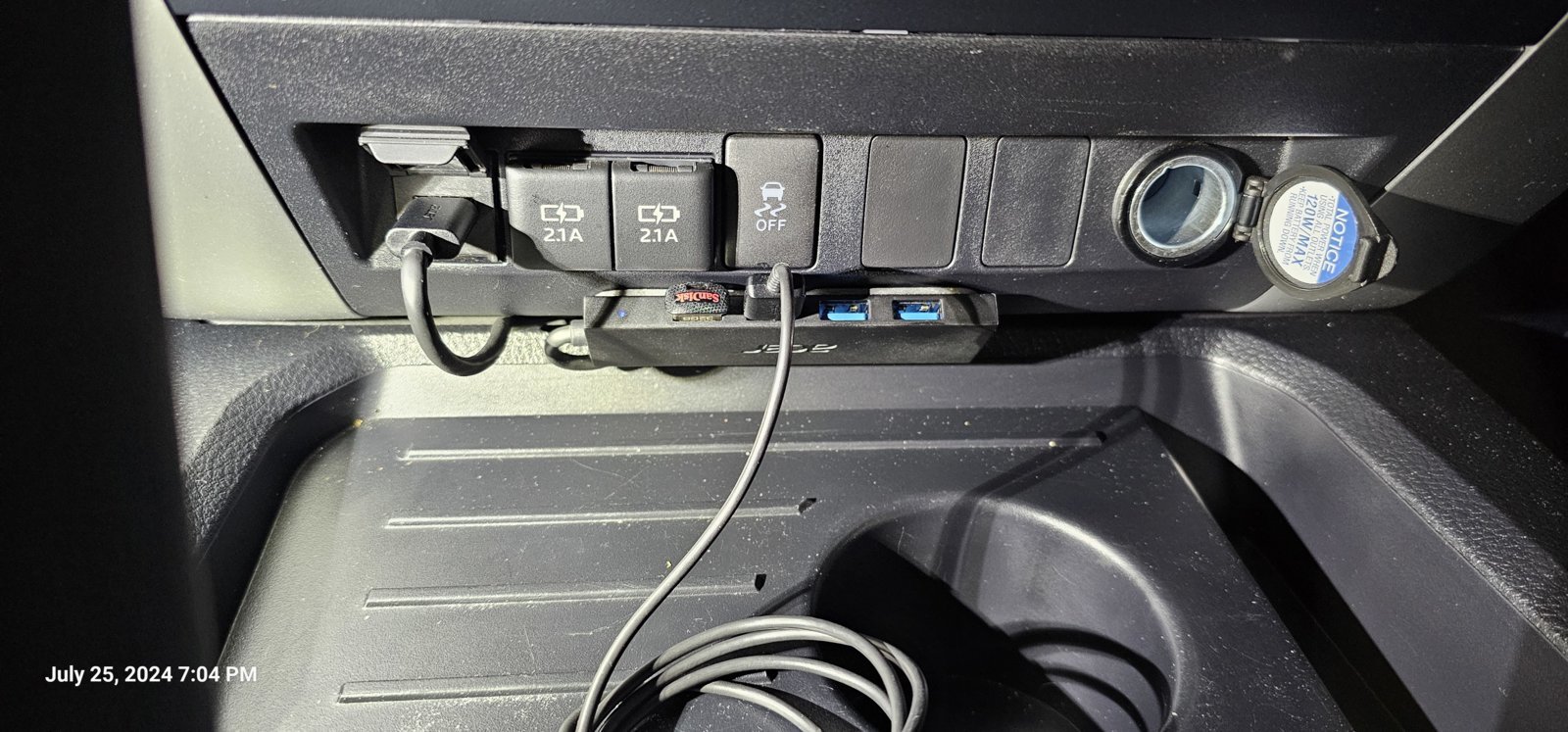

    I borrowed a USB hub from a buddy to give it a try and it ultimately works. I plugged my flash drive into one port and it plays, but as soon as you plug in your phone the android auto takes over. At that point it doesn't even recognize your flash drive is plugged in. Not ideal, but for my purposes it will suffice. I won't have to switch plugs constantly. Once you unplug your phone then it will recognize your flash drive again and play.
    Keep in mind I used a USB hub, not a USB splitter. I don't believe it'll work with a splitter and most splitters specifically say they don't support Android auto. Hubs don't specifically say they do, but they tend to have more brains behind them to allow usage of more sophisticated devices. I'll order a cheap hub from Amazon, recheck it, then post whether or not it worked and provide the link.

    Alright, so this is the one I got and it works exactly as I described earlier:
    Acer USB Hub, 4 Ports Multiple USB 3.0 Hub: https://www.amazon.com/dp/B0CPSSD43L
    Paid a smidge more for it because I wanted the shorter cable, but it was like $13 so not bad. It's pretty small and I just mounted it with 3M adhesive. We'll see how well out holds up.

    Nice looks slick and hardly noticeable tucked under the other slots!
