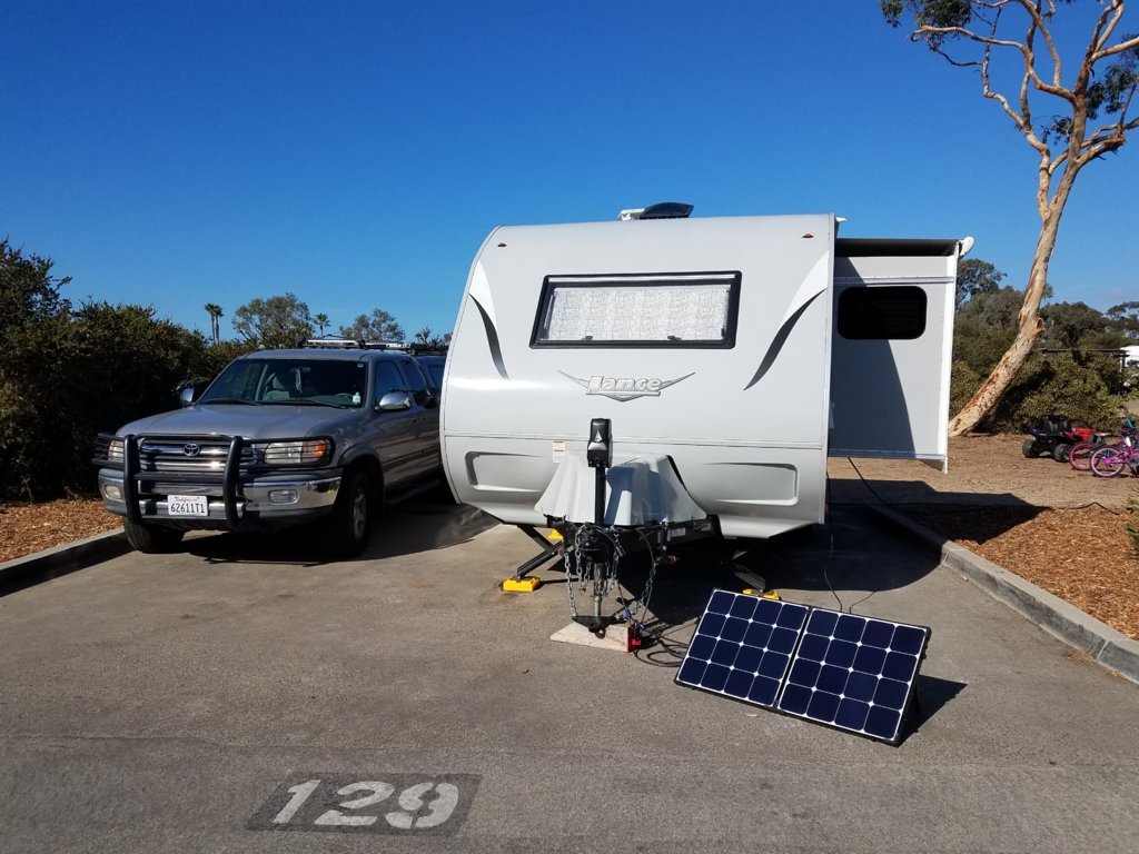

    I use renogy panels and riveted hinges so its a big breefcase of 200w of solar (for trailer camping).. Fits back in the box it came in also. Its heavy and a little cumbersome though....we use 4-6 panels total when dry camping.
    You might want to go wtih the foldable setups that are much lighter but much more expensive.

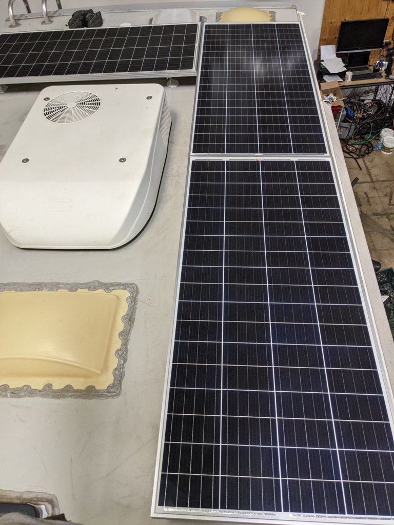

    So now I have 600W on the roof of the trailer feeding 2 LiFePo4 100Ah Lithiums, and the 60-70 Ah's we typically consume overnight is replaced by noon. The panels are just up there doin' their thing.
