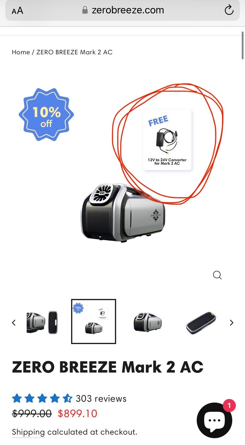

    Ok so this has been something I've been pondering about for awhile. Been looking into portable A/C unit for the truck for overnight fishing/camping expeditions and I'm trying to figure out the power source. IMG_4718.jpg
    Was thinking about this unit. Ignore the circle around the "12v to 24v adapter"
    But I ran it by @bmf4069 and through our conversation figuring out power out put/hours was getting kinda confusing.
    my basic plan to just have it run over night for about 6-8hours.
    Would a YellowTop Optima/inverter be sufficient? Or should I look into some sort of small camping generator? Maybe use a secondary battery as a charging source for the camping generator?
    Somebody who's smarter than me please chime in

    Yeah, I've been looking at the Optima D27f battery. It shows a reserve capacity @25A of 140 minutes, so I'm guessing it can run for about 2.5 hours before it drops to 10.5 volts. This thing pulls 240w so 20A @ 12v.

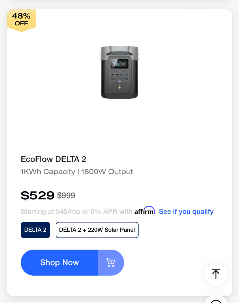

    100% you would need a lithium battery to get through the night. Lead acid/agm batteries realistically get about half of their capacity rating.
    If you look at the ecoflow wave it will show you some ideas of time with different battery capacities.
    https://us.ecoflow.com/products/wave-2-portable-air-conditioner
    It shows that with a delta 2 it gets 7 hours of run time. I believe the delta 2 has 1kwh of capacity.
    If you are looking for an all in 1 solution for the power, the delta 2 is on sale for $500 on Amazon and they are running their Prime Days sales right now

    Yea, I'm not gonna try and run anything off the cranking battery if at all possible. But I'm trying to figure out efficient options
    so far, the best possible option seems to be just getting ecoflow delta.

    You could go with a wave2 (cheaper on Amazon than what was in your post) and a delta 2 and call it a day.
    Ecoflow (direct) is having their sale this month, its usually the same price on amazon.
    https://www.reddit.com/r/Ecoflow_co...coflow_prime_day_sale_reddit_only_7_off_code/
    I would keep an eye on slickdeals...for a little bit of time the delta 2 was $429 on Wednesday.

    The EcoFlow Delta 2 is only rated at 1024 watt-hours of a capacity and suggested 80% max discharge. So 819 watts, or 3.4 hours or usage. (again, assuming 100% duty cycle). If the AC unit has an Eco mode, it usually doubles the run time by halving the duty cycle.
