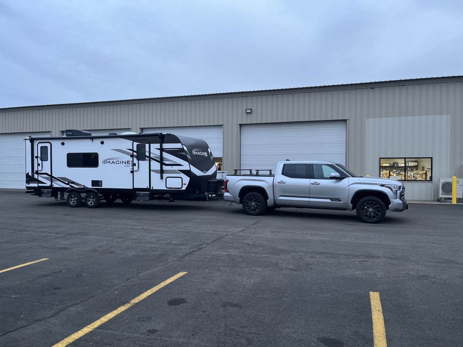

    Hey all,
    I just picked up a new GD Imagine XLS 23LDE and, while the Tundra pulled it just fine, we experienced a couple of issues.
    First, there was a good amount of porpoising on the drive home. Now, this trailer is a rear kitchen model and it was bone dry/empty with the exception of two full 20lb propane tanks and two batteries on the a-frame. However, I would’ve thought that’d have been enough tongue weight to balance it out well.
    I haven’t measured the actual tongue weight but do know that the specs on this trailer from the factory are 524lbs TW and 5,598 dry weight which is a bit of an imbalance. But, again, figured the propane tanks and batteries would’ve gotten me to about a 10% TW ratio.
    This being said, question for the more experienced towers out there: Is there something else that could be causing this porpoising, or is it most likely lack of TW?
    Second, right at the end of our trip, when coming to a stop at a light, I noticed a bit of low speed brake judder. Wasn’t there when we first hooked it up and made a few stops heading to the freeway.
    Is this possibly due to the trailer brake controller not being set to the proper gain? I had it at 7.5 which, from previous research, I thought would be good. Did totally fine on the freeway when braking at speed. Problem only reared its face when coming to a stop.
    Appreciate any insights/advice on these matters!

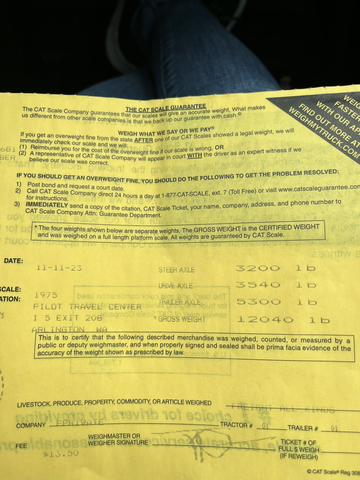

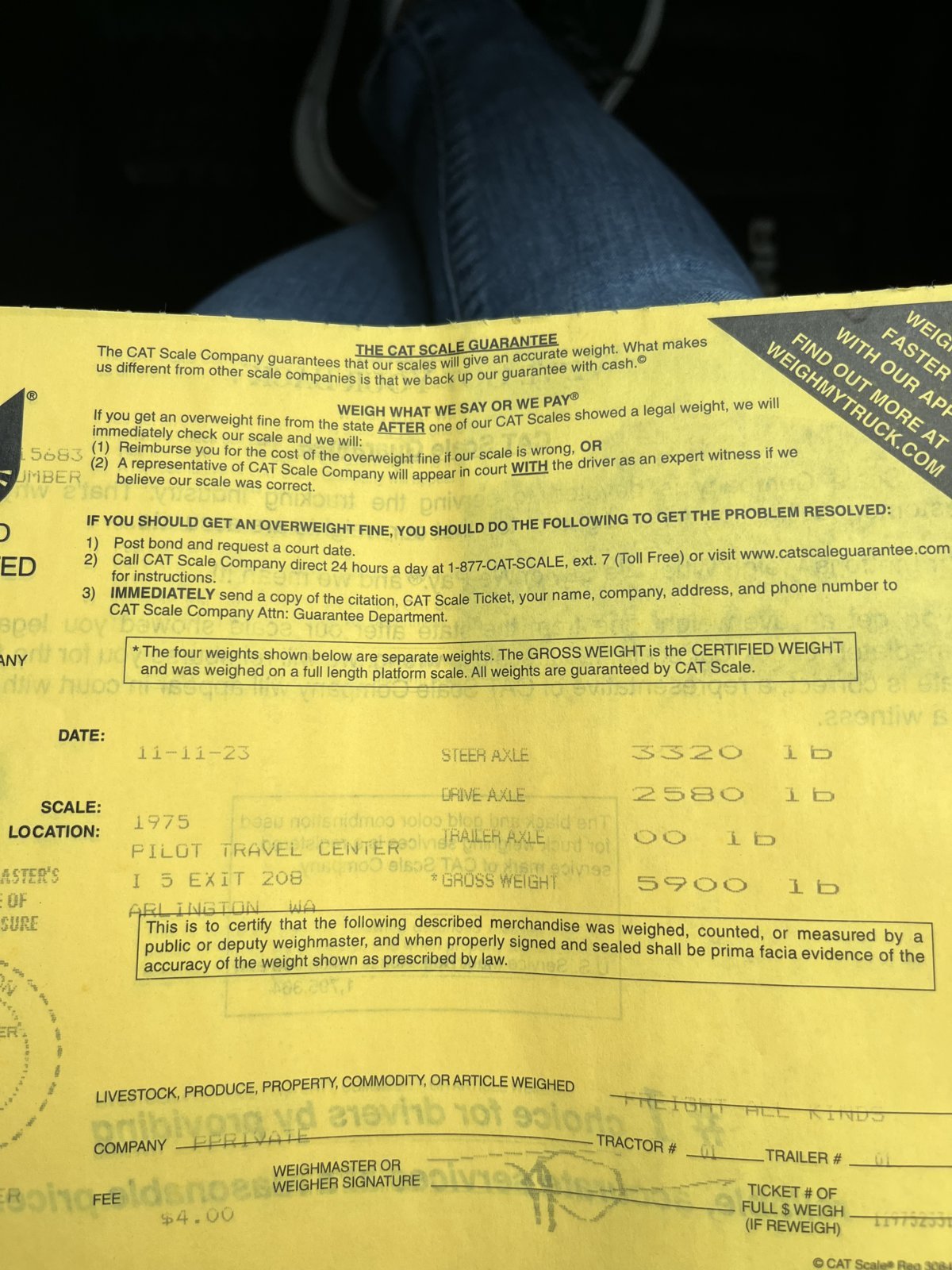

    Alright… I ran by a CAT scale today and did a quick weigh with the WDH engaged and one with the trailer disconnected.
    First of all, I decided to try dropping one link lower on the WDH chains to put a little more weight on the tongue and the truck drove way better… No porpoising really. So that’s great!
    As for the weights, the difference between the first measurement and second showed about 840lbs on the truck. Noting that my wife was sitting in the truck for the first measurement but not the second and she weighs about 120lbs soaking wet so we’ll call it 720lbs. Then take another 80ish lbs off for the WDH and my TW is probably just about 640lbs with my WDH set where it is.
    Again, truck drove great so I may just leave it where it is.
