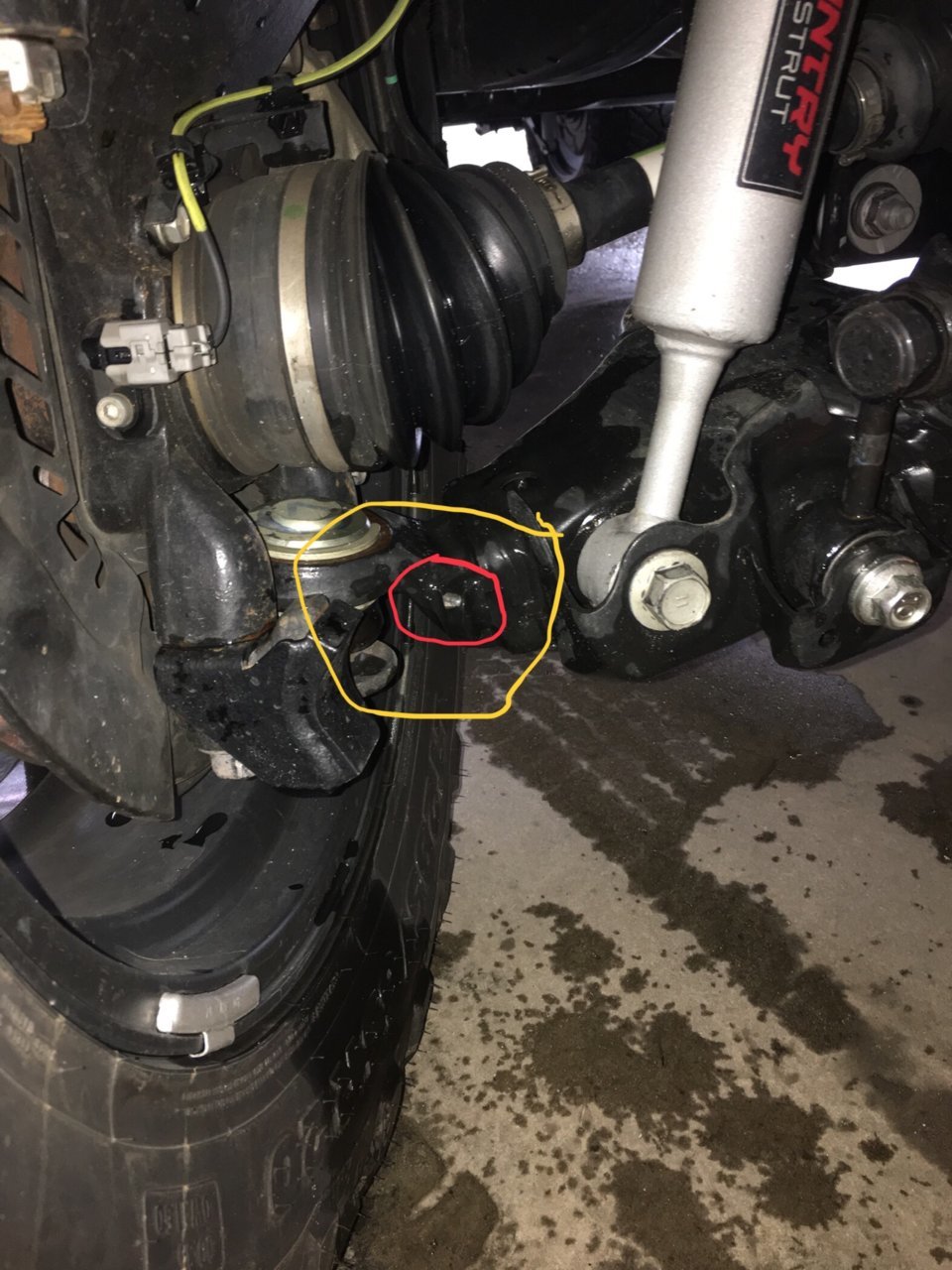

    Ok shop has to cut the nibble off the bump stop on A arm. 47CA7028-5E2A-4B66-B925-29EC174F15CD.jpg

    Off of that steering stop ? Or ? Not seeing what they are going to cut.

    If you can zoom in the clear coat is wore off. It’s the steering stop.

    In the middle of the red circle this is before the cut some of it off C9DC3BF7-0C7F-4247-BCE6-3D3E161B1E19.jpg
