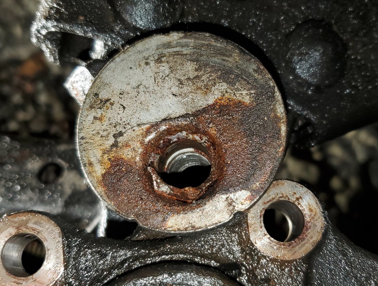

    My alignment cam sleeves rusted through, and I couldn't get an alignment. I drove for 16,000 miles like that. I think? Memory fuzzy.
