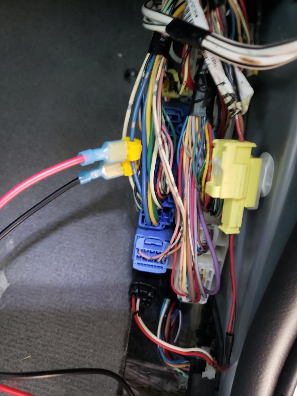

    I know it took me a minute or two to dig through the harness' and find the correct wires. Maybe this will help you identify the wires. 2011, CM SR5 btw.
    PhotoNerd and texasrho83 like this.

    Different year models have diff colored wires. From my 16 to my buddy's 15 the colors we tapped into were different.

    That adds a bit of confusion. We're all working with the passenger side.
    MikeBeach likes this.

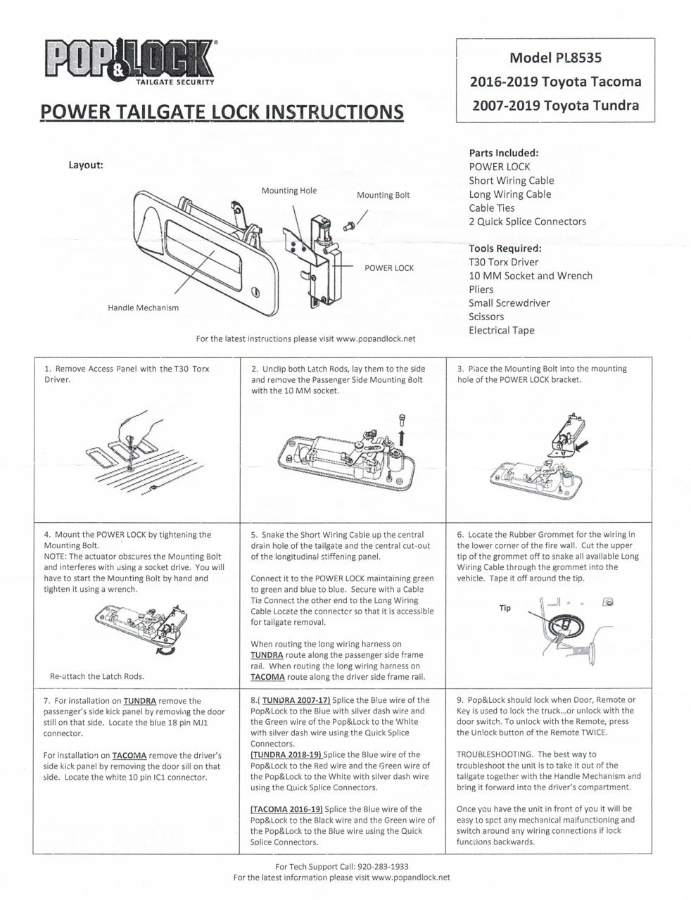

    Thanks for all the help on this topic. I tend to forget that I can access this forum when I get stuck. I'm working on this mod for my 2010 crew max platinum, and I don't have any wires with silver dashes. I have a solid white and a solid blue. I will try using them tomorrow and post my results.

    I just got this email from the Pop&Lock folks. Got to admit they were very quick with the reply. I got to respect excellent customer service. This is a PDF of the instructions they sent me. It confirms my last post about the solid blue and white wires. For reference, I'm working on a 2010 Tundra Crewmax. I hope this helps someone as much as this forum has helped me.
