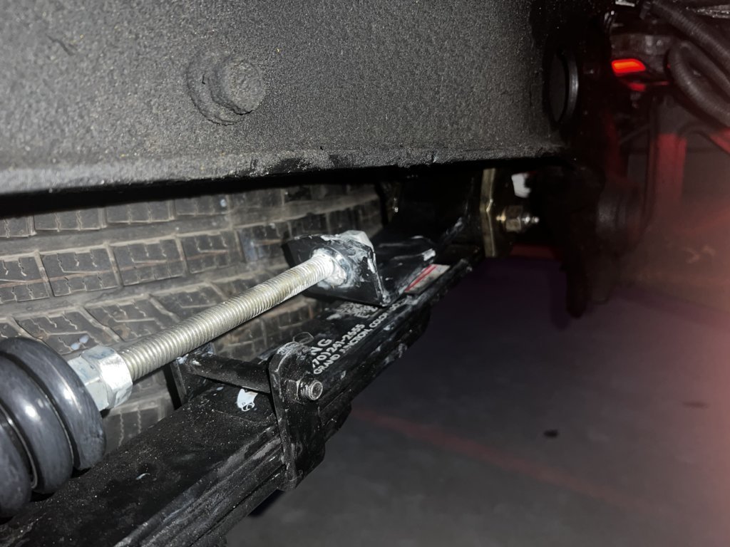

    Anyone else notice a pop on their RAS when they first get going in the morning? I just installed mine a few days ago and it gives a decent sounding pop on each side when I first start pulling out of my driveway. The rest of the day not a peep until the next morning. Just curious if anyone else has experienced this or maybe it’s just the fact that the springs need to settle a bit. Thanks.

    I have Alcan springs as well. I wonder if it’s just catching this bracket too.

  7. Aug 7, 2025 at 8:15 AM

    There’s just a tiny gap. Hard to tell from this angle but it’s not actually contacting the bracket. Could definitely still catch it though I’m sure. I wonder if I should up the tension to create a bigger gap here.

    Those move so the small gap can likely be contact when slight anomalies occur on the road...

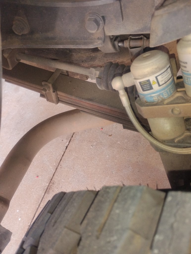

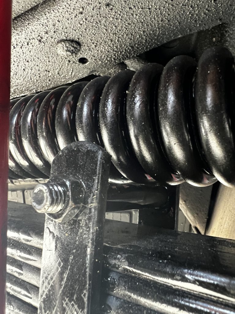

    So can’t move the leaf spring clamp unfortunately. I did take the tires off and at full droop my white gap checker thingy (technical term) didn’t fit through the RAS spring anymore so I opened the springs up a bit more to fit it. This seems to have widened the gap between the RAS springs and the leaf spring bracket. . I also removed the sway bar just to see if there was any tension on it and there wasn’t. Going to put some paint on there and take it for a spin in a bit. Tomorrow morning will be the real test since that’s when the noise really hits hard.

    I had to bend my Dobinson's leaf spring clamps over a little for clearance when I put in my RAS HD, it added maybe 15 minutes of install time per side once I figured it out but I've had zero issues since then. I literally bent them over a bit since mine were also fixed in place at the bottom. Thousands of miles of towing and tens of thousands of total miles later and they're still flawless.
    Maybe you can just knock them over a bit with a scrap piece of 2x4 and a small sledge.:)

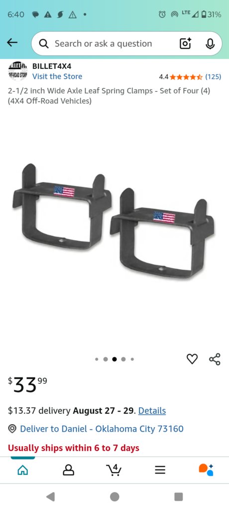

    I did see those. Was thinking I would sub out the one bracket for one of these. Much lower profile.

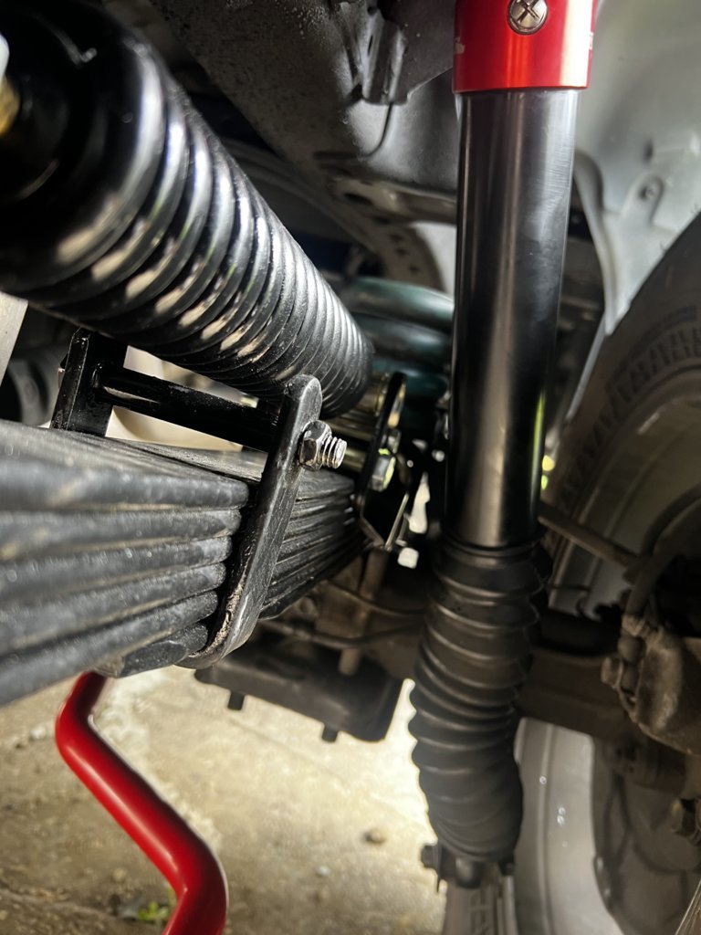

    Here’s a photo of the threaded rod. Looks like the top of it is pushed up against the opening which makes me think that’s the part that’s binding up. Not sure though if others look like that or not. Hard to tell with all the grease I jammed up in there the other night.
