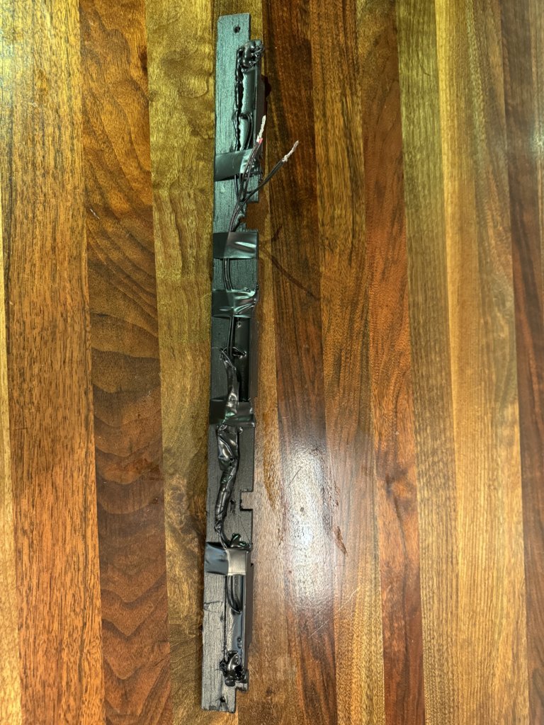

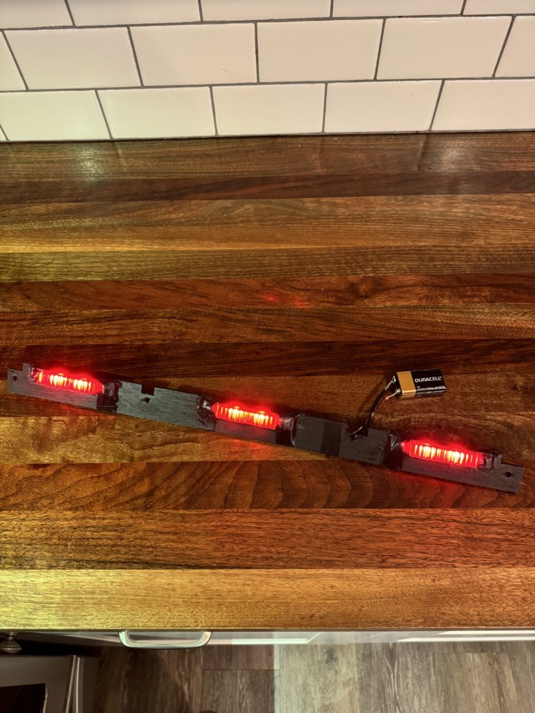

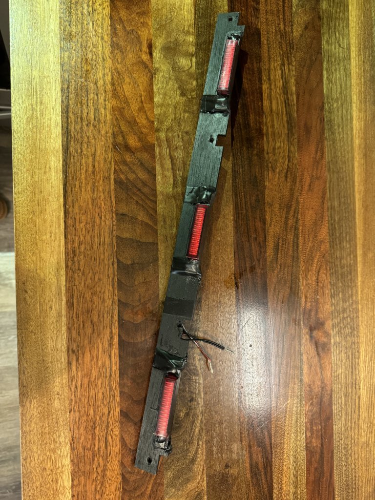

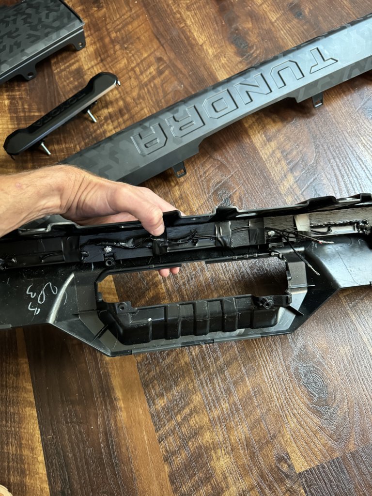

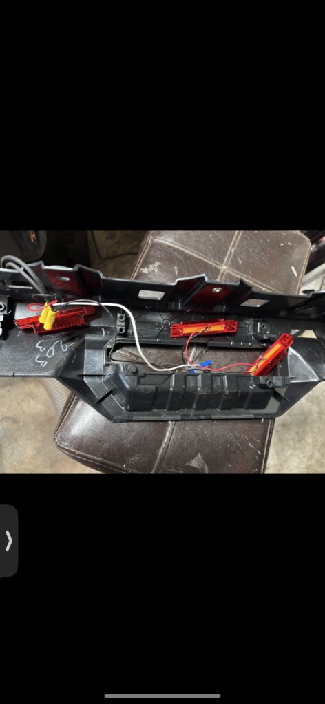

    Even with the Labor Day sales, I wasn't about to spend that much money on the tailgate spoiler and lights combo, and Rave isn't much cheaper (and they seem to be a polarizing website). I'm not an electrician or work in fab. I am a woodworker, however, so I played to my strengths with plywood (still rigid enough and won't move too much with the weather compared to wood). Just to double down on waterproofing, I coated everything in 5 coats of plasti dip.
    If I have time and there's interest, I'll post picture of the truck install and finished product.

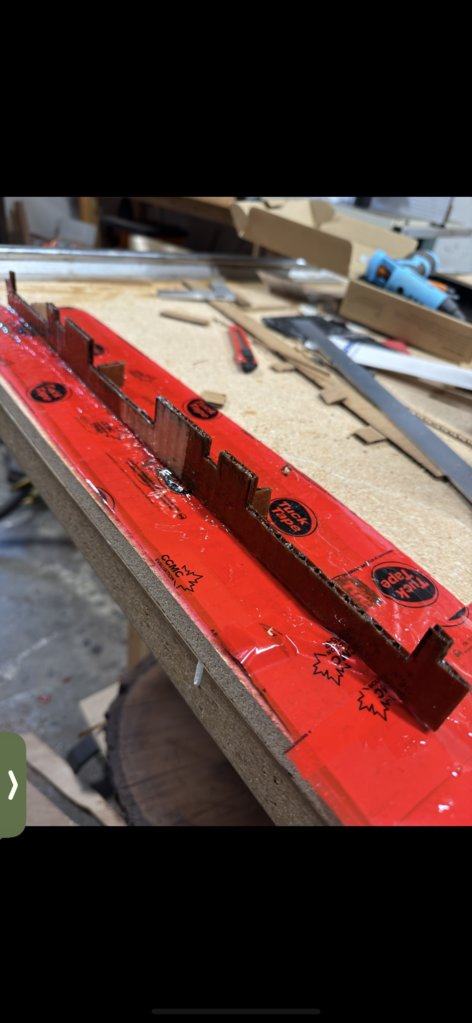

    Cardboard (free - from the box the spoiler came in). I used it as a mockup, soaked in epoxy in case I screwed up and needed to make another bracket.
    Had scrap plywood but could get that size for between $10-$15.
    Lights were $8.19 each.
    Amazon.com: Blazer International C535R LED Rectangular Clearance/Side Marker Light, Red : Automotive
    Tailgate Spoiler was an ebay snag for 350...seems he's got a few there still: 2022 - 24 TOYOTA TUNDRA TRD Pro Rear Tail Gate Spoiler Cap Cover 76085-0C060 | eBay
    RatPanda and rjloper9 like this.

    Sorry, the pictures are all out of order. I'll add that the most challenging part was making sure the spaces holding the lights were snug enough to allow me to position the lights in a way that looked good on the outside. Once they were positioned, I used CA glue. Also, if you're wondering about the white wire, consider it red(hot) because I ran out of red wire.

    Oh, and the electrical tape was used to hold down the wires because I didn't want to use loom or anything thick.

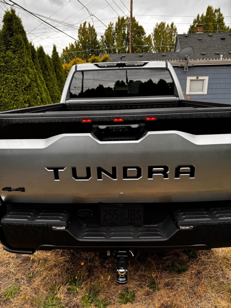

    It ended up being very easy...with Rave's harness slightly modified to work with my DIY lighting.
