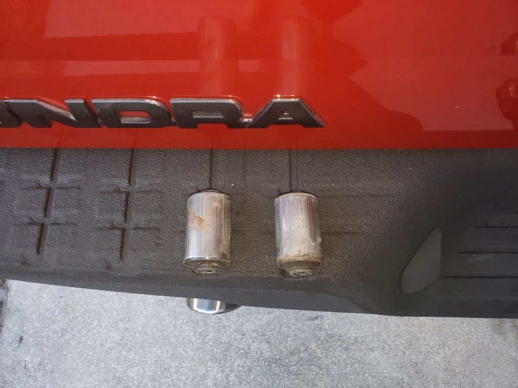

    these things def aren't going in, do you have to remove that metal sleeve?

    Your removed bushings should look like this.

    Others are right, you may have just removed the old bushing that separated from the outer metal sleeve. Happens to a lot of folks - you can sawzall the sleeve out if needed.

    yupp sawzall them bitches out, all good thanks guys.

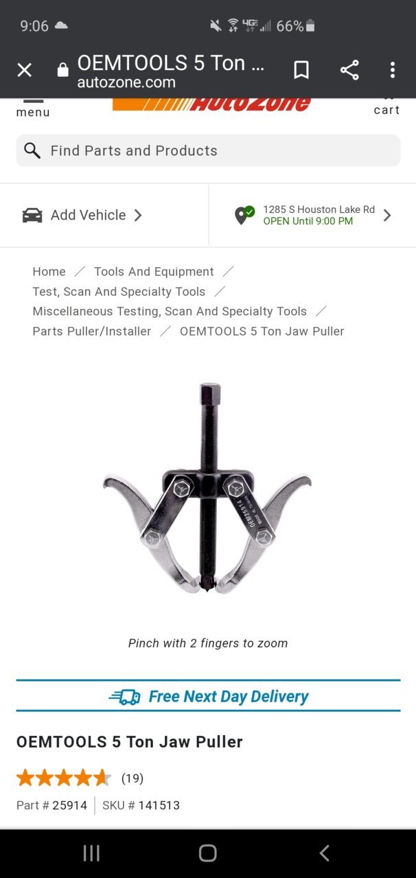

    I used this with a 28mm socket....worked in about one minute after taking an hour with the ball joint press
    glowblue likes this.
