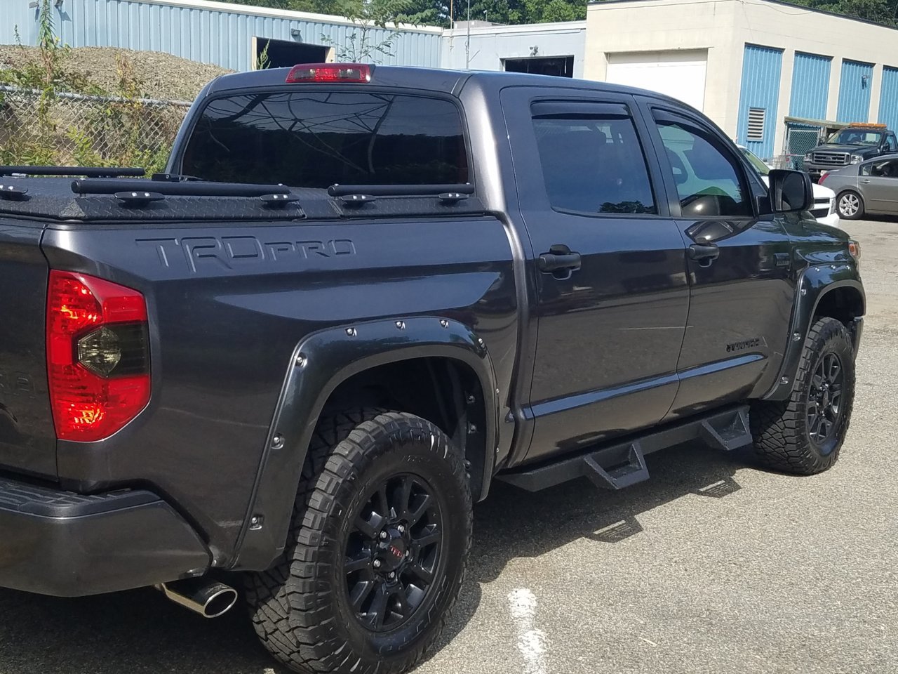

    So here's my truck
    I plan to make the dual exhaust black. Do they make a high temp bed liner type coating that looks like linex to match my side steps and bed cover that I can paint my exhaust tips with? Any help is appreciated.
    If u don't know the answer to the above question that's fine, u can still vote below. I'm looking for votes on whether I should leave it alone as is, paint the rivets black on fender flares and or bed cover?
    So u can vote
    -to leave it alone
    -Paint the flares rivets black
    -Paint the flares and bed cover rivets black
    Pls share your vote and if u have any suggestion on how to do it, ie brush, tape off and spray, ect. What products to use, ect..
    Tnx in advance for voting and any info or best practices u can provide.

    Leave it alone bro..you got the chrome tips, chrome rivets, and some chrome accent on the diamondback...Not crazy chrome just enough to balance everything out..Chrome lives matter

    leave it alone....over done = overdone, accents are fine. Fix the big scratch on the middle of your doors...:rofl: just kidding, but pic displays what looks to be a big fat one.:rofl:
    Still a few purist out here :thumbsup:

    No big scratch, just a reflection in pic. Like u said, if it was I'd be more concerned with that over painting tiny bit of chrome.

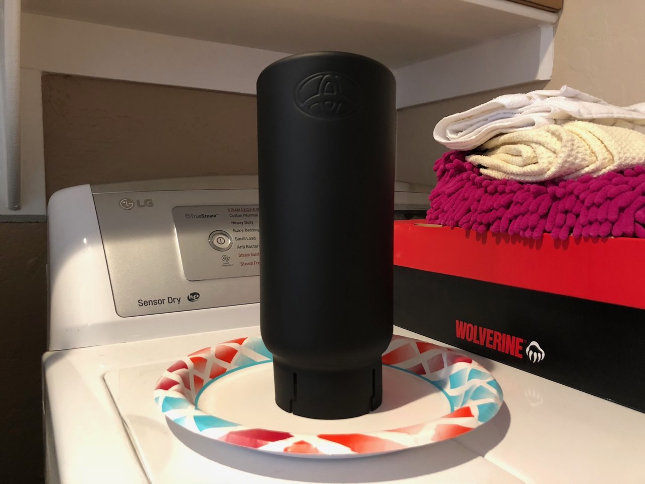

    Go for it with the exhaust tips, mine looks great. Ground chrome off, self etching primer, and epoxy coat(paint).

    I do like it, does look great. Happen to have a pic of them installed?

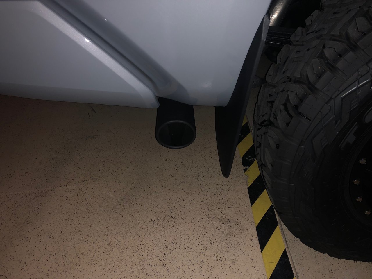

    I only have one, no duals for me. Don’t have a good pic, took this real quick.

    Looks great. Tnx for pic. Based on just looks got me leaning toward doing myself. Then I'd have to see how hard to make happen on my setup.

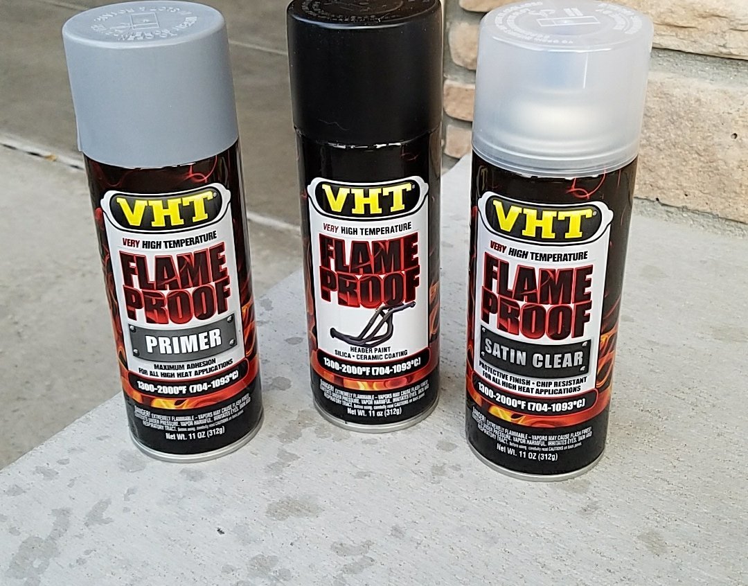

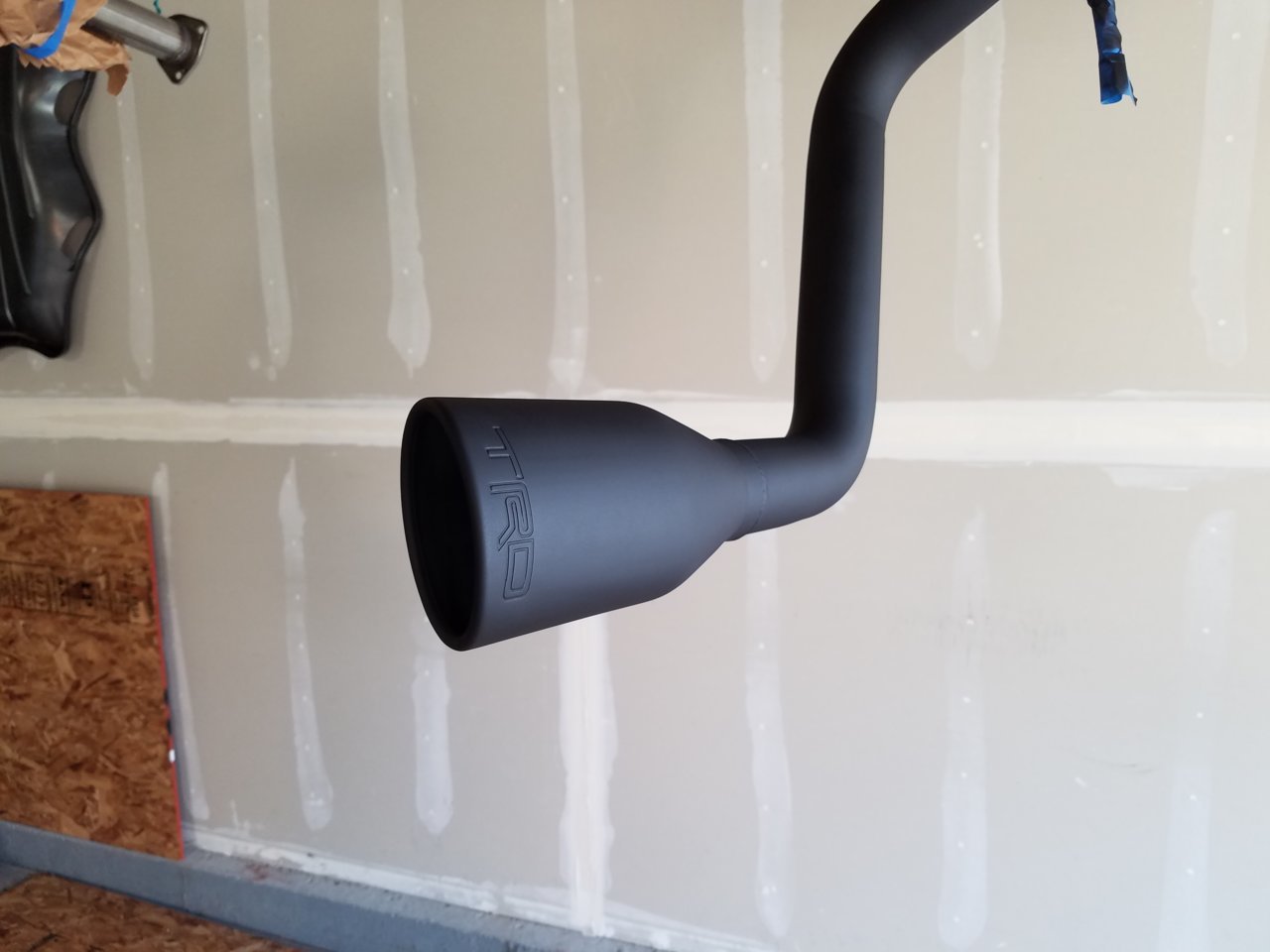

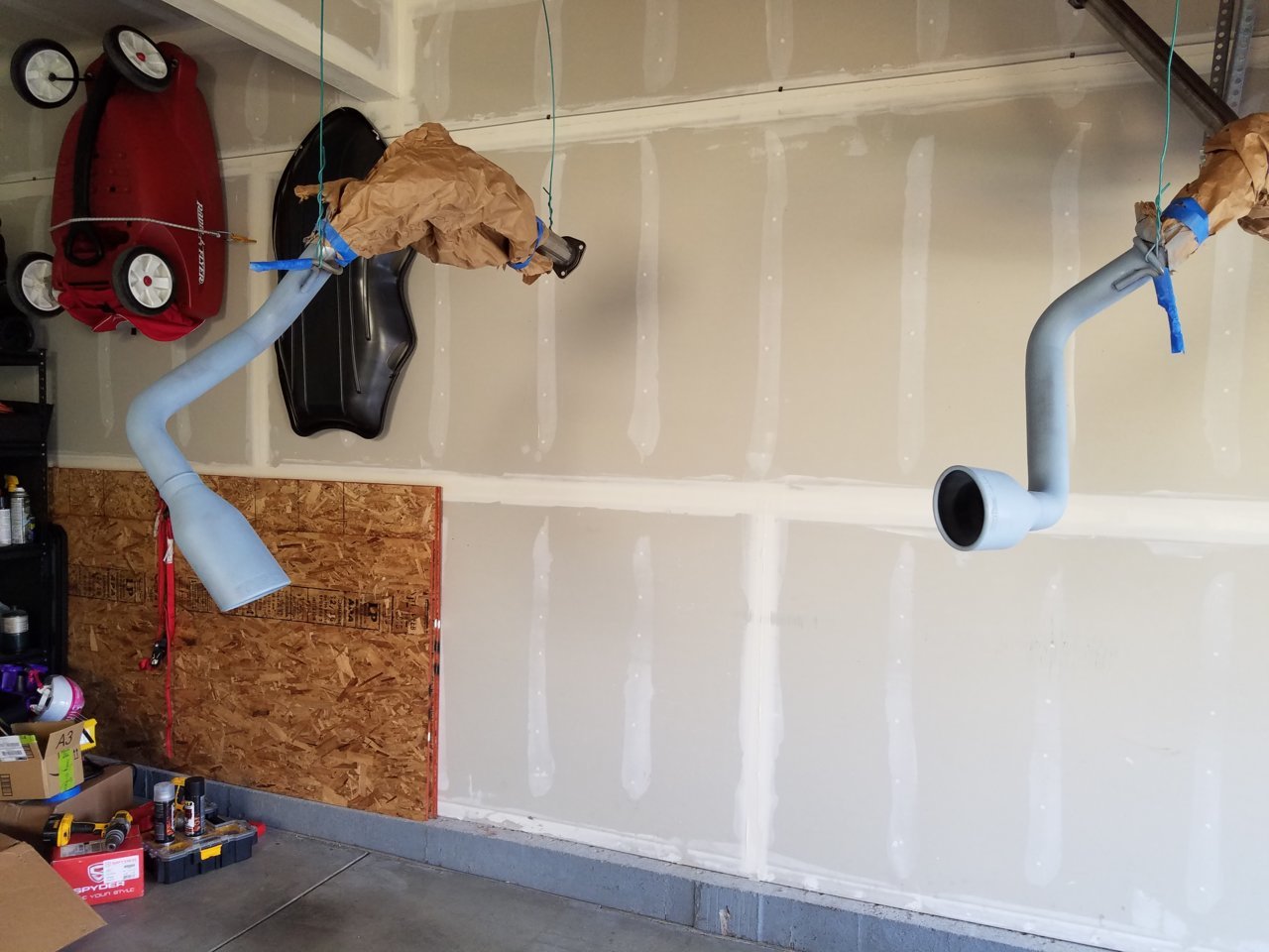

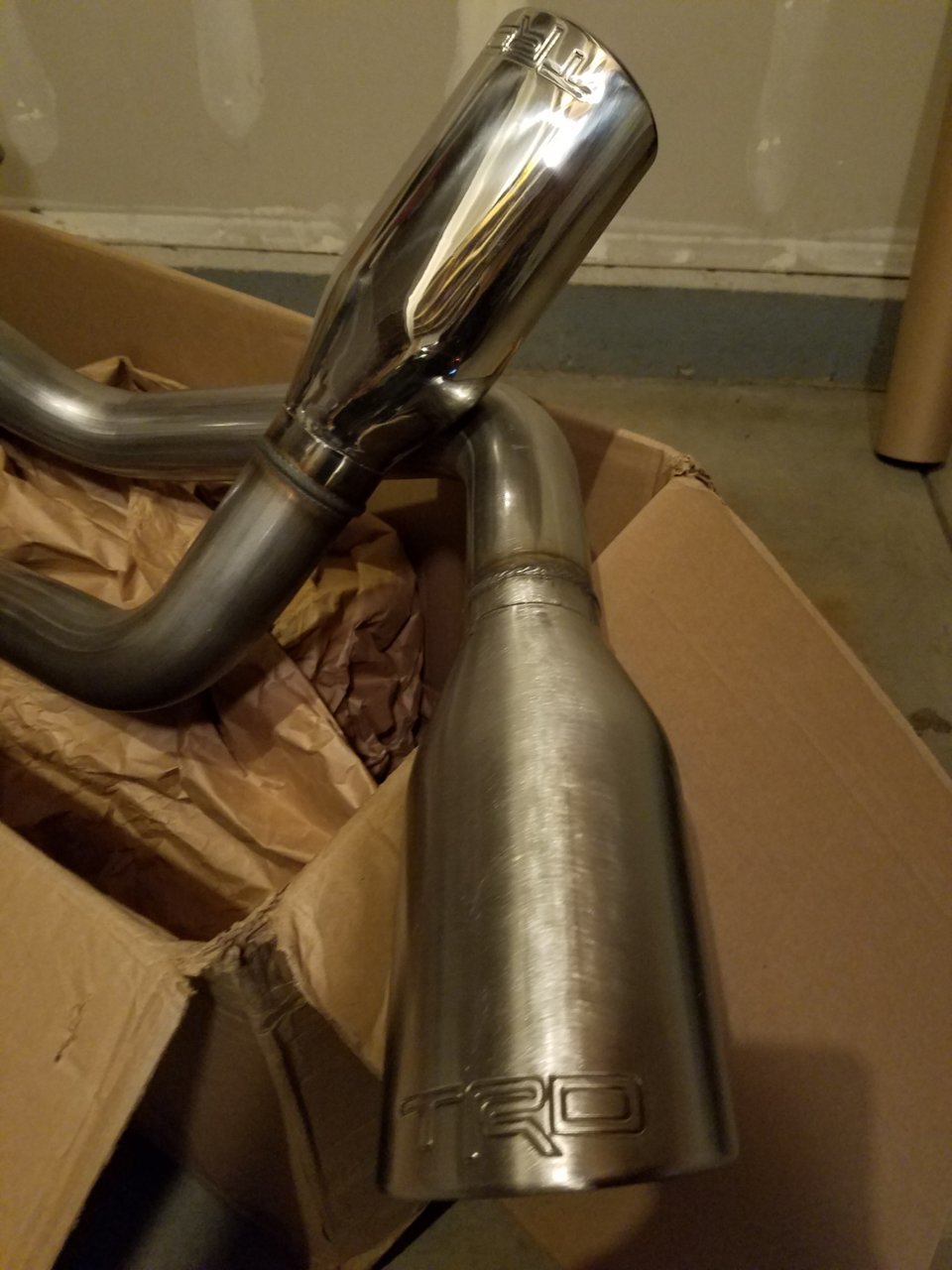

    I used VHT paint to paint mine a few months ago. I had to scuff up the chrome a bit. I don't have any current pics, but so far it has held up well.
    20170831_190035.jpg 20170831_235640.jpg 20170902_150645.jpg 20170902_164302.jpg

    Tnx for sharing, looks like it came out great in pics.
