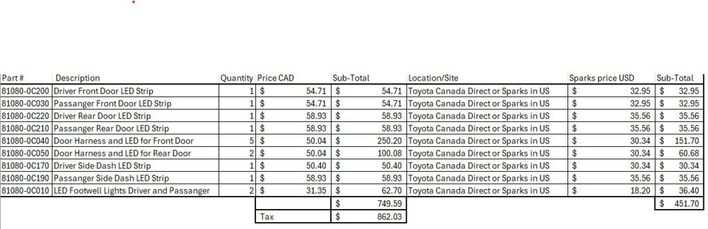

    Ok so we have a Canadian Sparks - Toyota Online Direct Canada...Buy OEM Toyota Parts | Toyota Online Parts Depot
    Here are all the part # and quantity you should need... 3 harnesses for the dash lights and one for each door * note the difference between the 050 and 040 appear to be front and back door harness , not left and right. this adds up to about 100$ cheaper than Rave Offroad's kit... if it's worth it to you , pls feel free to support local businesses. I prefer to cut out the middle man on OE parts.
    darn near 900$ CAD for some mood lighting , Duty would likely be at least 150 so its still cheaper than sparks , but wow - that's a lot of dough.

    For anyone interested, I just installed a VLED series of kits for my footwell lighting. Did it for front and back and they come on at a high setting for door open, like the OEM ones did then come in a low setting at night when the headlights come on. Here’s my walkthrough:
