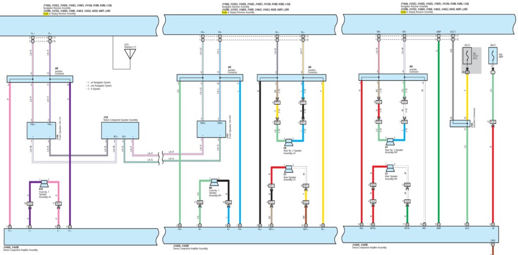

    For starters, here's a look at how everything is wired up in your 2020 non-JBL system:
    Basically in the front, you have a speaker in each dash corner that is wired to the front center speaker wired straight to the stereo. There's a speaker in each front door wired to the small amp under your passenger seat. In the rear, there's a tweeter in each door, also wired straight to the head unit. There's a speaker in each rear door wired tot eh small amp under the passenger seat.
    To add some bump, the absolute easiest thing to do would be to get a small powered sub. Beyond that, get either an Audiocontrol line output converter with Accubass (don't necessarily need a line output converter if an aftermarket amp accepts high level inputs, however with the stock head unit you'll want some sort of bass correction) or an amp with built in bass restoration/tuning like a Kicker Key amp, along with a single or double shallow mount sub(s) for behind the rear seats.
    Like @Danimal86 there's really no plug and play as you almost always have to run power wire for a new amp, but beyond that, factory integration wiring harnesses can be bought so you don't have to cut anything and everything is plug and play.
