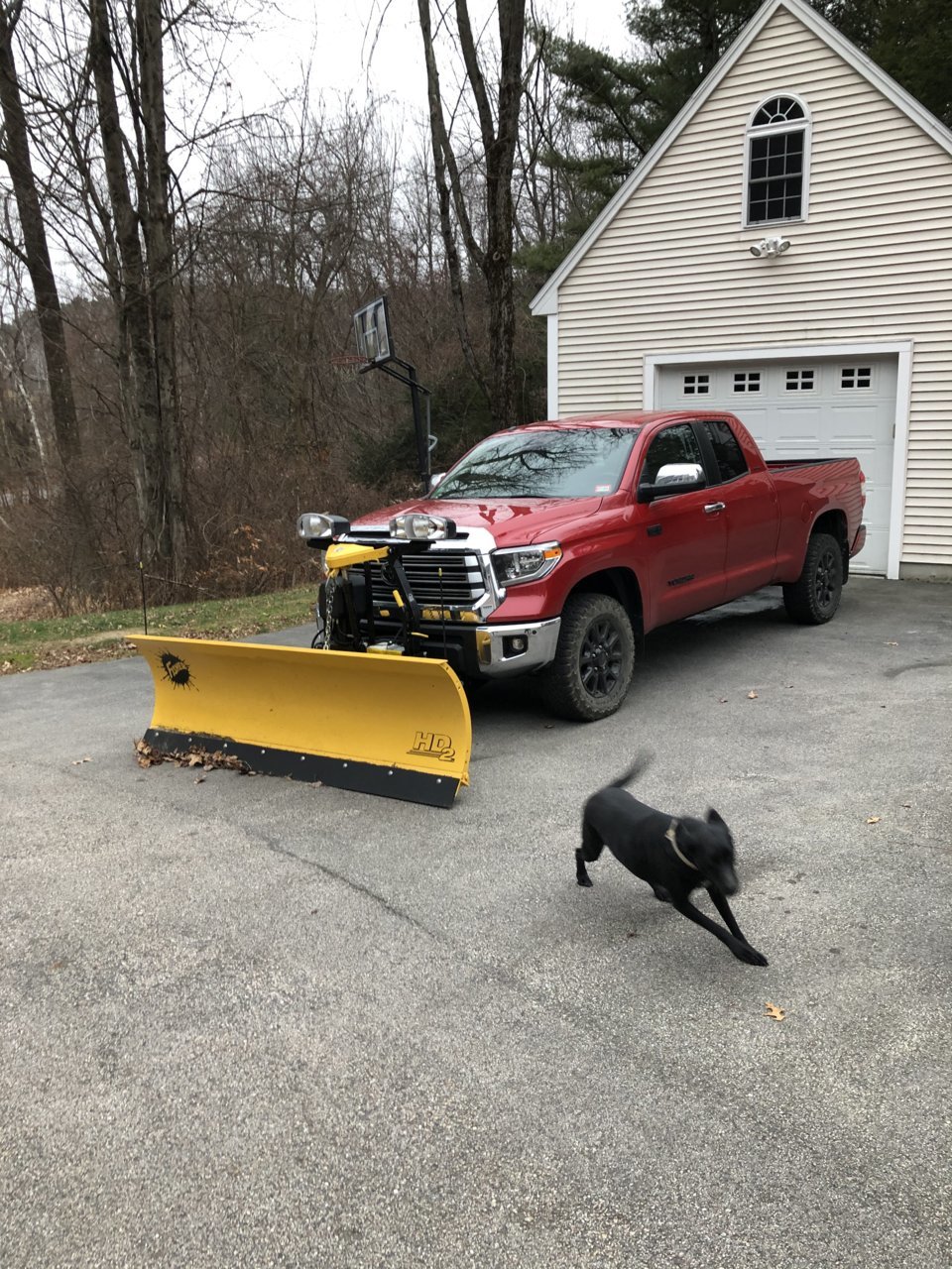

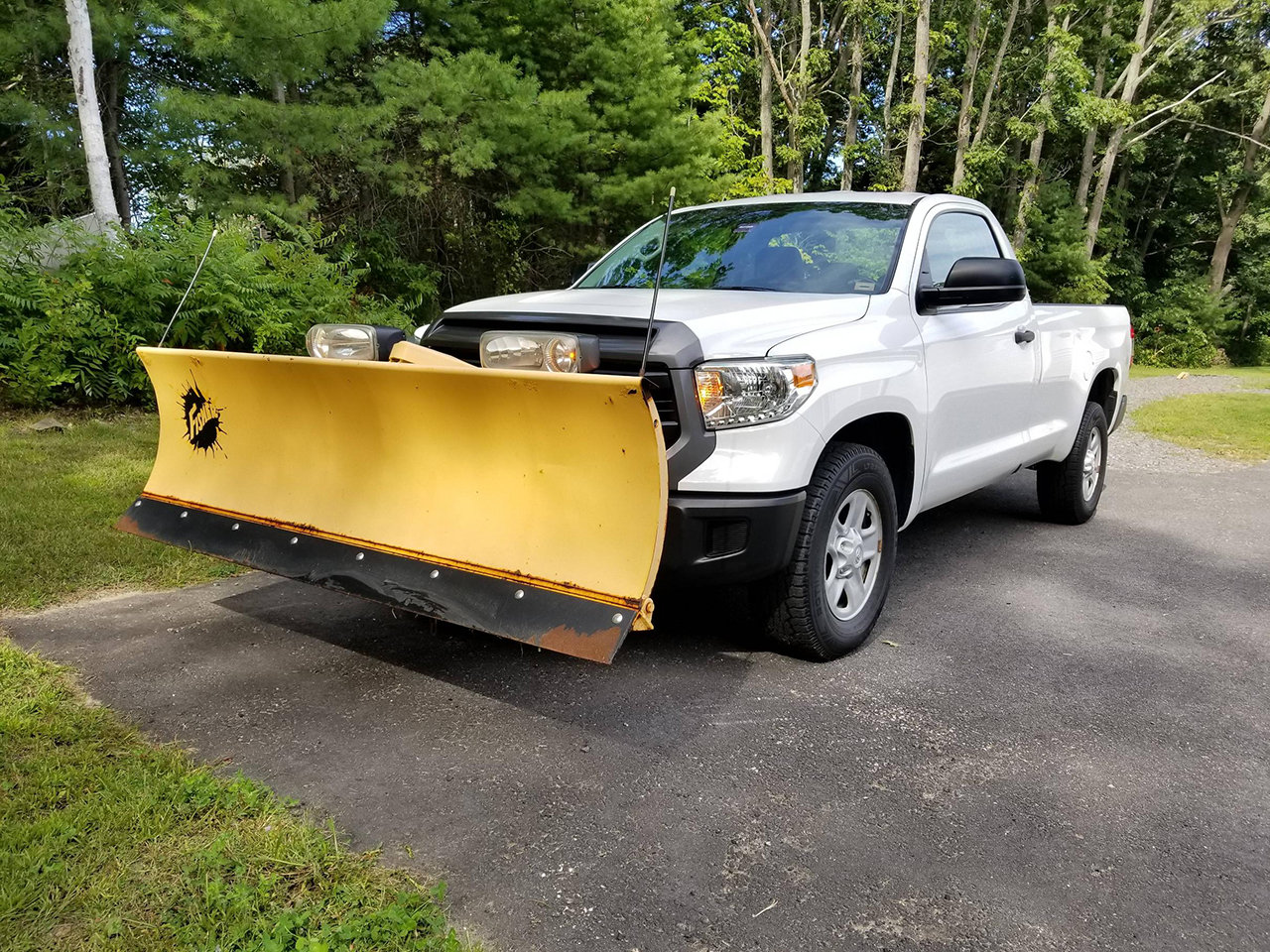

    The 3/1 spacer lift isn't going to help the truck better handle the weight of the plow anyway. You'd be better suited with an upgraded front shock/spring combo like the Bilstein 6112. The spring perches are adjustable so you can dial in your height for the plow. The plow I used to run was a chain lift and had some adjust-ability to compensate for a taller ride height, but ideally you really want your a-frame to be level with the ground.
    The bumpstops are probably a good idea in addition to the shock/spring upgrade but you don't want to be relying on them to do the work that the suspension should be doing.
    Anyway, best of luck from a fellow Mainer. Here's a couple pics of my old Tundra with a 7.5' Fisher SD with stock suspension.
    Edit: Also, I wanted to mention that the manufacturer plow "recommendations" for these trucks are very conservative. I think the front suspension is really pretty stout for a "1/2 ton". I have no first hand experience but I have seen several people running 8+' V plows on them with no issues.

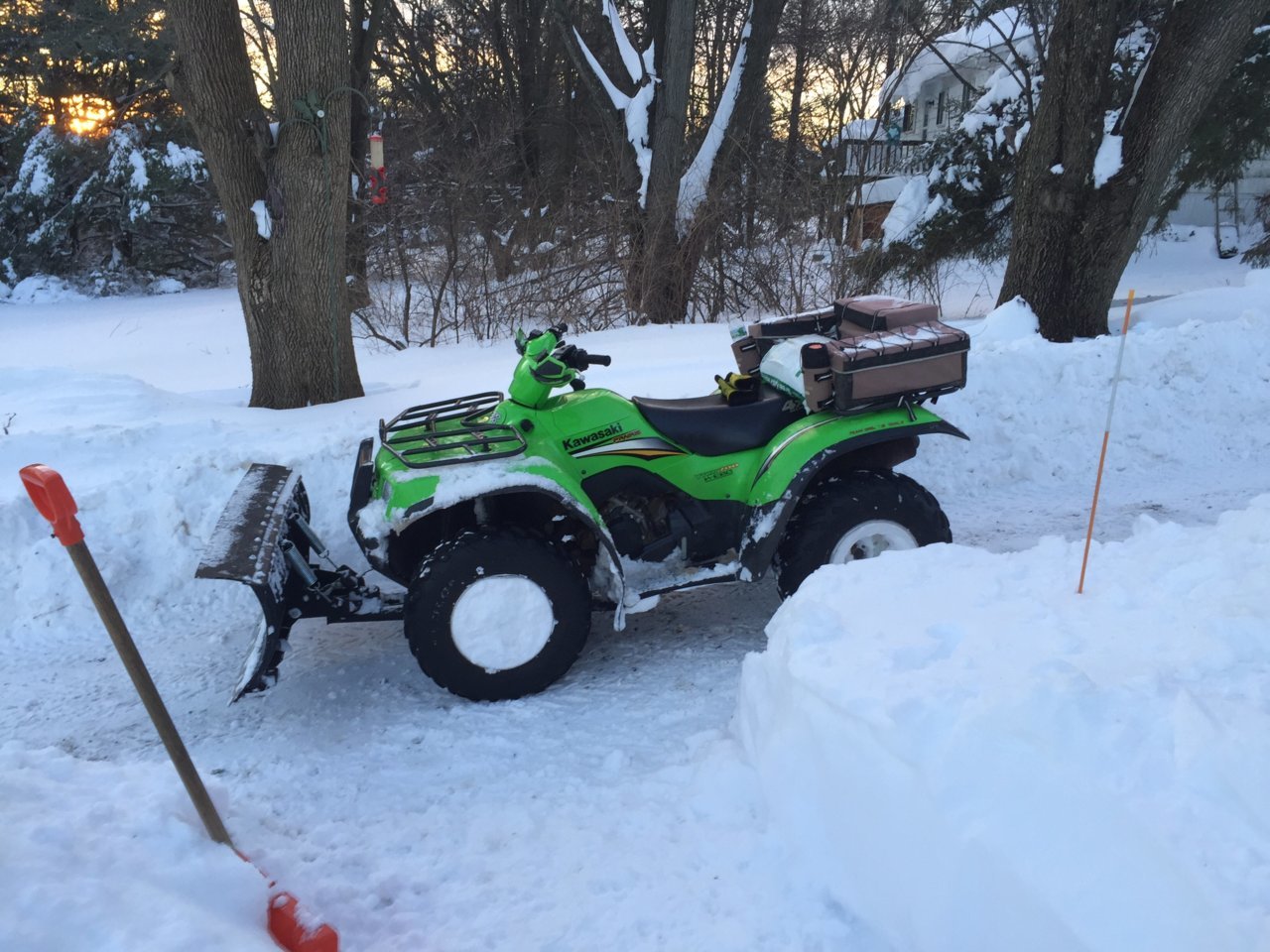

    Not plowing with the tundra- I use the ATV- also turns around on a DIME !!
    Just need more clothes on !!

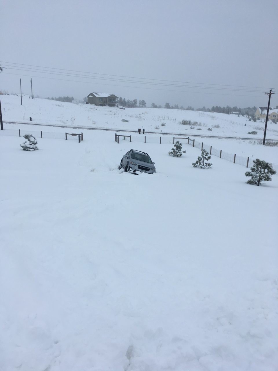

    My snow removal tool.
    My driveway sucks when AWD Subaru's get stuck (driveway is 7% grade) at the end of May this year....

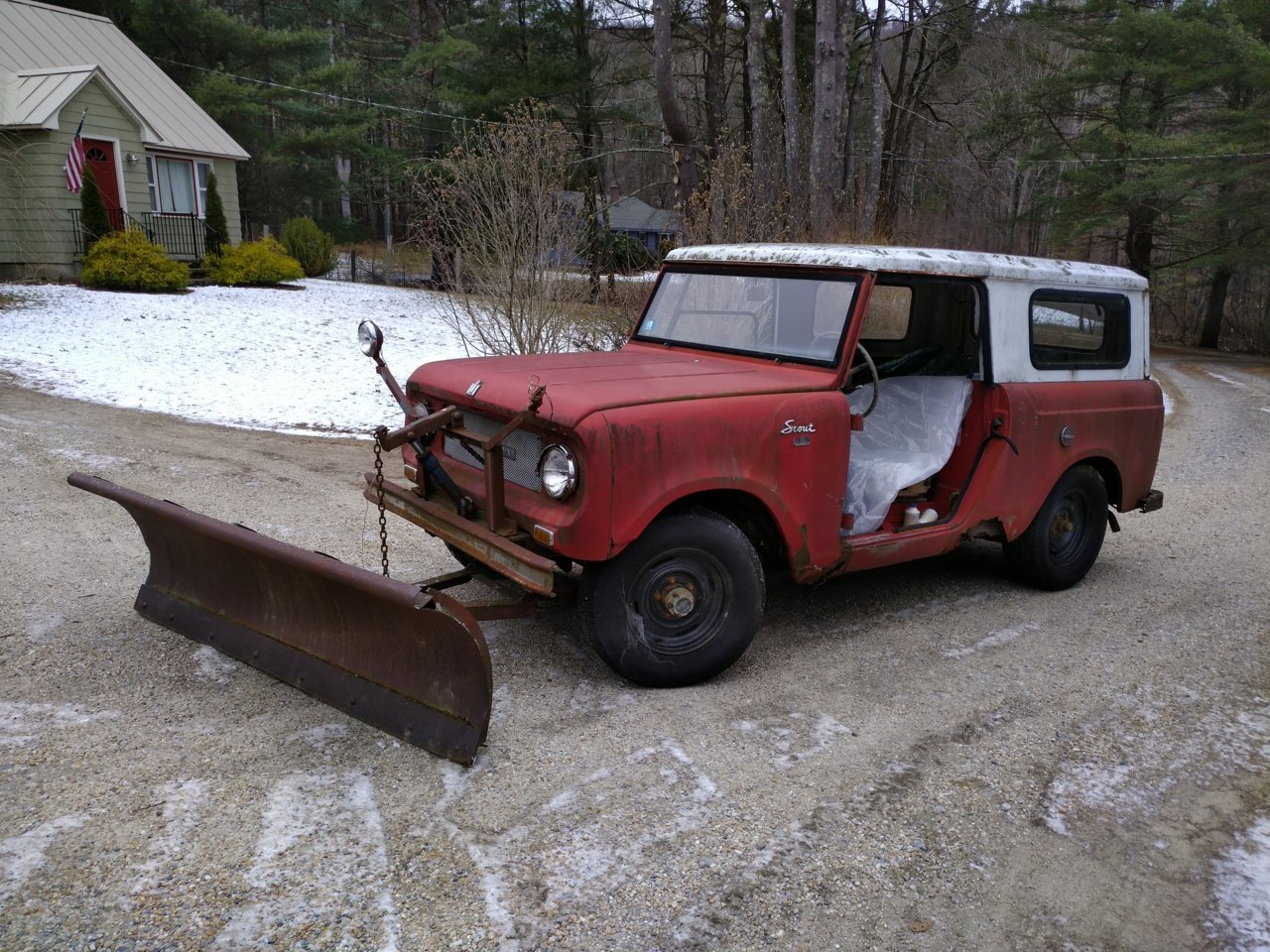

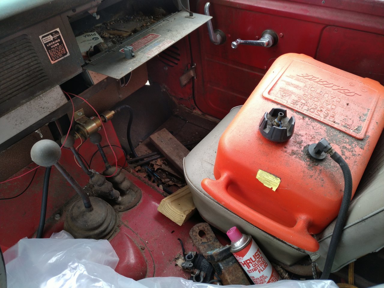

    Here's my plow rig. A bit old school. International Scout with the 196 CID 4 cylinder. Best $50 I ever spent!
    No V plow here. In fact, if I want to change the angle, I have to get out and pull the pin and physically move it to the desired angle then replace the pin. Only hydraulics for up and down. But hey, for $50 I can't complain. It's been plowing my driveway for the last 10 years. It's a little drafty in there with the missing driver's door, but again for $50 I'm not complaining.
  11. Oct 2, 2019 at 6:44 PM
    SunTundra413
    SunTundra413 New Member
    Jun 10, 2019
    #31735
    146
    Ned
    Massachusetts
    2019 Black TRD Sport DC 4X4
    ARE Cap
    When I first got it, the previous owner said it needed a fuel pump.
    I called the local auto parts store and they said they could get the original style mechanical pump, but it was $150, three times what I paid for the Scout. Then they said: "We have a universal low pressure electric pump for $40". I said: "I'll take it".
    I got the pump, bolted it to the metal dashboard, ran wire to the battery with a switch on the dash, and ran rubber fuel line through the firewall to the carb. Bought a 6 gallon plastic boat tank and put it on the passenger seat. Works like a champ!

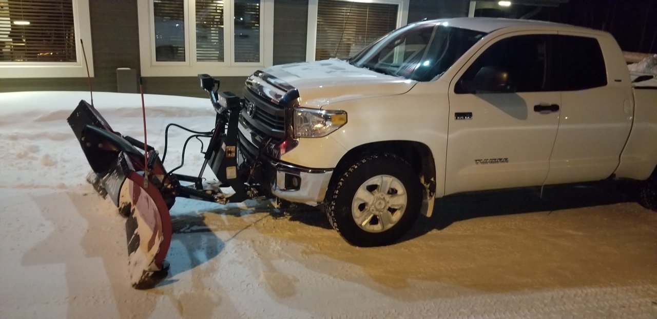

    That looks exactly what I used to have, got it for free, I would have to bet the fuel tank is rusted out.

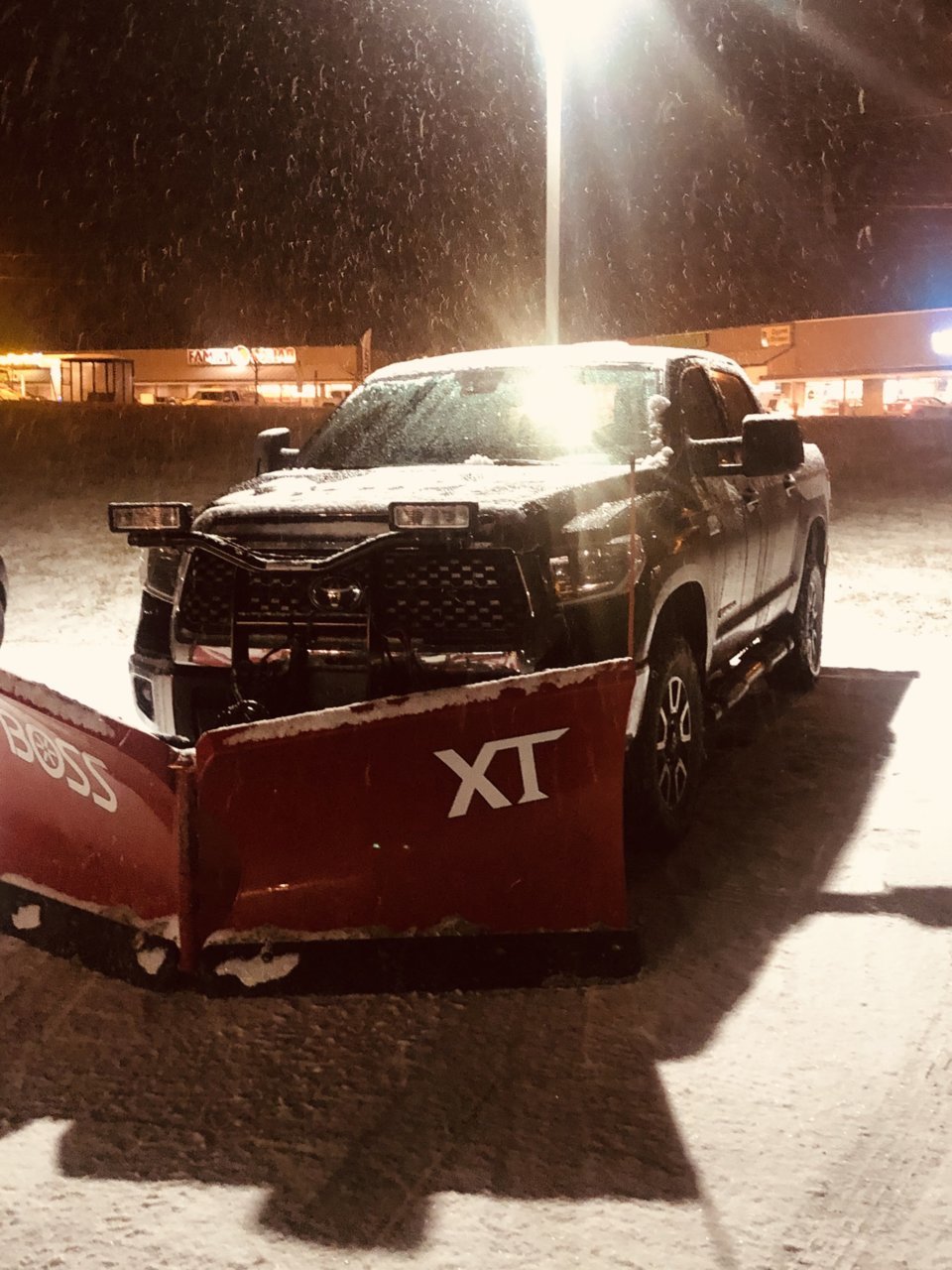

    Just wanted to update. I ended up going with the 8’ 2” Boss VXT. Weighs in at 714lbs. I’ve only plowed one storm with it so far... about 8 inches of snow... and it handled like a dream. Running a 3/1 setup with Timbrens up front to replace factory bump stops. 350lbs of ballast weight in the rear most of the bed. Pretty impressed on how the truck did. I’ll update with pics next time it snows (tomorrow) if it’s plowable.

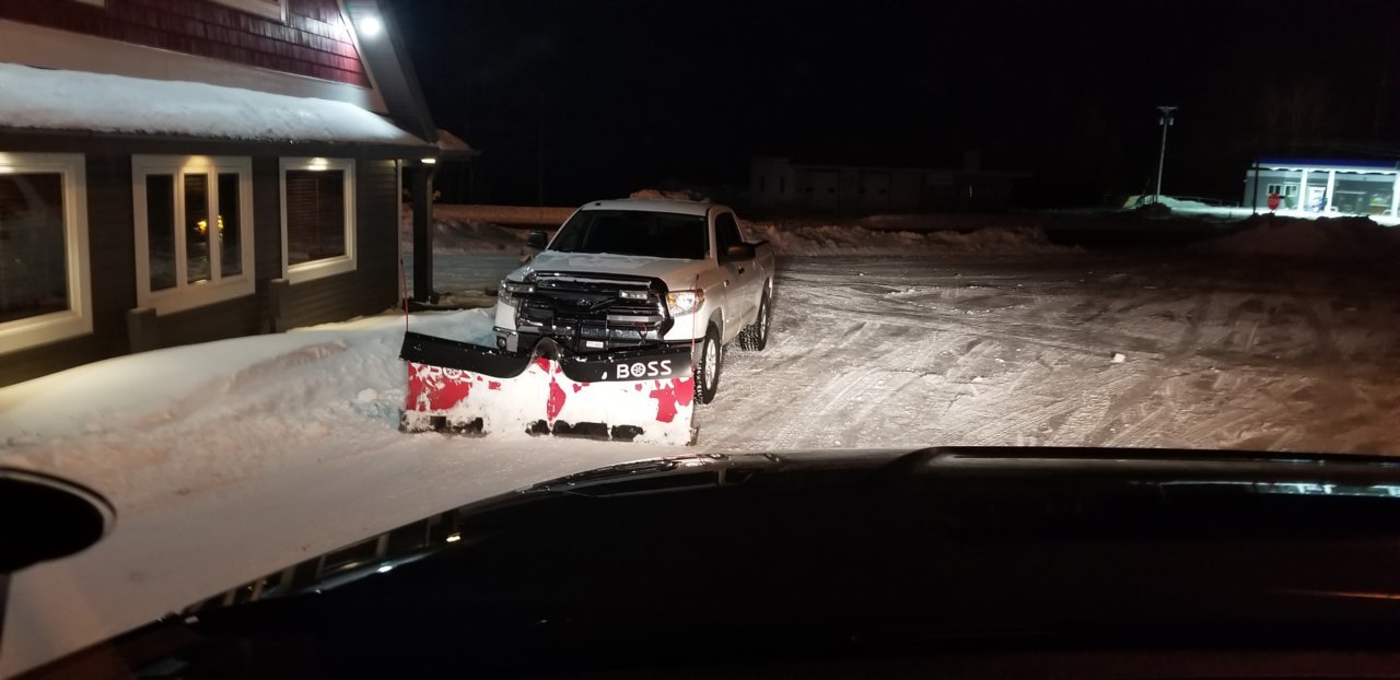

    Took this the other night if it helps at all
    When I get time I will get some info on it.

    Took this one earlier this evening. I’ll try to get some other pics once the snow is done and I’m actually out plowing.F14257AB-CC66-49B2-B2DF-1795D2DDCFD8.jpg
