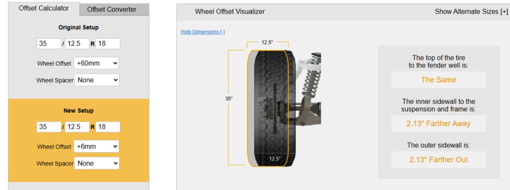

    I have been reading threads, stickies and searching, filling my old brain with all kinds of new information about wheels and tire upgrades!
    It all boils down to this package deal for my:
    ‘19 Limited Crewmax 4x4
    3” Lift Coilovers front & rear 3”.
    Stock OEM 20x8 wheels 60 offset
    Tyger 1.75” fender flares
    But I wanna run it past the experts here first… and my wife of course.
    Black Rhino ARMORY
    18x9.5 5x150 +6 offset
    Venom Power X/T
    35x12.50R18

    That's over 2" on the offset change.
    But your flares will probably cover it..

    with low offset wheels, +6, and 35x1250s expect Body mount work, removal of mud flaps, wheel well plastics mods and probably an aftermarket high clearance bumper. You might be ok with a bumper spacer, but that low offset may still hit.
    FREEK[OP] likes this.

    Offset seems to be the biggest concern here, with regards to not wanting to do any cutting.
    I'm on a 3" (ish) lift via Bilstein 6112's, running Toyo OC AT3's in 35x12.50r17 mounted on Icon Vector 5's which are +25. I've removed the flaps front and rear, as well as spaced the front bumper .5". I have a very mild rub in reverse, full lock. I too, wanted to avoid any metal cutting in my quest.

    2016 Crewmax 4WD, TRD Offroad
    +25 to +35 clears UCA with 1250 wide tires and does not stick out so far to cause fitment issues, other than the usual things we have do, which I mentioned. Not to mention what happens to the paint when tires are sticking out 2 inches or more, throwing crud, sand, rocks down the truck and up on the side mirrors.
    Lots of rim options in +25 offset
    Here is a good tool to help understand how offset and even wheel width changes will impact stance https://www.customwheeloffset.com/tire-wheel-backspacing-offset-calculators

    Thank you! May have to skip the Black Rhino Armory wheels for another model with more offset options.
