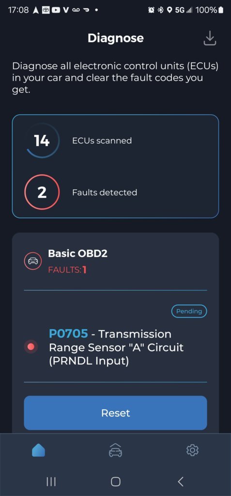

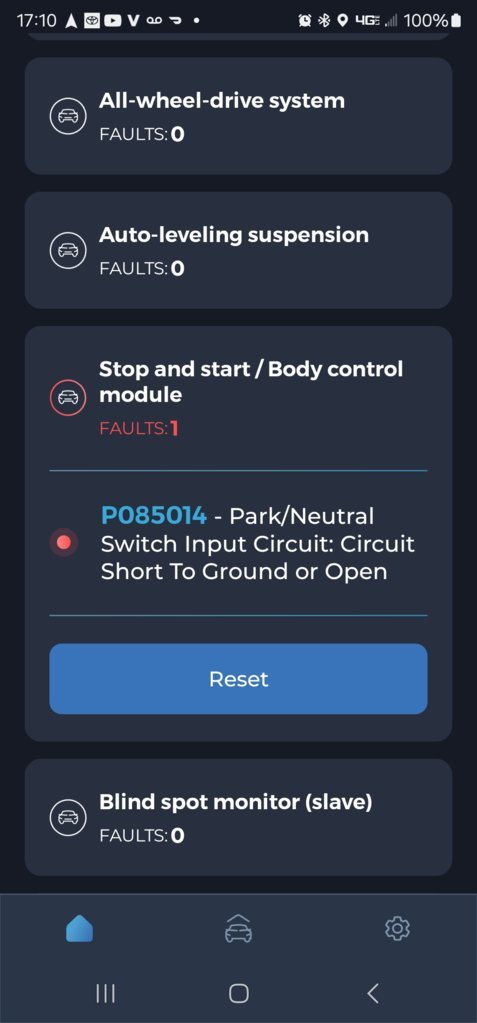

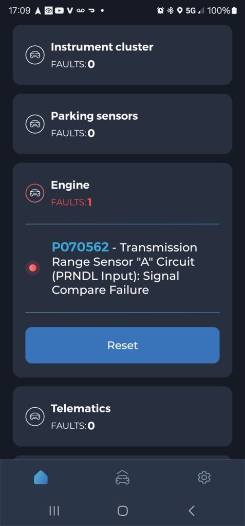

    So I just had my engine replaced and 1000 miles later I'm getting weird codes and it lags like it has no power. Here are some pictures of the codes. Could a bad battery cause this?

    I’m no tech but my first thought reading those codes is a lose or bad connector on the shifter linkage or the gear sensor wiring from the trans. (Both sound related to the same connection problem) Maybe they didn’t get something plugged back together tight. 11K miles left in that warranty.

    I agree with @PNW Tundra Mike - it could very well be a connector.
    A low battery would also be plausible.
    I assume it is still under warranty - why not cal the dealership and have them look at it?

    So far they said it's definitely a short in the harness somewhere. The fun part is HB wouldn't touch my truck until I agreed on the diagnostic charge of $1100. They say it's not their fault that my dealer messed it up. I thought since this is a Toyota recall it should be covered anywhere?

    They are saying the problem is the neutral safety switch.

    Sounds like the right neighborhood
