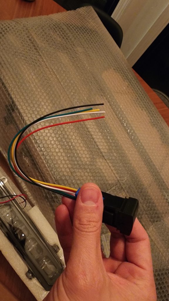

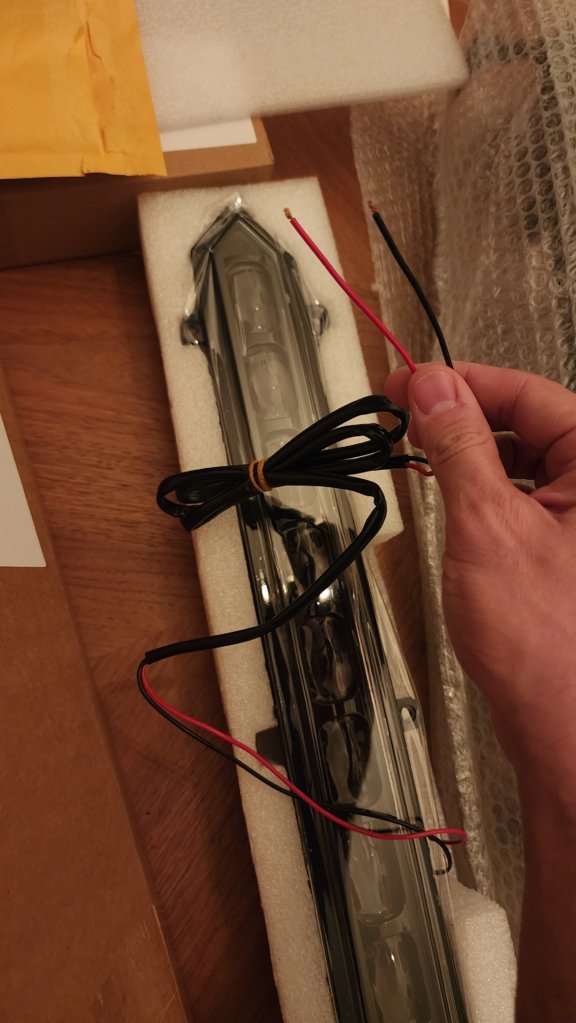

    Just purchased a TRD Pro grill and switch for my 24 SR5. I've done lighting in the past for my jeep but it was simple setups. What am I missing here? Clearly the cord for the lightbar isn't long enough and wiring doesn't line up. Any help will be greatly appreciated as I'm starting the swap in the morning!

    Hard to say without wiring diagram for this specific switch but, your switch should be red to power (on/off) white and black tied together and grounded (ground) green completes circuit and yellow ties into illumination (I used brown wire on existing truck switch). You want to run a relay and a fuse from battery.

    Is that the Rave light bar? It looks like you are missing the relay harness.

    Mine was missing a harness as well. Contacted Rave - they quickly responded and are sending the missing harness that will connect the switch to the fuse relay and o-terminal ground.
