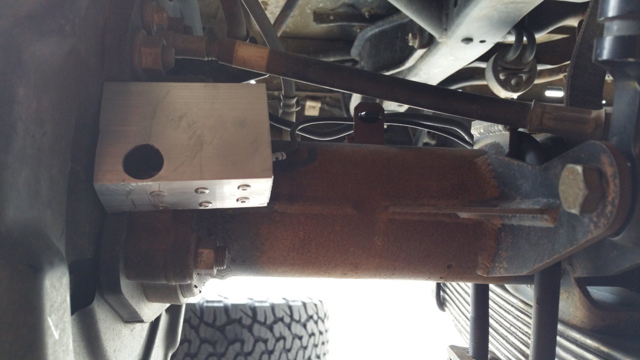

  15. Jun 29, 2017 at 5:41 AM
    osidepunker
    osidepunker OsidePunker
    Oct 19, 2016
    #4918
    3,000
    Alex
    SoCal
    2013 Tundra DC 4x4
    Full LT, full armor, fully self contained Speed Glamper
    I made my own for $5 in parts
    reywcms and (deleted member) like this.

    I'm not disagreeing with you. Just letting people know what I did. Its not difficult. I made it out of aluminum from the local hardware store and rivets. For tools, I used a hacksaw, file and rivet gun. Took a half hour per corner
    14burrito[QUOTED] likes this.
