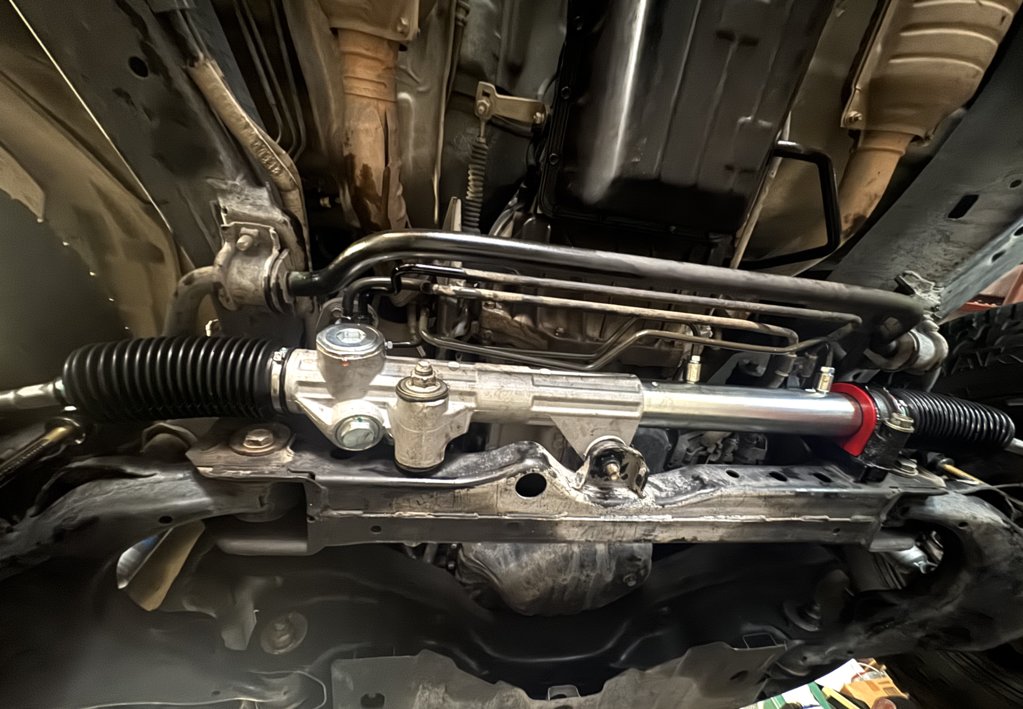

    I replaced the whole steering rack today. The inner tie rods were toast but the rack was also leaking so I went ahead and did the whole. All better now!

  17. Jun 24, 2025 at 8:56 PM
    grzzlr
    grzzlr [OP] New Member
    Nov 17, 2022
    #86904
    18
    2002 AC V8 TRD 2x

    Oh hell yeah I’m on a budget so I ordered a Detroit axle and with 2 day shipping I had to as bad as I wanted to go OEM I couldn’t.
    what brand did you get? OEM?
  19. Jun 30, 2025 at 9:10 PM
    grzzlr
    Nov 17, 2022
    #86904
    18
    2002 AC V8 TRD 2x
    I'm on a budget too... I went with Detroit Axle too I think it was $203 before tax. I haven't looked into shipping the core back for the warranty but the rack is self feels good for now.
