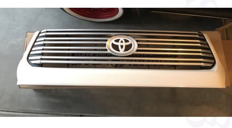

    Anyone who has a platinum Grille like this, does the center come out from the white surround part? Thinking of buying this but still want to change out the center for something black.. or paint maybe.. thanx guys

    Wasn't sure, I figured it was like the rest of them, so I could take it out but you never know...

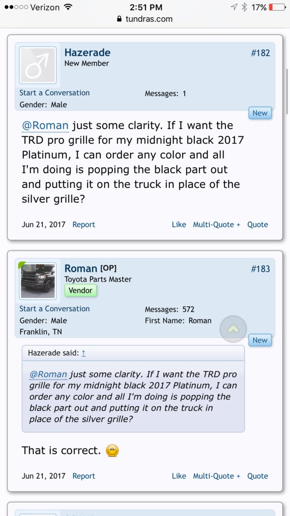

    Here ya go Jay. Confirmed by Roman. Yes they're the same as all the other grille inserts and will pop out.

    It comes out. A little bit if work, there's probably a dozen clips that are fragile buy it's not horrible. I replaced my platinum insert with a pro insert. Took about an hour or so

    I have a white surround Grille here in Vegas and it has silver billet that I want black.. night buy it and pull out center and get the black regular Toyota one or yes paint It.. ice found a white hood bulge also that's been cheaper that buying the new set from toyota

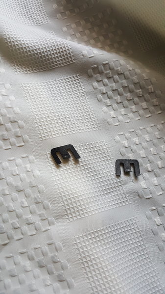

    Heat up the clips prior to prying them to prevent snapping.

    The clips? Don't they just snap off?

    They are fragile. Especially when cold. Ask me how I know

    They break off pretty easily but breaking a couple really won't affect it when you put it back on. I was thinking next time I was going to shove paper clips or something in a few of them to help get them off wiffout breaking them.

    Do they sell new ones

    The black tabs? No, there's no way to put them back on. It's all a giant single piece of plastic and if they break, they're gone. But there's a lot of them so it's ok to lose a couple.

    ITs pretty shitty that every time you remove the grille the clips break... they should have done that some other way to make it last.. once or twice and it's not gonna go on anymore

    I think once you get it off the first time, they're less likely to break after that. Lots of people don't break any the second time.

    And the tabs are actually on the surround, not on the insert.
