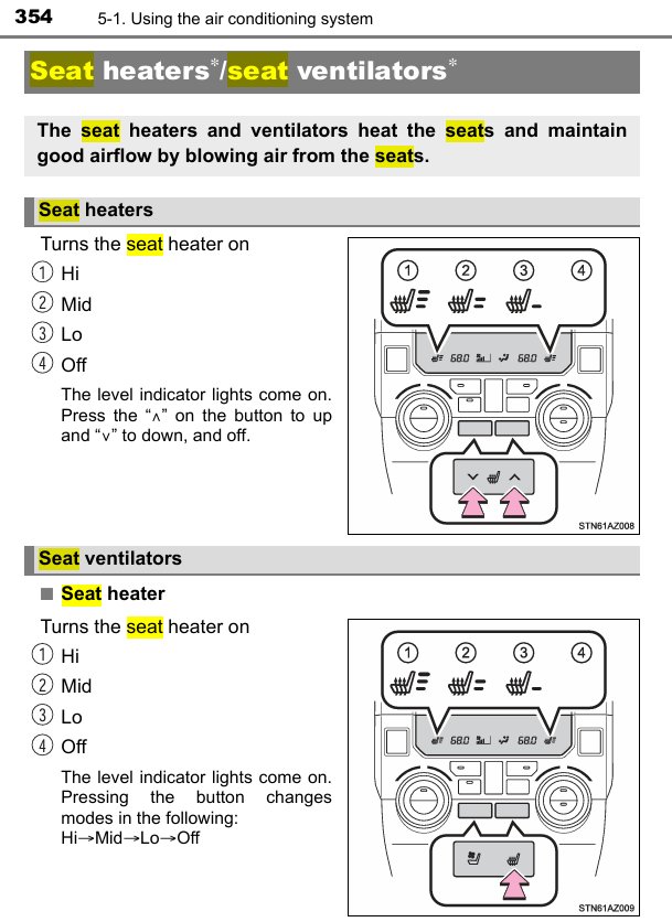

    Looking to get some platinum seats with the switching for the heated/cooled seats to swap into my TRD pro. Has anyone done this or know where I can get some ? Would my best bet be to buy directly from Toyota ? I know this is a strange request but I find the TRD seats to kind of suck and with the summer getting hotter the ventilated seats would be a welcome break

    The heated and ventilated seats are powered by the climate control.
    Unless you already have that (and why would you) it isn't going to be an easy swap.
    Your ECU may not be compatible to run those seats.
    And not even knowing if it will work that climate control is $860..
    55900-0C190 - Temp Control - 2014-2021 Toyota Tundra | Sparks Parts
    Your sig line reads you have a platinum.:confused:
    Good luck..:thumbsup:
