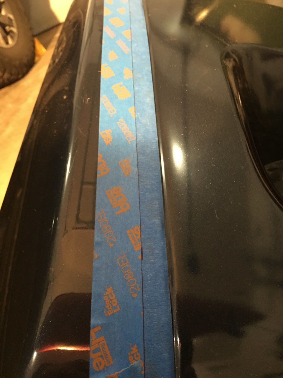

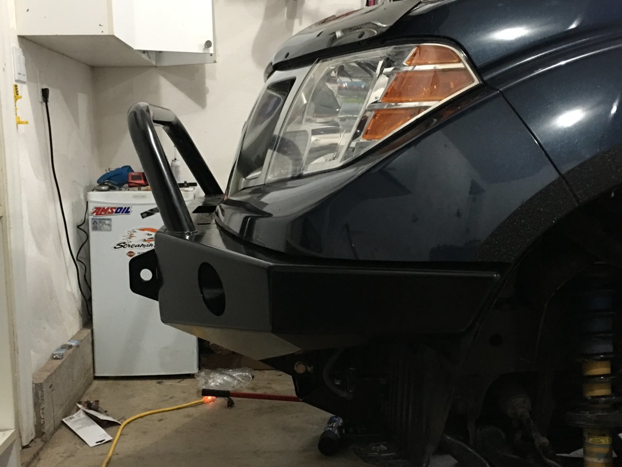

    My previous truck was a Nissan Frontier. I ordered a ShrockWorks off-road front winch bumper. The install of the new bumper meant that I had to cut my previous bumper covering in half. I measured about 20 times, laid out some painters tape and made the cut with a jig saw that had a plastic cutting blade installed. It worked like a charm, cut was long and straight. No regrets.
