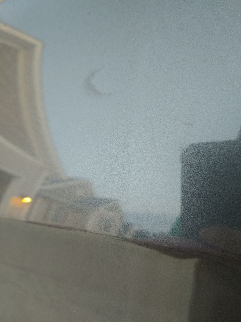

    So I noticed the other day that I have a descent amount if overspray from when I plasti-dipped my chrome emblems. Anyone ever use goo gone on large areas of paint before? I've used it to remove small stickers on my camper but am leary of using it on my new truck!

    No need. Just take a dry microfiber to the area or wash the truck or area. Done. No need for goo gone. In theory you just take your hand and lightly rub it off. Been my experience with plasti dip anyway. Emblem looks great.

    Yes...just wipe it off...

    The best way (okay, maybe not the 'best' way, but it is easy and works the best) to remove plastidip overspray is gasoline. Put a little gas on a rag and it will wipe right off. Of course you then want to wash and wax afterwards and all those disclaimers.

    WD40 is how to remove. Put a little on micro and it’ll come off with little to no pressure.
