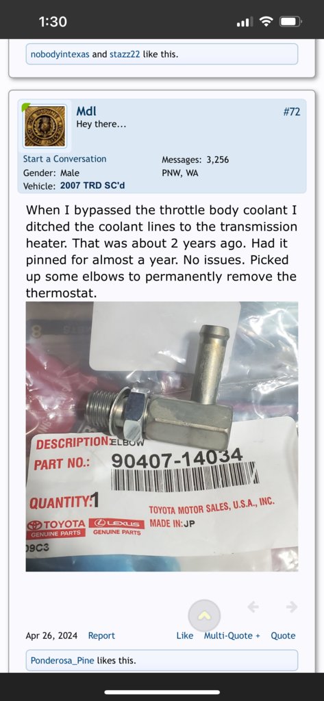

    If I had a 2019-2021 and was adding a cooler I would not bother to install the thermostat, I’d get these fittings in their place and leave flow to the cooler 100%, part number courtesy of @Mdl. You can’t/wont run your transmission “too cool” by having the cooler in play at all times. Especially if you’re leaving the warming puck in place that warms up the fluid anyway. I recommend this video by WAT who rebuilds these transmissions and offers valve body upgrades for them. TLDR, you can’t run it “too cool” and borderline getting too hot is basically the temp range that the thermostat opens. https://m.youtube.com/watch?v=DyU3LIpA-Mg&pp=ygUYd2hvbGVzYWxlIGF1dG9tYXRpY3MgZmFx
    Mdl, bflooks and nobodyintexas like this.

    @Silver17 gave a ton of good information there. I'll add the missing link to directly answer: Because the t-stat gave you the ports needed to route trans fluid to a cooler and back. That's why it was needed, until @Mdl figured out the LC elbows.
    Plus, not everyone needs/wants to pin or remove completely, but there are lots of options now. If you don't care about warming the trans fluid to temp quickly, you can remove/bypass the warming puck, which now allows you to use the elbows. A few of us have purchased aftermarket inline & serviceable thermostats so we can better tweak and tune our temps based on needs. The factory t-stat is probably plenty of 80%. Pinning is good for another 10%. That last 10% are typically the power adder crowd being unkind to their drivetrain in multiple ways.
