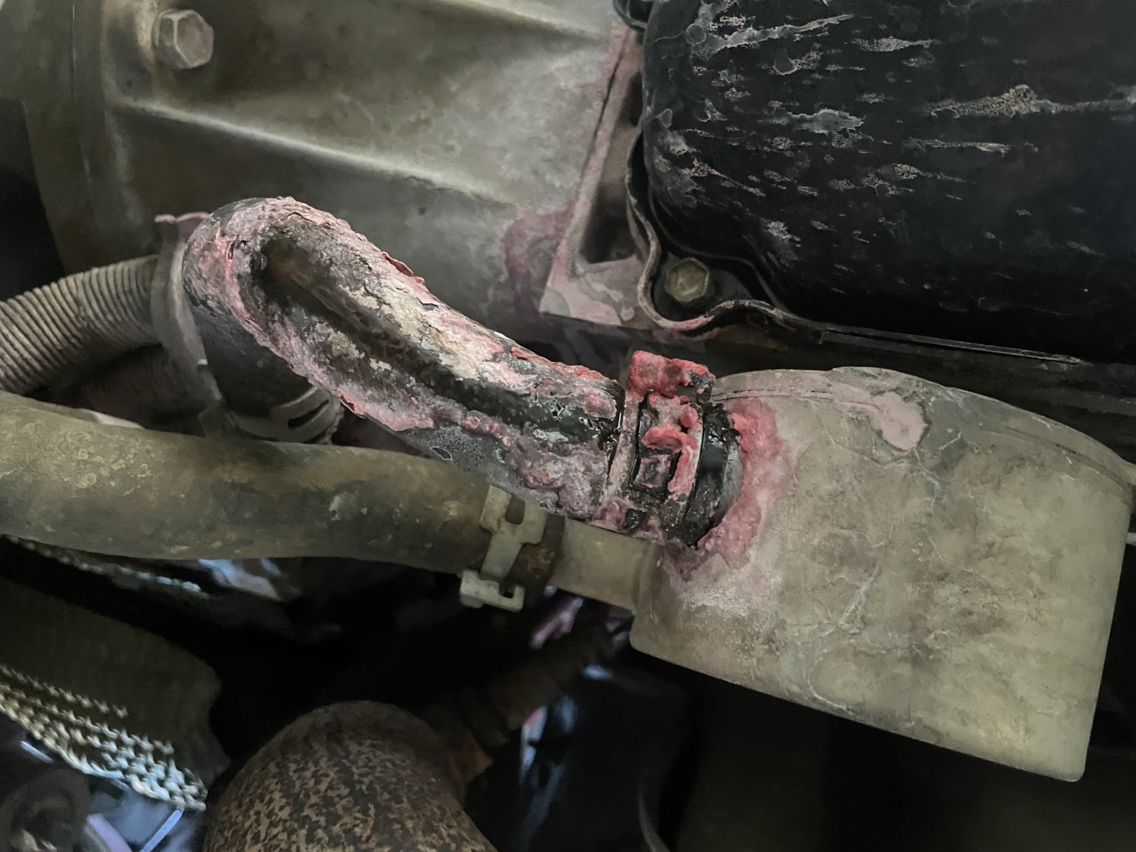

    Hey everyone, was changing my oil and noticed this underneath! Can anyone help me and tell me what it is and what I need to do? I have a 2015 SR5.

    Looks like antifreeze leak

    Coolant leak. Chances are it's coming from your coolant pan too

    Your coolant hose to your oil cooler and your clamp need replacing!

    Best case scenario haha

    Thank you! Caught me by surprise, I'll get on that.

    Clean it all up with some hot water and check to see if you have any fissures on that hose nipple.

    Just a heads up, that the Trans coolant puck and hose, not the oil cooler.
