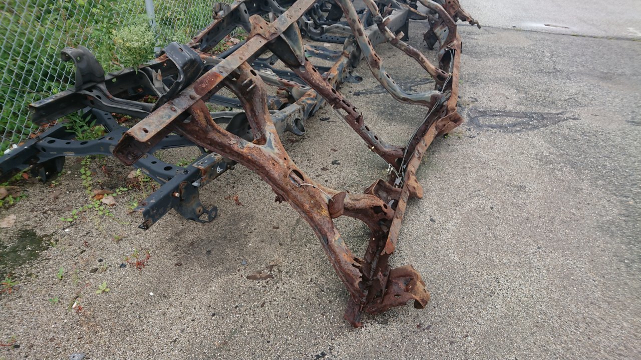

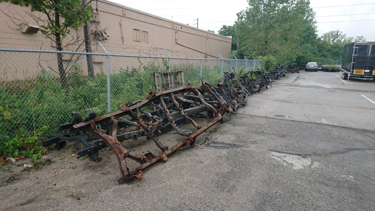

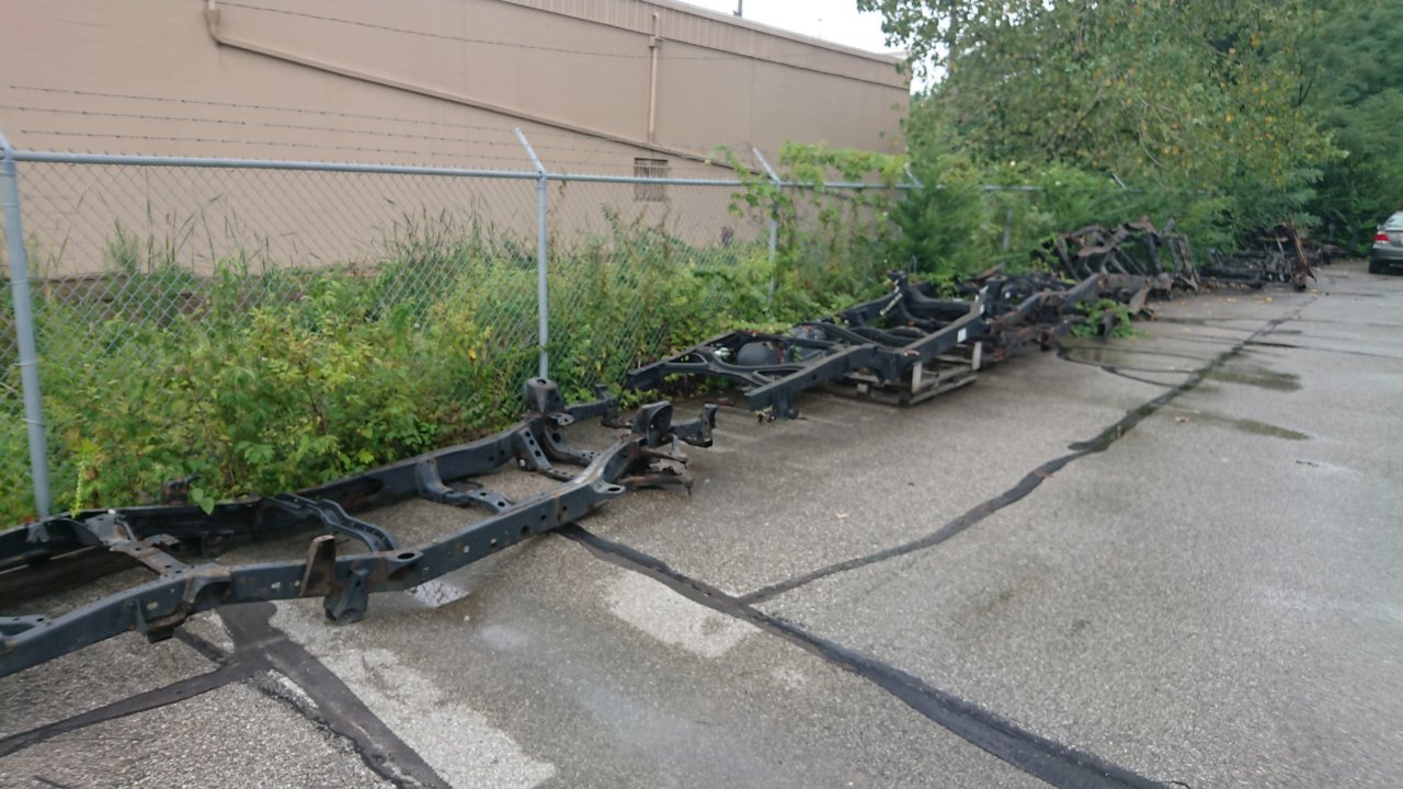

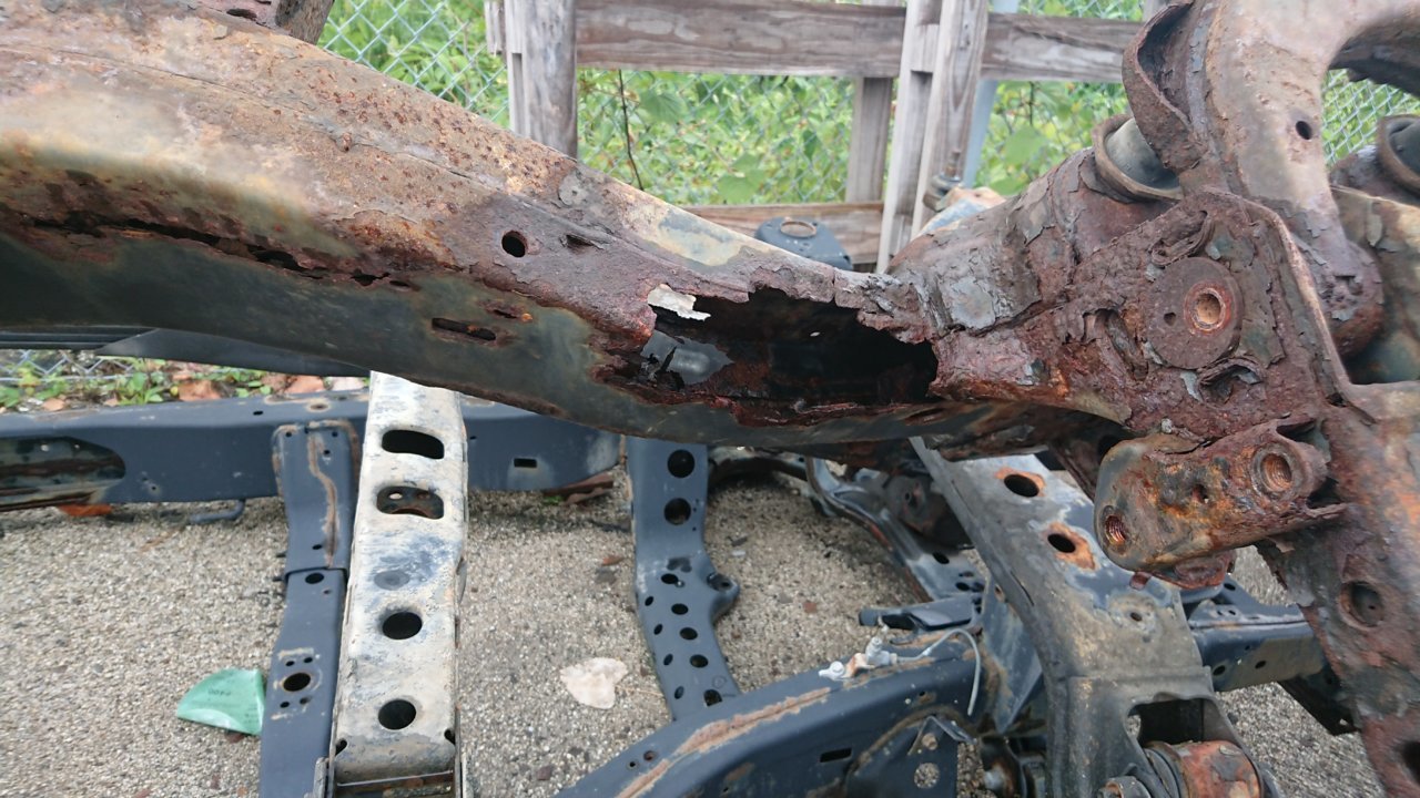

    Bought my truck just over a week ago and right after I did, I found a crap ton of Tundra rotted frames out behind my selling dealer from what appears to be 2007+ Tundras. What's the inside story on Tundra Frames???

    There was a recall on the frames rusting through. I've never actually herd someone getting there whole frame replaced normally they would just cut and weld bad areas or apply undercoating to prevent it. Cool to see they actually do the recall the right way. If that is what's going on

    I'm thinking those are Tacoma frames.
    My first truck was a 99 Tacoma I got it in 2003. It was bought back by toyota in 2008 for 110% KKB, which was only a couple grand less than what I paid for it originally. They also gave me $1500 cash towards a new Tacoma, so I got a 2008 that was a demo at a great price. You would think after buying back thousands of trucks at above blue book that toyota would be sure to rectify the frame issues right?....nope, in 2016 I got a letter saying my 08 was up for a frame recall/inspection. I took it in, they said it needed to be replaced and would take a few months to do the work and would give me a rental car....that's when I saw my 2015 tundra in the side lot, it was just traded in on a 2016 for the larger gas tank. I negotiated a trade for my rusted frame taco with 85k miles, they gave me $6k less than I paid for it 8 years earlier. Then they sold it a week later without replacing the frame first, which I still can not believe. I ended up seeing my truck at a store and talked to the guy. He bought the taco, got a letter a month later and ended up getting a new frame for it. Anyway what I'm trying to say is that toyota replaced thousands of frames on 2nd gen tacomas, while some just got an "undercoating" sprayed on. The 1st gens they just bought the whole truck back. I know tundras aren't immune to rust issues but they weren't getting frames replaced like the tacos were.

    Last month I was on I-40 between Memphis and Little Rock and saw a TON of 18wheelers hauling flatbeds full of painted frames headed northbound. Today I was on I-30 headed south out of Little Rock and met a few truckloads of frames headed northbound. Both times I've wondered if they were Toyota truck frames because they were coming south to north like they could possibly be from SA Texas, assuming that is where they make the replacement frames.

    My 2008 frame has held up fine but I removed the rubberized undercoating applied by the previous owner and repainted it. More Tacoma frames were affected than Tundra frames were. If you're worried about your truck take a hammer and chisel to the frame and see if you can perforate it.

    Look at all that swiss cheese!!

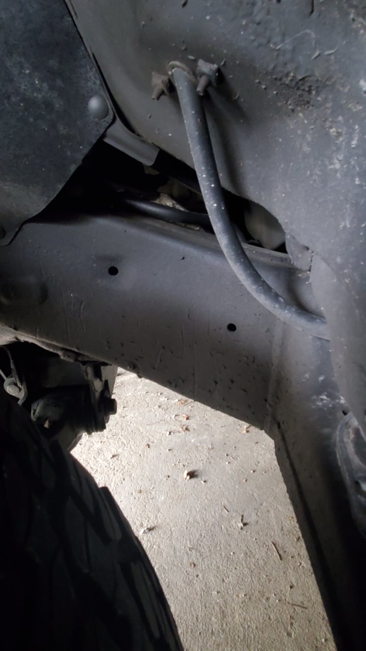

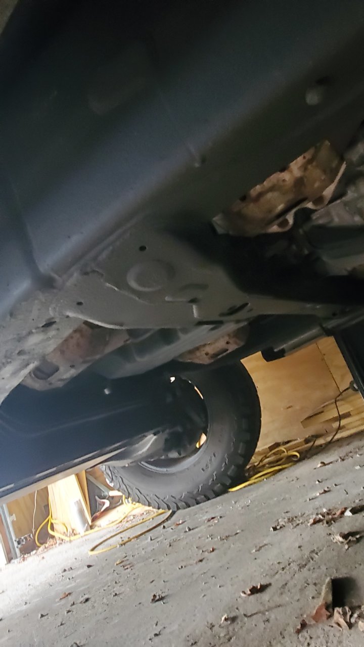

    15672779286093145129441360168298.jpg 15672779992595142220704428929330.jpg I have the under coating on my truck. Before they applied it there was not much rust at all. Not sure about now bit I hope not.

    ^^^ that coating looks good, not thick or rubber like ^^^

    Nope its actually dry now after a summer and I feel it would take alot to get it off.

    I really hope that coating works out for you Mike. Keep and eye for bubbling and internal cancer. Have seen a lot of "undercoating" sprays go south in a hurry because they can just mask the rust and even trap moisture and dirt between the spray and the metal. Hopefully yours was done right and it holds up.

    It looks like a breathable material. Non-glossy. Not like the aftermarket companies that spray a permanent shiny hard coat on them. I thinks it is a positive thing here.
