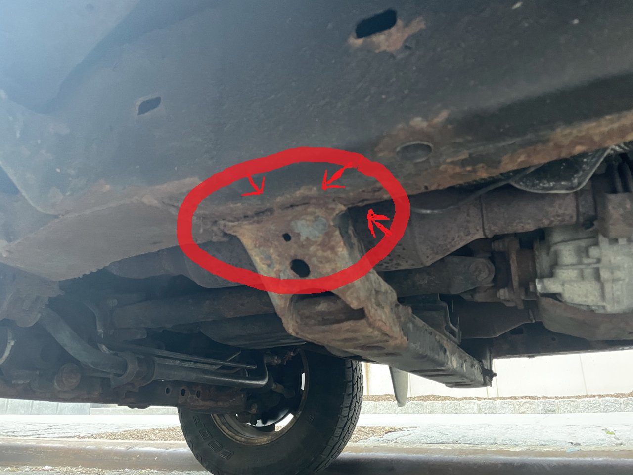

    Hi, New to forums and new to me 2005 tundra 4wd access cab with the 4.7 and only 130k on clock
    I thought I did through inspection but I seriously missed some big rust issues.
    The frame seems 90% solid with just surface rust but this piece in particular is bad and not sure how it can be replaced, so looking for help from forums please.
    I think it’s a sway bar mount bracket ? part number 515910c020?
    Need to find a way to get that welded on so I can get a sway bar bushing to attach. Car drives stable and well at high speeds but did notice front tire wear on inside edge

    You will likely need to replace a section (or sections) of that frame.

    well i figured i need to replace that section - thats why i posted a part number to see if anyone has experience with that and if i have the correct part - i think its a sway bar mounting bracket but no idea if thats something that is sold sep

    A good body shop can help you determine what you need.

    You can get a new bracket and replace it, but you'll still have a huge rust hole above it and the forces from the sway bar will probably just snap that section of frame off.
    Sway bar shouldn't affect tire wear.
    I'd get the professionals involved and see if the frame is repairable.

    i remember old wrangler i had you could buy after patch sleeves that would go over the existing frame - they dont sell that for our trucks? rest of the frame is totally solid it really is just a few wear points like this which are super bad

    Most the frame looks like this with just mild surface rust. I do plan to hit it with por 15 in the fall when I have these issues resolved

    Yep, you sure did but We have seen wayyyy worse. Got your work cut out for ya but doable....good luck !

    Might as well shore up the Trans Cross Bar and look back around the rear frame overlap just in front of the rear wheels. Go ahead and knock it all out at one time. After repairs, squirt the shit out of your frame with Oil. Drench it everywhere inside and out. Let it soak in and repeat especially up in the boxed frame portion where you’ve the gnar gnar.

    Holy rust batman! I would have a heart attack if i saw that. Man, sometimes I am glad i live in a dry area lol

    Uh, your crossmember mount is rusted through at the frame as well. POR 15 isn't going to fix any of that.
    Should be able to buy a used frame from CPO or someone like that, you'd be way better off in time and money, not to mention the final results.

    Somebody found a few frame replacement pieces, but I don't remember who or where. You'd still need a good welder which is where I'd start.

    your definition of surface rust is being very generous... That truck would be a huge no-go for most.

    I think the message here is that the pictures you shared of your frame are alarming. You have rot clear through the frame rail. Patching the frame is less than ideal as the frame will not handle the same structural loads as pre patch. You have the full picture and can see what you're dealing with and what your plans are for the truck. I would not drive small children or loved ones around in a truck with frame rails that looked like that. IT's not a personal attack, it's an assessment of what we're looking at. What would you weld a patch to? If you're able to cut away enough of the rusty rot to get clean metal and are comfortable with what the patch will achieve, go for it. The weld will rust. The patch will rust. Need a rust be gone or at least a rust be stopped plan. Best of luck sir, there are several rust abatement and frame repair / replacement threads here.

    the piece that is rusted off is not replaceable separate from Toyota. the reason your frame appears to have less surface rust is because someone has coated it. Sadly, the frame on that truck is past its useable life and needs some serious repair work done or replacement
    depending on where you bought it from, there may be state laws that protect you, as it sits, this vehicle would be deemed undriveable in most states with inspections.

    We've seen a ton of rusted out frames come through here. We're pretty good at knowing how the entire frame looks from just a few pics. We have an entire thread up in the stickies devoted just to frame rot. So yes, we can tell from just a few pics how the entire frame is.
    As for the jokes and memes, that's just what we do here. We kid. We have fun. Not at your expense, but with you. We'd love for you to stay and hang out with us as we work through your frame issues.
    Now for your problem, iirc someone had made a bunch of plates and welded patches on their frame. I don't remember who exactly; it may be up in the frame stickies. As for kits like the wrangler, not such animal exists.
