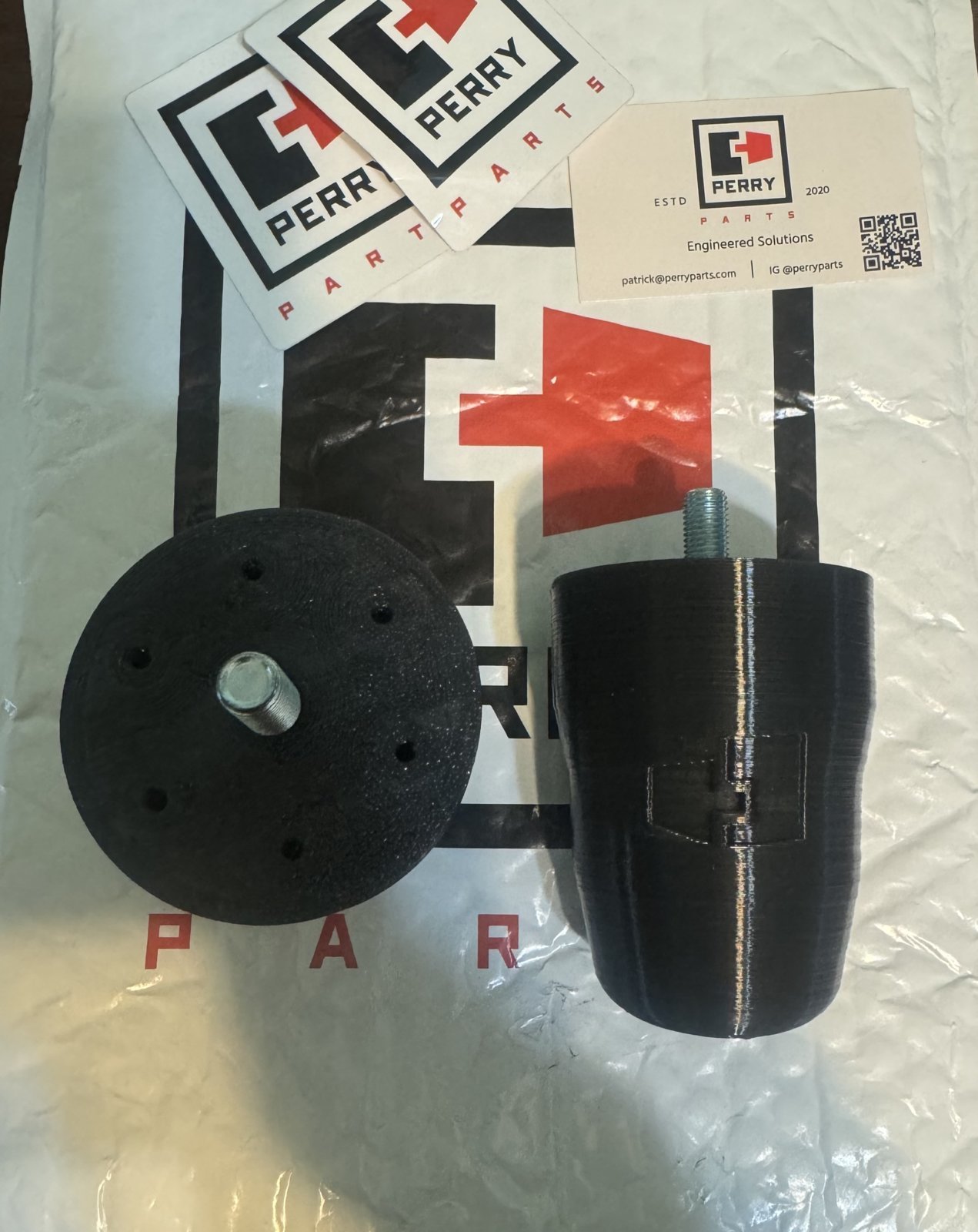

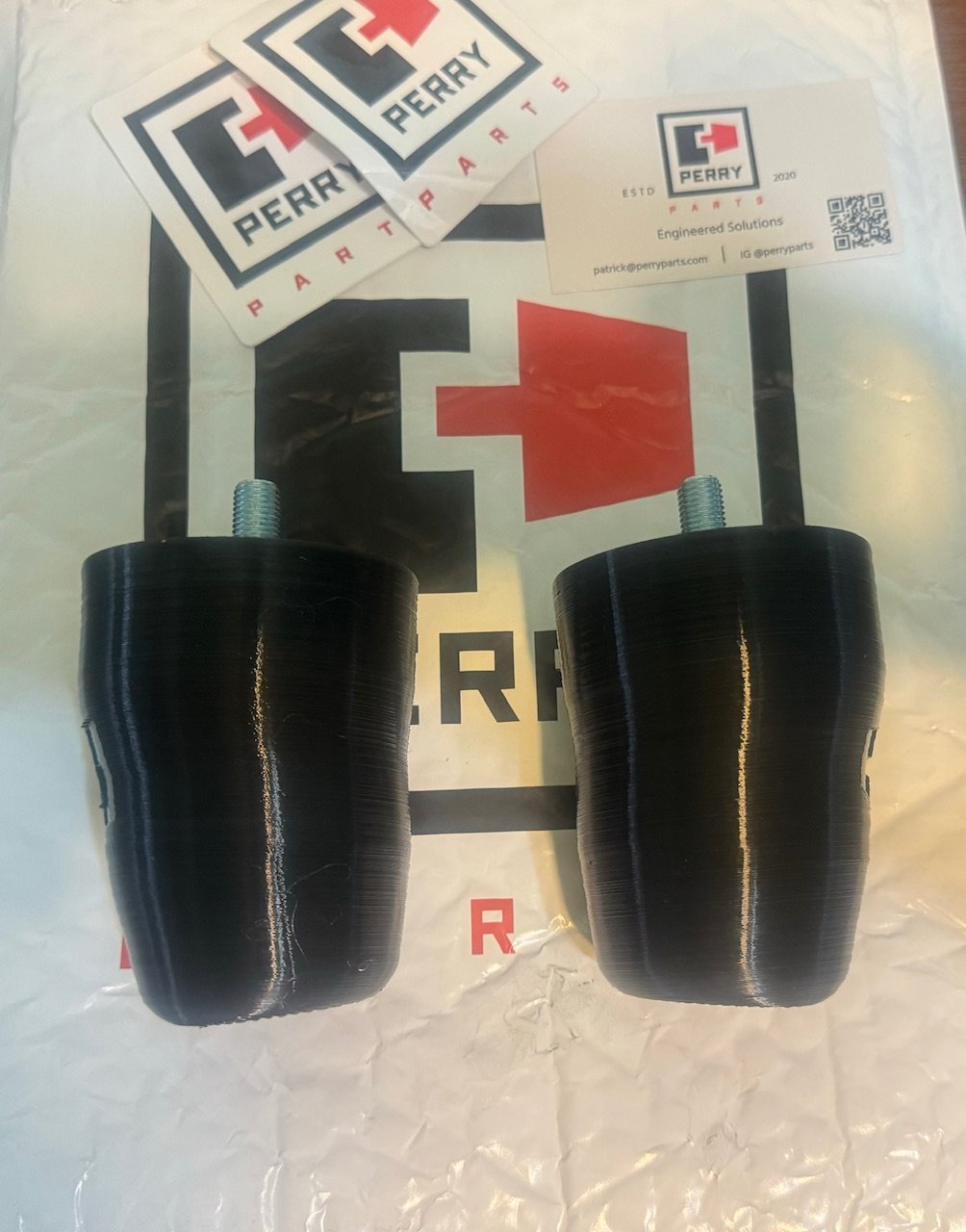

    Welp, showed up today. Pretty nice. These are the LT specific version for 07-21.
    Ill get some comparison pics with my Durobumps if I install them today.

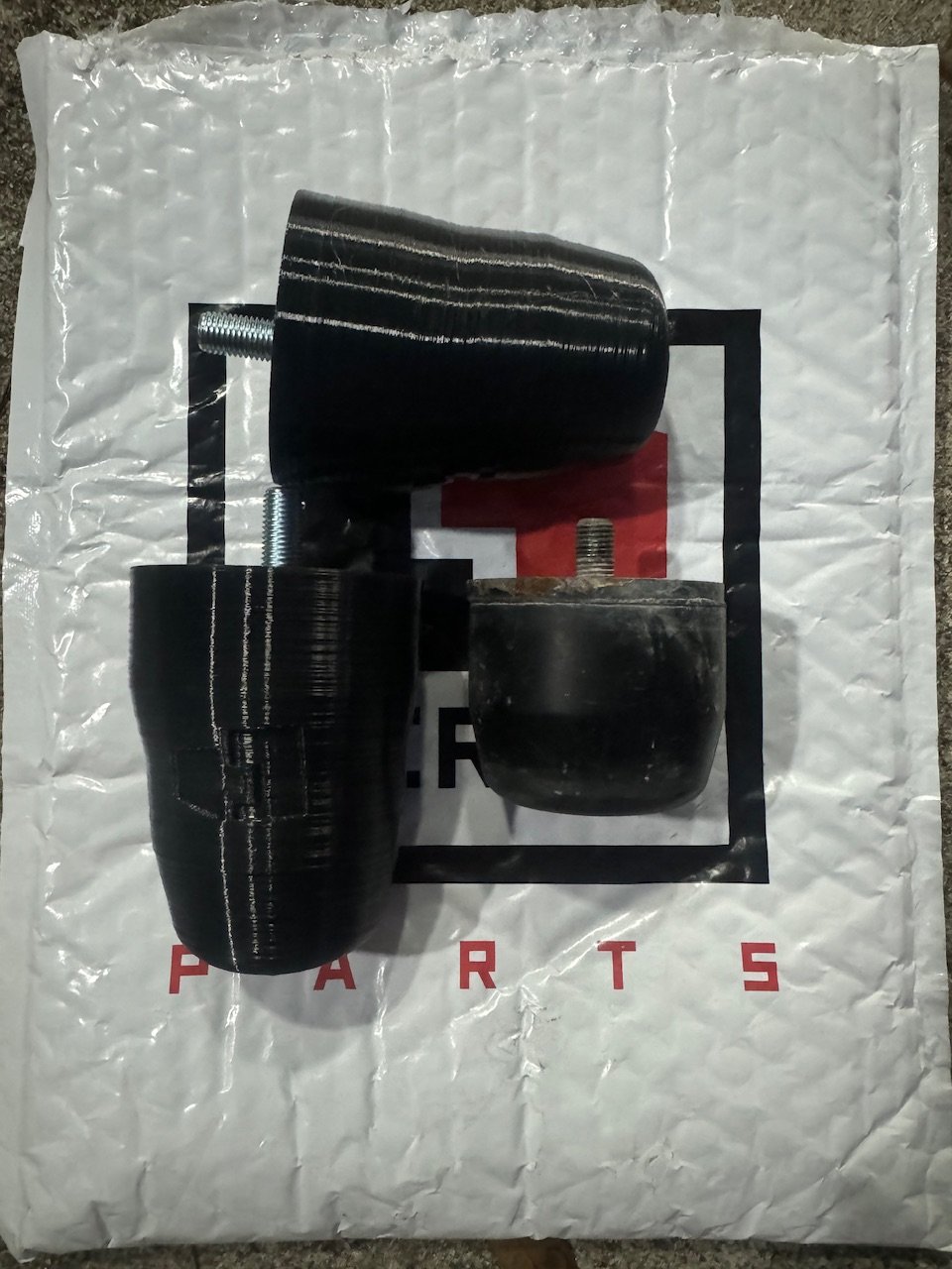

    Was impatient got them on lol
    Here’s some comparison pics to the Durobumps.

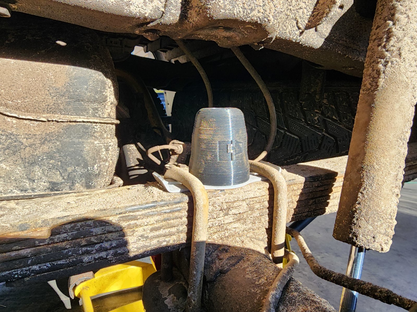

    One side down

    Nice! What spring pack is that?

    Icon RXT full replacement leaf pack on stage 1. Also remember it's on a Tacoma and not a tundy

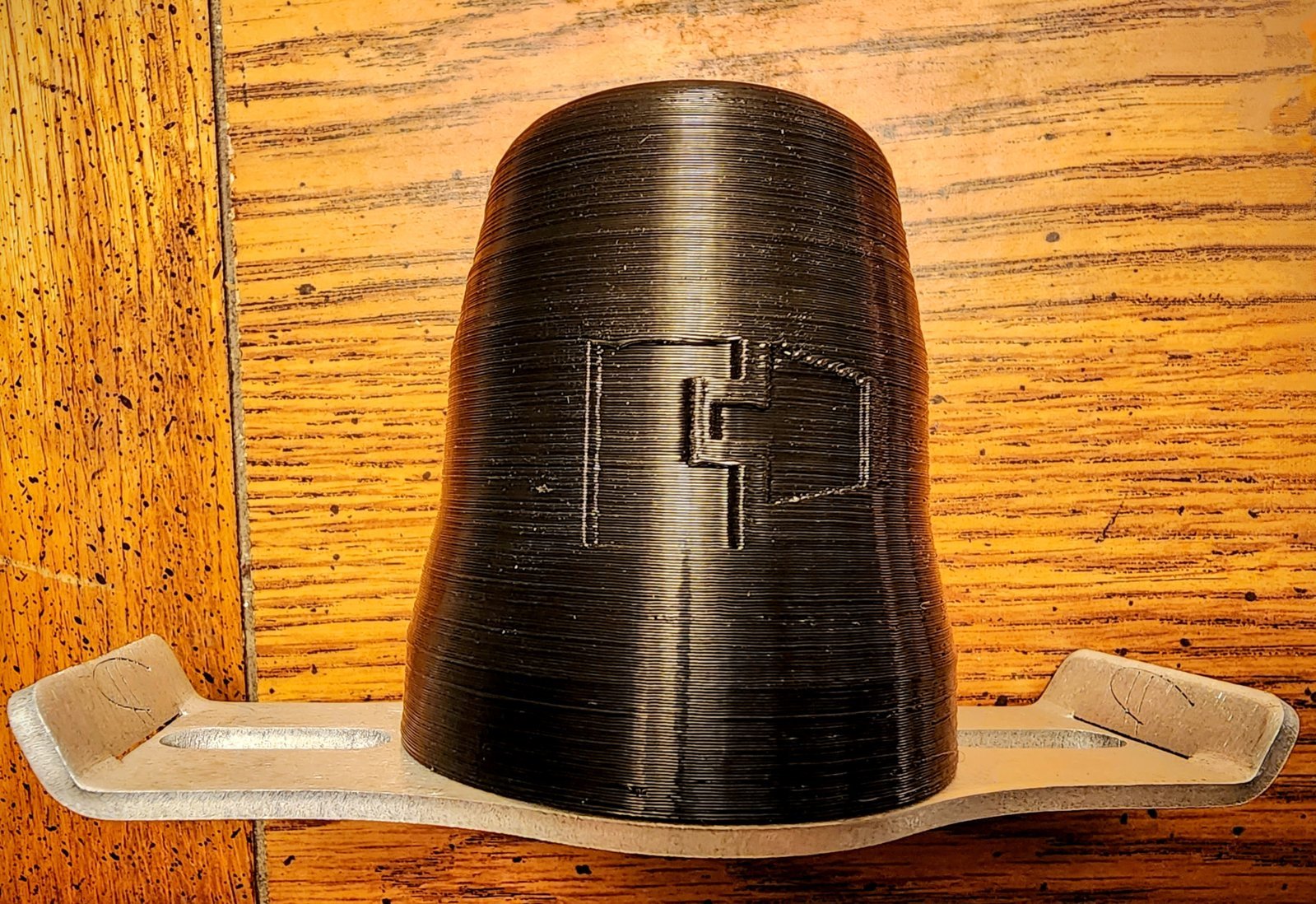

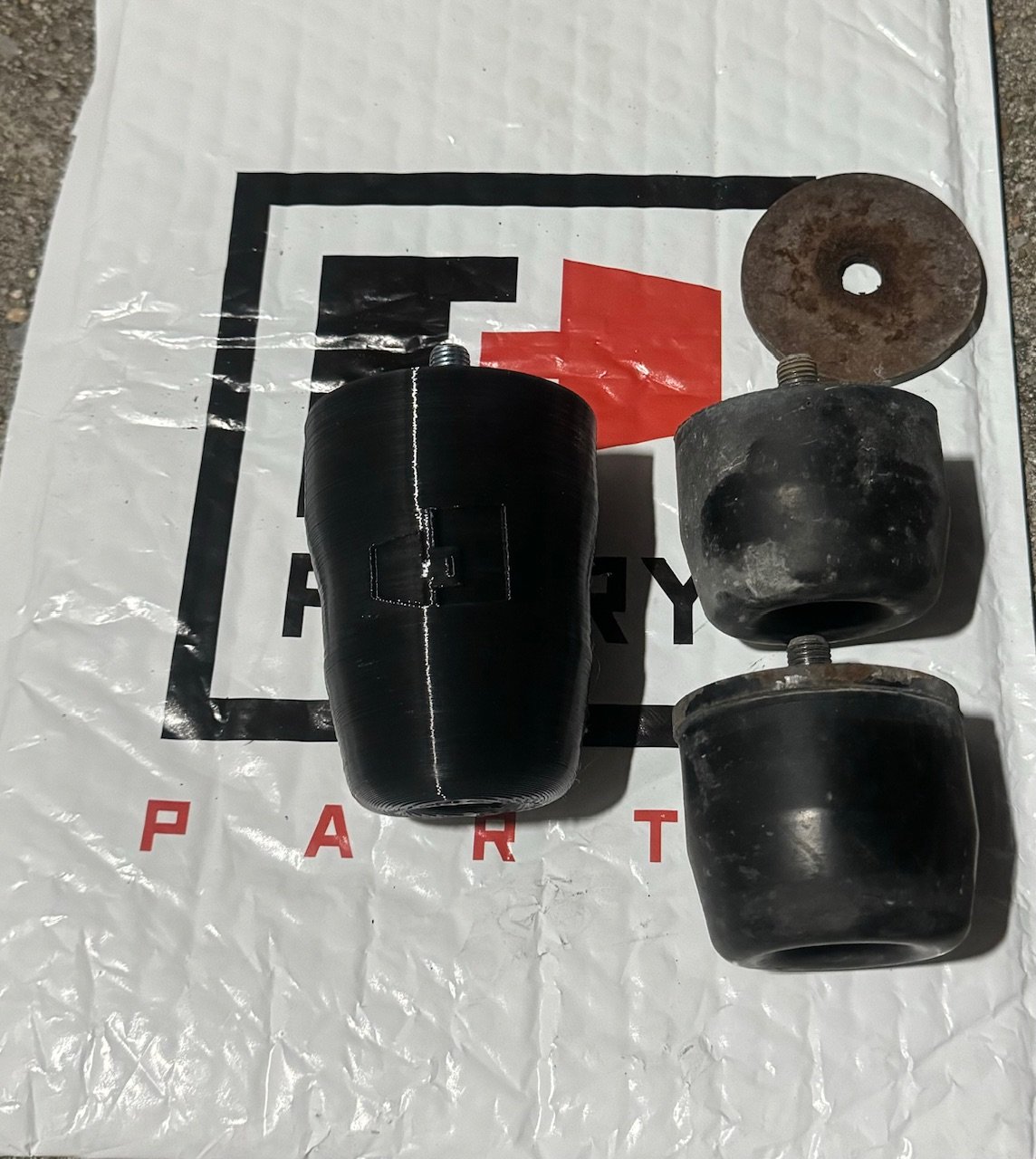

    Pic for size comparison
    Added new Ubolts to the mix. Super easy instal. Don’t need them now but I’m sure I will when new rear bumper comes in and all that aft weight comes in.

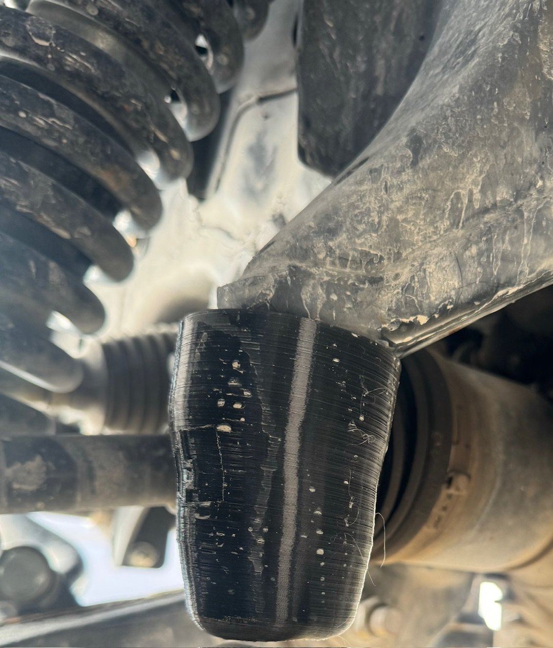

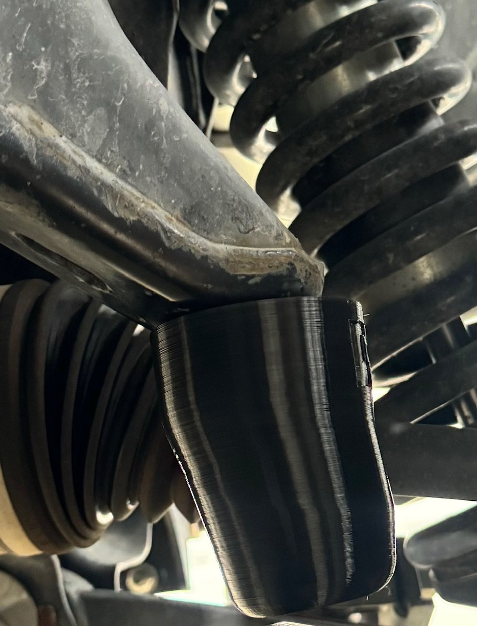

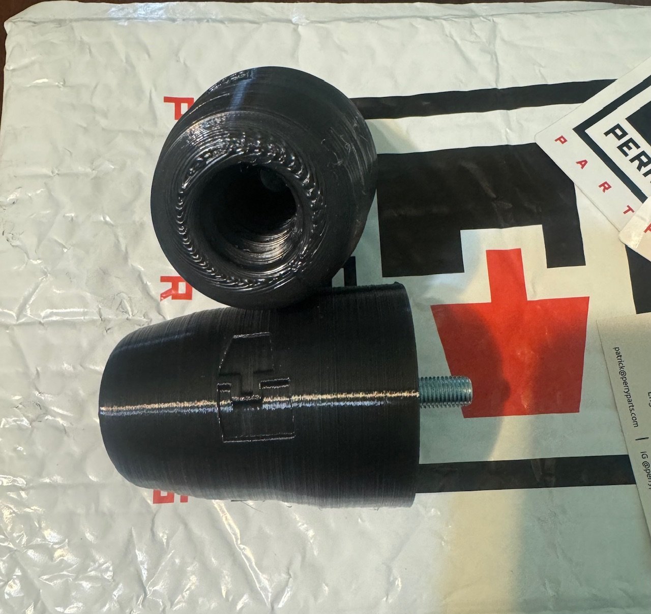

    minor update:
    • emailed Patrick on 1/16 and sent him pics of how the bumps sat and only half the bump made contact with my LCAs.
    • He immediately got back to me and got me set up for an alternative design of the LT bumps for Dirt King LCAs. They shipped 1/19 and I received them 1/29, which wasn't his fault, USPS just decided to stall in Dallas.
    • Got around to installing them this Sunday 2/11 and they make full contact on my LCAs now. Seem the first design might be meant for TC LT and Camburg LT, while the alternative design is for DirtKing like mentioned.
    • First set of LT bumps felt good but these new bumps feel better in my opinion since the whole bump is being engaged now and not just half. Customer service still A+, probably only thing I'd recommend is if you place an order for the LT bumps let him know what LT kit you're running, but if there's concerns of how the bumps sit or feel Patrick is very willing to work with you to figure it out.
    First lt bump, logo towards wheels, curve towards wheels
    alternative dirtking lt bump, logo towards wheels, curve towards frame.

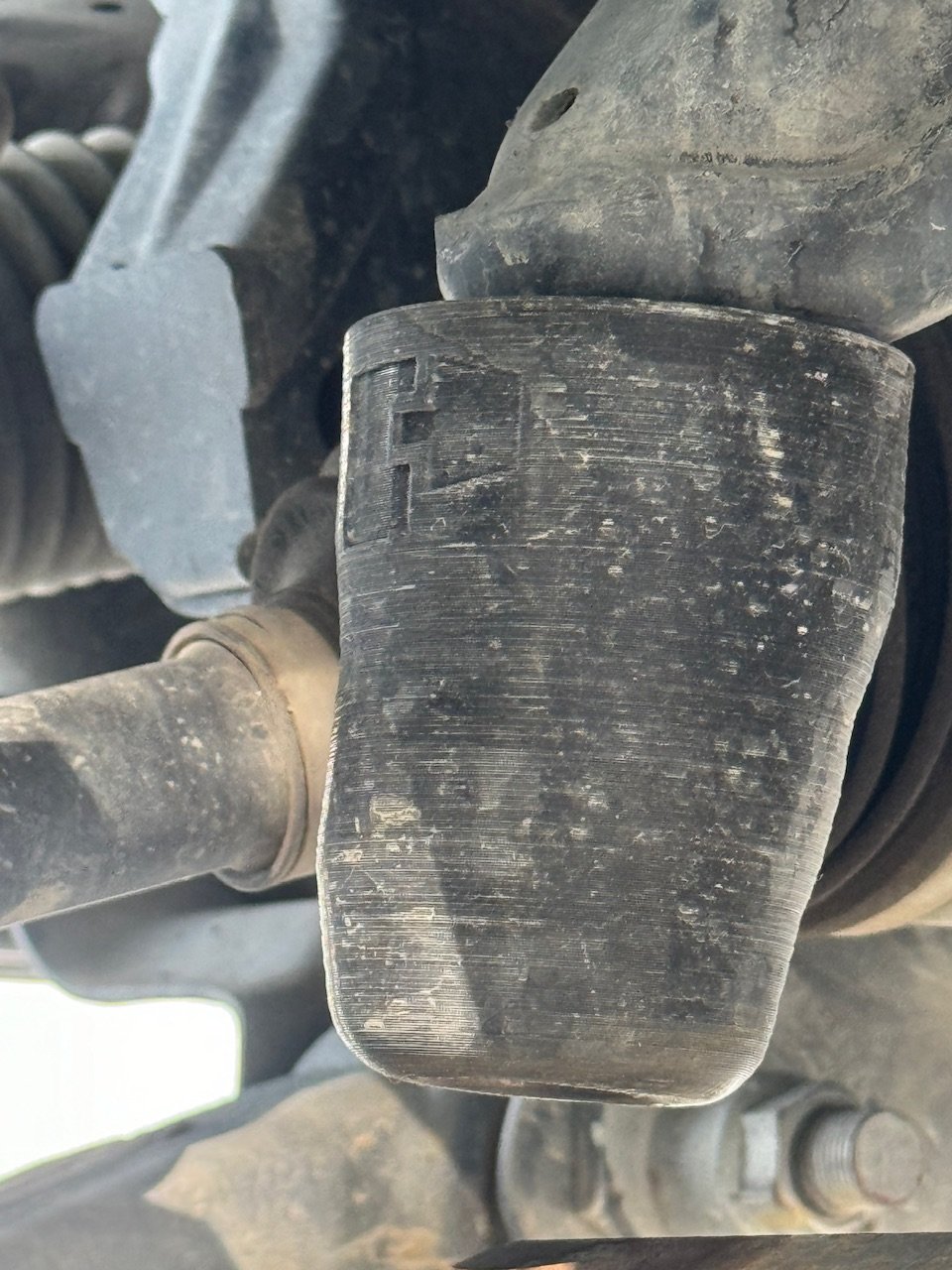

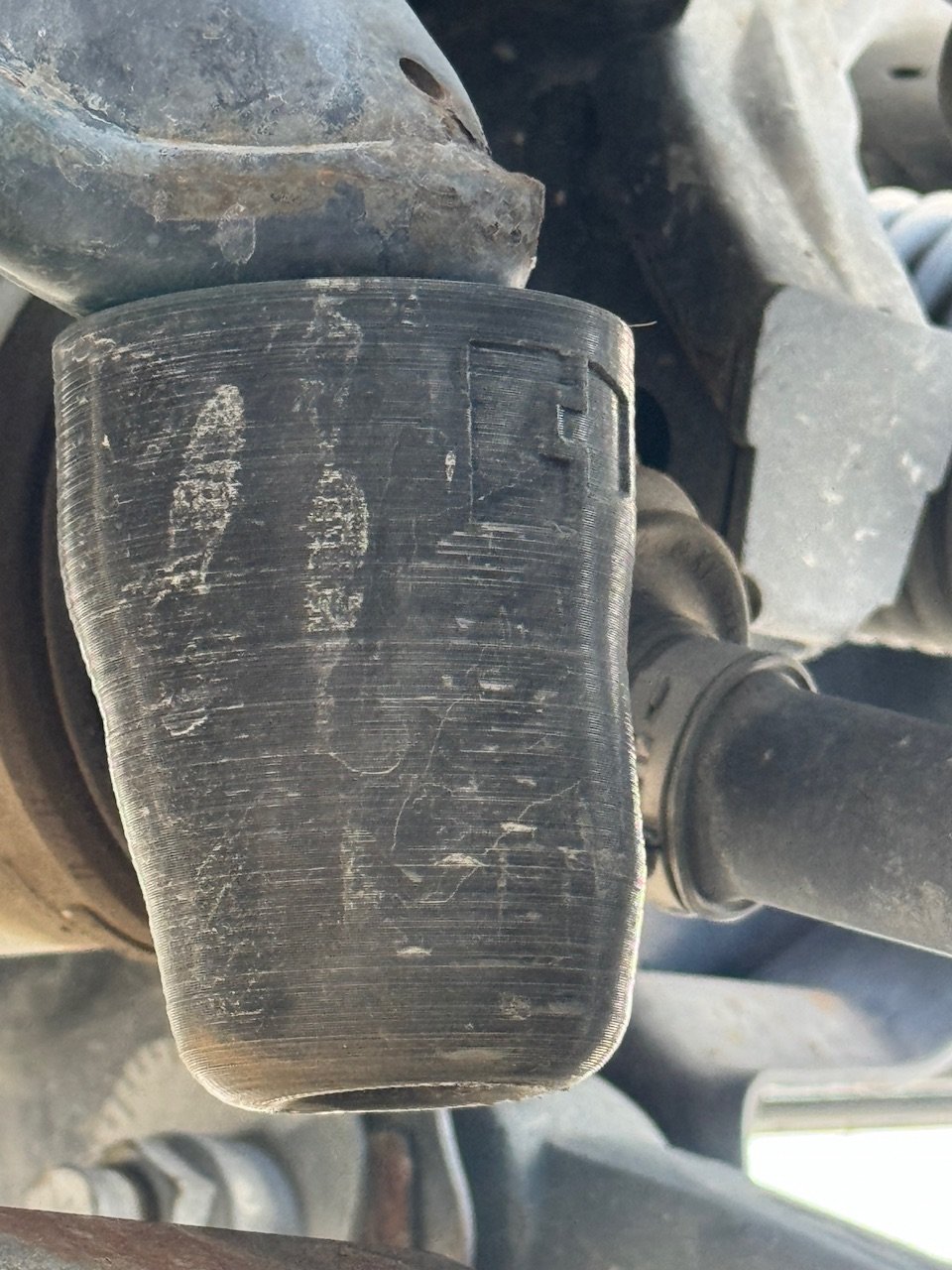

    so 5months in LT bumps(DK option)have been holding up great. No fraying from the material or separation in the layers.
    Passenger
    Driver
