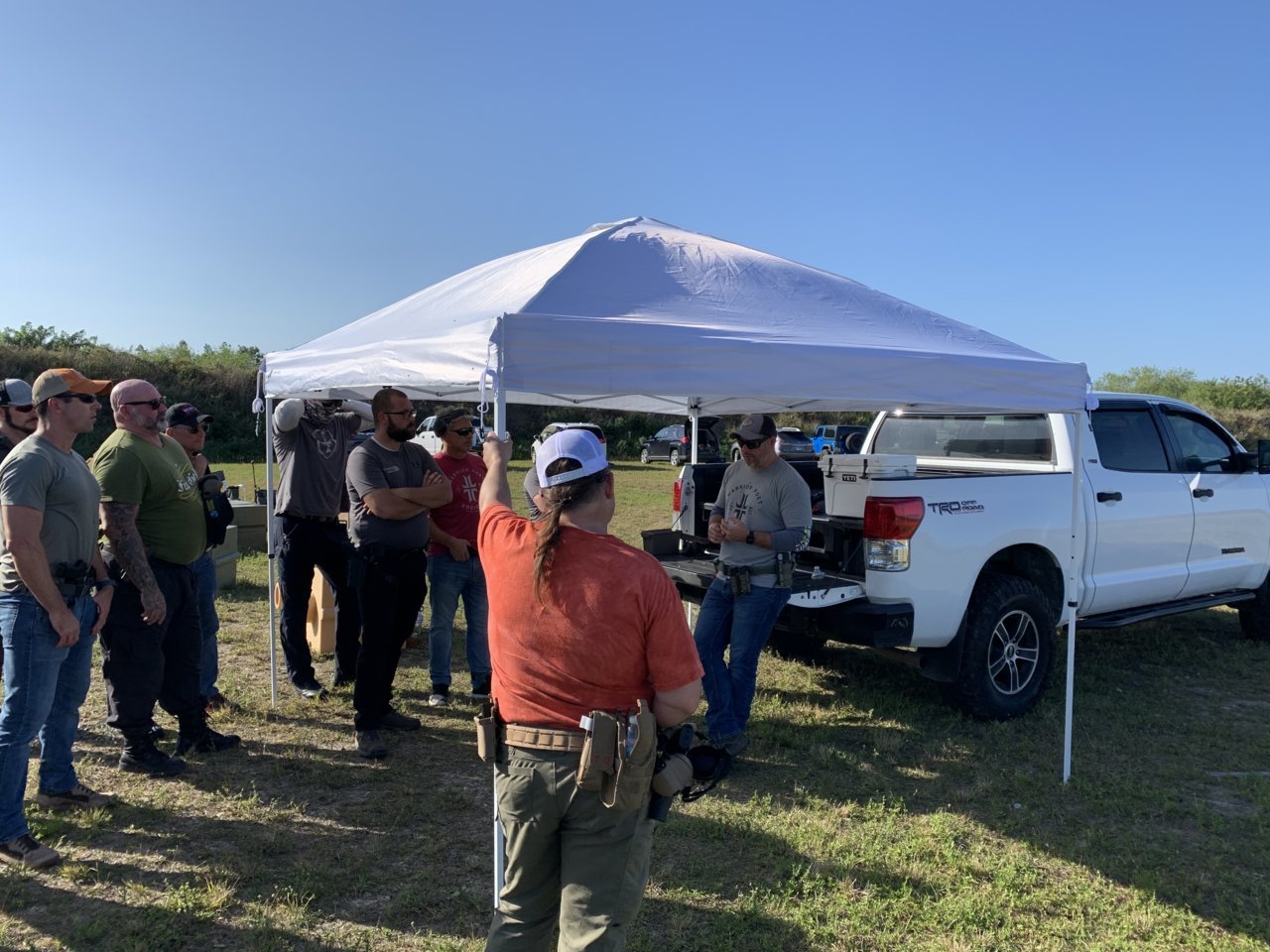

    0431FD23-839A-417C-B028-9B21E2BF6F5C.jpg So I have a 2012 TRD Crew max. It’s my work truck, I travel al over the country in it, practically living out of it when I’m on the road teaching classes. It’s been modified and has some upgrades.
    Winch, bumpers, rocker guards, skid plates, lights and a decked bed system have added about 1000 or so extra lbs on the ole girl. With the 2.5 in OME lift and Falken 35x12.50 MT’s it’s robbed me of both power and gas mileage. I knew this would happen and am totally ok with it as I need this stuff to get into and out of certain places and haul the gear required. It does have a cold air intake.
    But what if any mods would you guys recommend so as to recover a bit of power and or mileage.
    I’ve seen the carbon fiber hoods, the ECU chips, gears, exhaust etc.
    What is a gimmick and what’s worthwhile?
