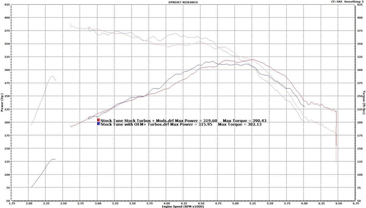

    If the tuning is load based, which I am fairly certain it is, then basically any bolt on parts wont increase power.
    load based tuning means the pcm targets a certain air load/air mass(lbs per minute). It will hit that air mass target by using the wastegates and throttle body to control boost and flow into the motor. Even if you put on an intake that flows better, the PCM will just correct the flow to hit the desired air mass.
    this type of tuning makes the truck very consistent in all kinds of conditions like air temperature and elevation. But it also means you cannot just throw parts at it and expect it to pick up power. Literally people would install larger turbos on Ecoboost F150’s with the stock tune and it would make the same exact power as stock.
    Those “OEM+” turbos with a proper tune can make ~100HP more than the stock turbos. But even though they are larger, the PCM is still able to control them and limit power to the same as stock.

    You’re semi right. Toyota uses a torque request strategy (OV tune/VF tune site explains it too). Basically the engine tries to output a torque based on your accelerator pedal position. The ECM will adjust throttle, boost, spark, etc. to make the requested torque despite the ambient conditions. In the long run, someone will need to crack the ECM to get the best results. Also the turbos are tiny so there needs to be an OEM+ option available for more power.

    Yeah, thats the same thing as an Ecoboost. There is a "drivers demand" table that is in torque based on the RPM and pedal position. But then that torque gets immediately converted into an air load. 400 ft-lbs at 2500rpm = an air load of X. Then the computer takes that and figures out how to create that air load and everything is driven off of that.
    I did read that OVTuning article a long time ago. But they had mentioned how it was super complex. I don't know how many tables Toyota uses but there are I believe 14 tables in the Ecoboost tunes for any given variable that help it calculate out everyhing for different conditions. So there are 14 tables to convert torque to air load, and 14 tables for MBT Spark, and 14 tables for Boarderline spark etc. The PCM in the Ecoboost will weight each one of the 14 tables and then takes a weighted average of the tables. I believe that the OV tuning article mentions "3D" tables in the Toyota tune and it sounds like the Toyota approach and the Ford approach are very similar.
    At least on the Ecoboost, the ignition timing is somewhat independent and the PCM allows for more torque than what is in the drivers demand table, which is why they make such massive gains on 93 octane even with the stock tune. Most of the tuning shops see them pick up ~30 rwhp just going from 87 to 93. I routinely see 480 ft-lbs requested when datalogging my truck on a stock tune even though the drivers demand table is only asking for 406 ft-lbs.

    Thats not a true tune. That device spoofs the signal from the boost sensor to the pcm to trick the engine into making more boost and power.
    As far as the pcm is concerned the engine is only making stock power but that the fuel trims are off and so its adding more fuel to get the AFR to be correct.
    Reality is its making more boost than it thinks and is using the fuel trims to add the additional fuel needed to match the extra boost and so it makes more power.
    They work, but a true tune could probably make a lot more power since its not constrained by how much the fuel trims can compensate.

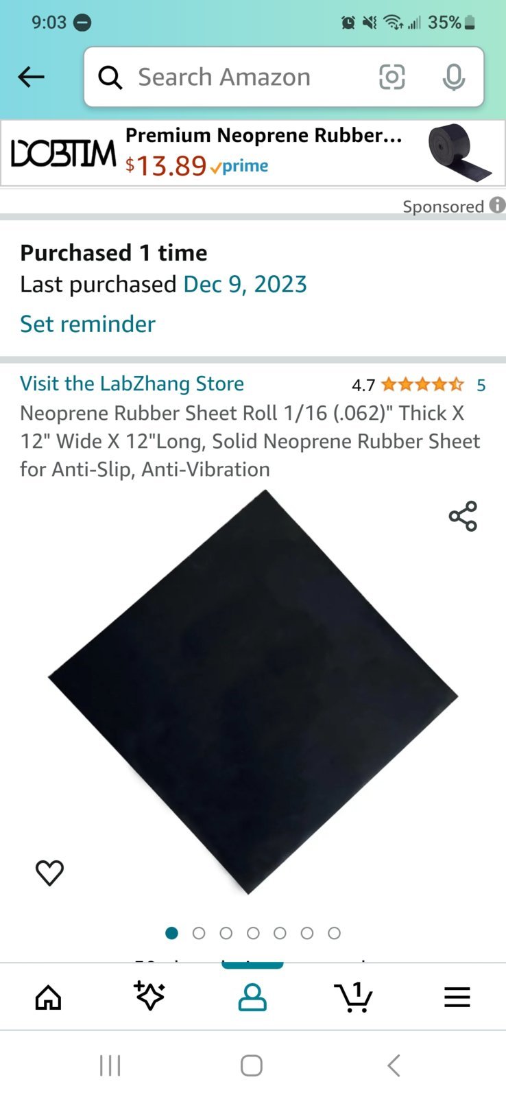

    How did you do the blow off valves with those hot charge pipes? I tried and it didn't look like those were designed to go together.

    So on the blow off valves. It was a bit of trial and error. But we purchased 1/8 inch automotive Neoprene Rubber. Cut out the shape of the valve and then used a leather hole punch for the holes in the rubber. Used it as a spacer and seals off the leaks with no problems.

    Oh sorry. Not 1/8 inch Neoprene... 1/16 inch. Ordered it from Amazon.

    This is what I got.... Screenshot_20240210_210300_Amazon Shopping.jpg Screenshot_20240210_210300_Amazon Shopping.jpg
