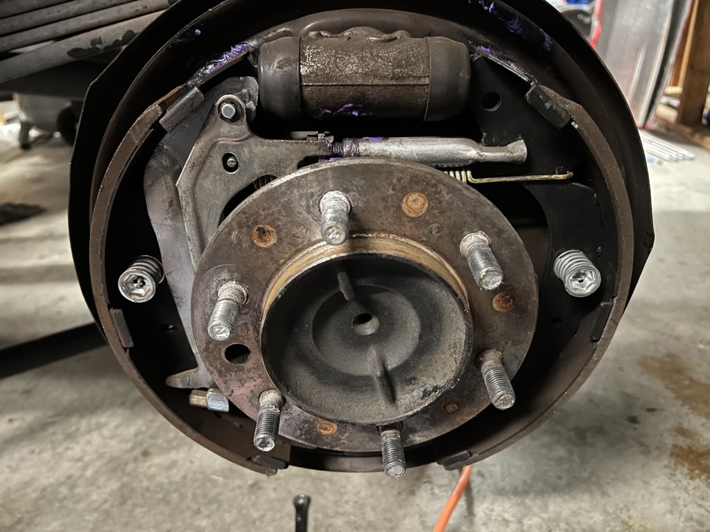

    Throw some pics up. Typically the rear brakes hold the key to proper adjustment

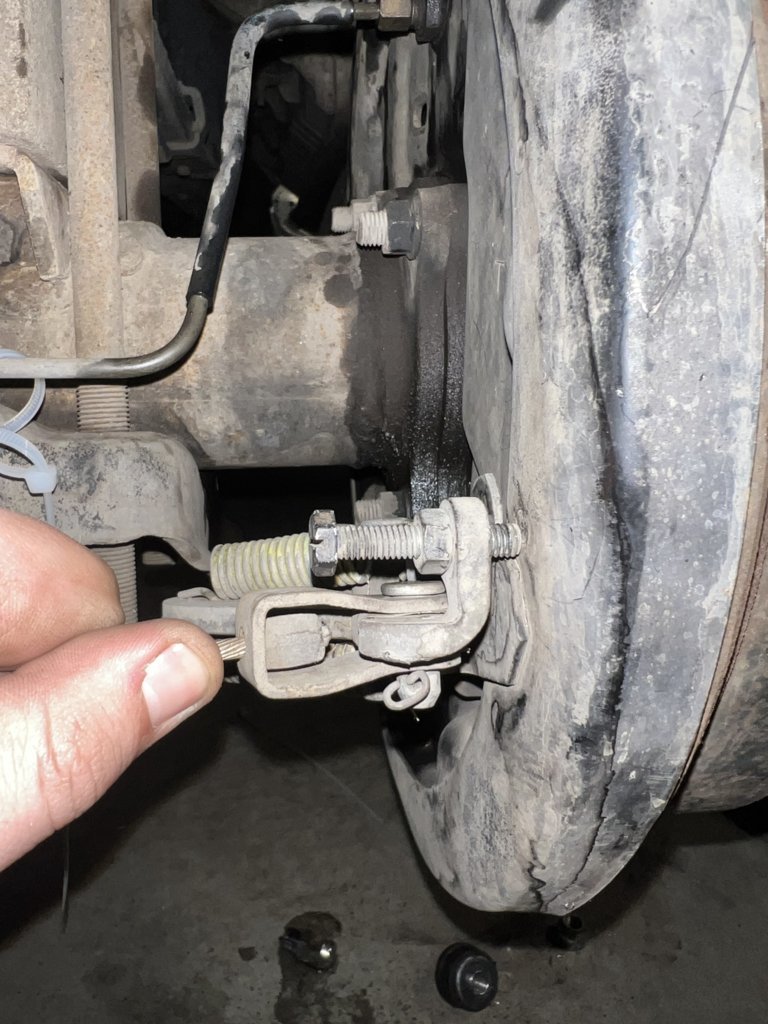

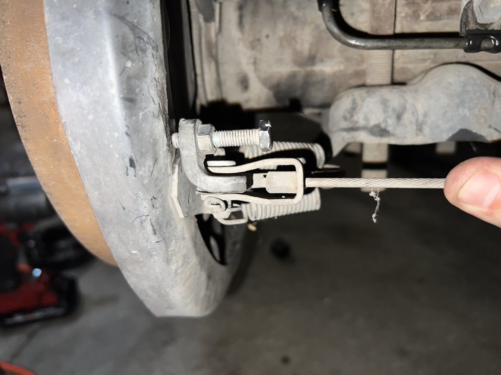

    This is the rear the e brake is 1 mm before contact

    Did you manually crank the (star wheel) rear brakes out until they just drug/dragged on the drum?
    After I did that I got in the cab and gave that Parking Brake a real workout as well.

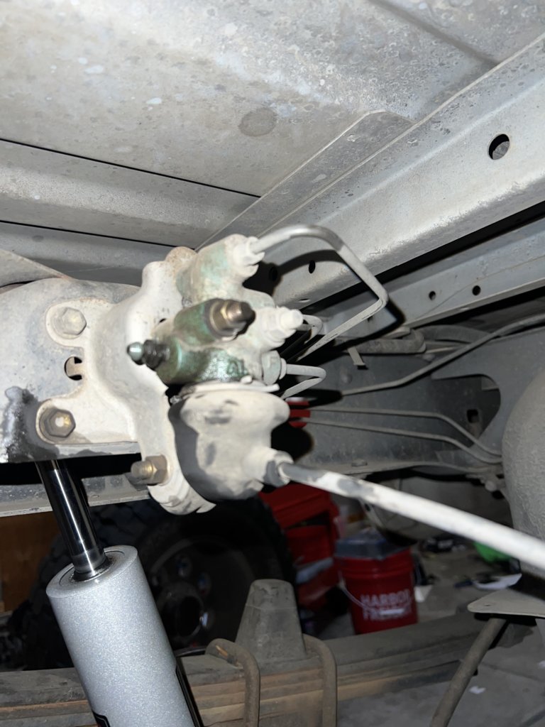

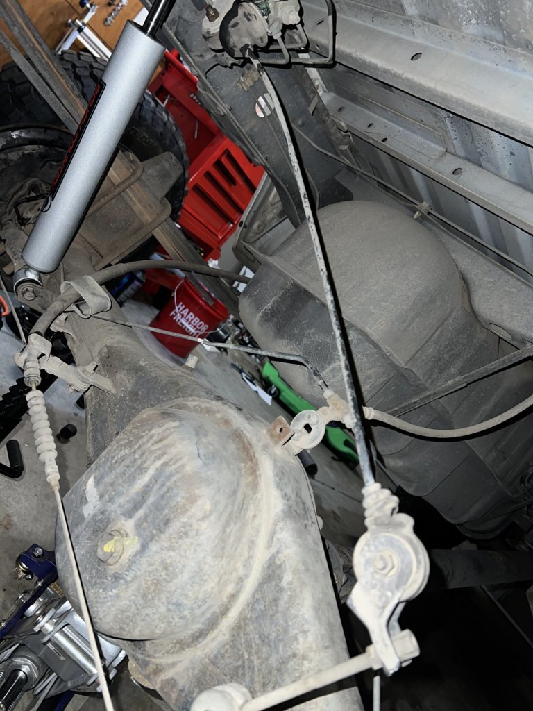

    You want to test the LPV, Pull the bar off the axle and strap it up as far as you can (simulating a heavy load), take a test drive. You should have MAX flow to the rears.

    Yup, those giant rear blocks are the root of the problem. Your LSPV rod needs to be relocated as in @w666 post with pics. Remedy that and check back in.

    Sorry for the wait I only work it on weekends yes that was fresh brake fluid currently waiting on lpv drop bracket master has no leaks haven’t clamped vacuum line to test booster

    You're 100% confident the star adjuster is dialed in correctly, so the tire doesn't spin freely, it has some drag, but not so much it isn't locked up?

    Yes I bleed the lpv directly using 2 person method yes star cluster is dialed in made it drag a little harder than what I like I’m starting to think booster or lpv drop bracket
