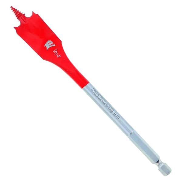

    Try a spade bit the width of the pcv valve and work it loose with a 1/4" socket wrench...the side teeth may grab it better...if you have something like that laying around.

    That worked thanks so much! Now if some small plastic shavings got in the valve cover am I completely screwed and need to remove it all?
