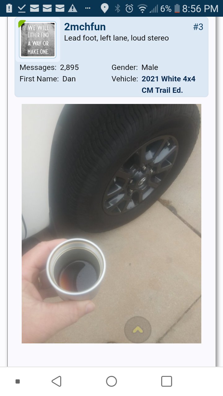

    Dang! Are you using 0w20 oil or something thicker? I got more when I used what was recommended...5w30 now for me...
  7. Jan 19, 2022 at 4:08 AM
    2mchfun
    Dec 31, 2020
    #56879
    6,494
    Dan
    5w30 mobil one
