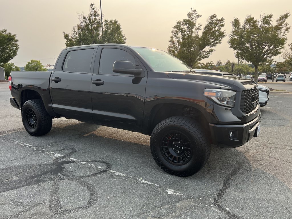

    Thx MadMax Like I said, not sure of the lift height. Here is a pic of the truck. If you have a guess on the lift height I’m all ears. Thx again

    Some lifted trucks never have an issue with the pre collision sensors. Some never can function correctly after the trucks been lifted past 2-3” up front. You can try raising the rear an inch or so get a little rake back. But it’s no guarantee it will resolve the issue.

    To check how much body lift measures front center of wheel to the bottom of fender, stock is about 21.5 inch, back is 24 inch.
