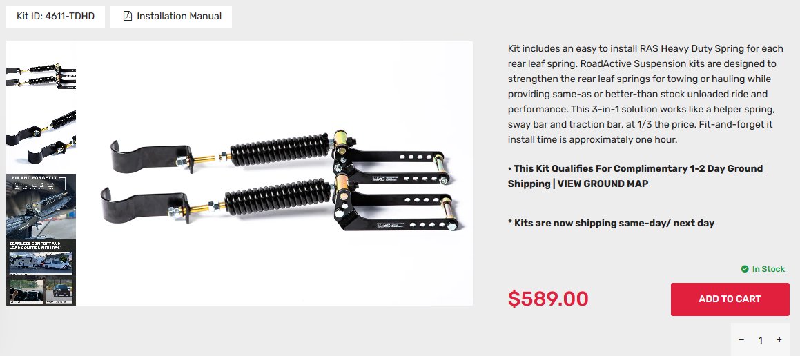

    RAS, Supercharger and a bag of jerky!! You'll experience the most smiles a half ton can muster!!

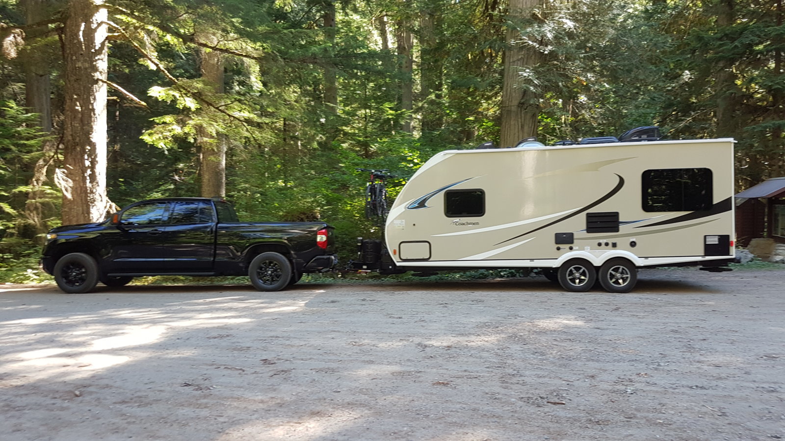

    No issues... My trailer is pretty light @ 5,500 lbs GVWR, and I'm pretty close to that most of the time I tow.
    My Lance has quite a bit of storage and I load what I can in there. I also tow with a full fresh water tank; I know the water quality at my house, and I prefer how it handles with some tongue weight.
    I'm almost always close to, if not occasionally a few pounds over payload, but I keep it as close as possible. Popular opinion is that our Tundras are overbuilt a bit.
    Of course all my happy campers have to come too!
