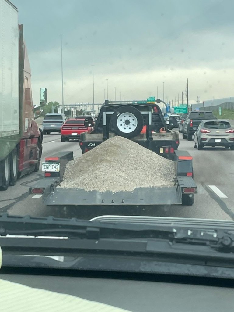

    Hopefully not like this ding dong. :rofl:
  5. Jun 2, 2025 at 9:08 PM
    33,405
    18" TRD Off Road Wheels
    Dude, my paint chipped and my windshield is blasted just from looking at that. :eek:

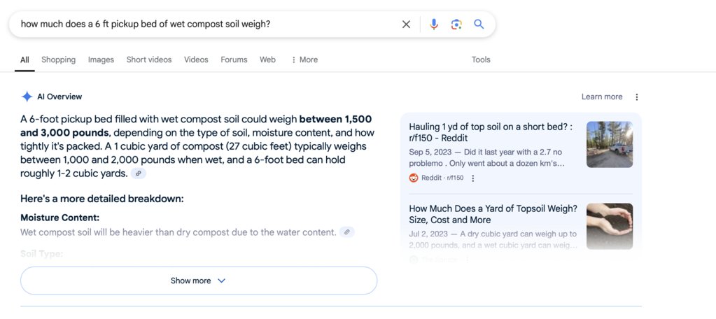

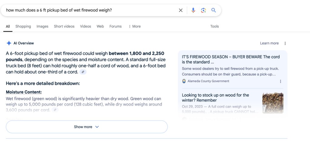

    Everything goes by weight. just use the ole noodle.

    Yeah, if you fill your bed with those you're going to be overloaded. There's no visual indicator.
    As @PermaFrostTRD demonstrated, you can research and get an estimate for your weights. It's how it's always been done unless you have a scale and get before and after weights.
