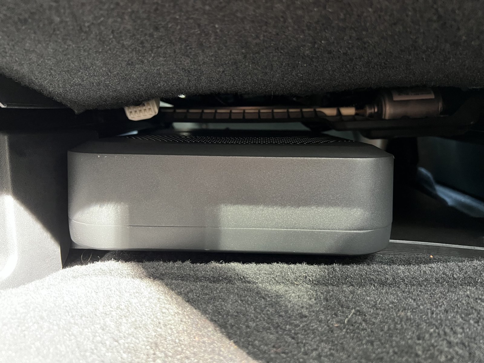

    Steve
    2017 Tundra Limited CrewMax TRD Black
    Hi, just purchased an Alpine PWE-S8 compact powered subwoofer and will be mounting it under the front passenger seat in my 2nd gen Tundra.
    Does anyone know of an inexpensive mounting bracket that I can use to secure the subwoofer?
    I'd like to get the bracket that comes with the Alpine PSU-300TND kit, but that kit seems to be discontinued plus the bracket is not sold as a separate item.
    Thanks.

    Thanks, just ordered that one. Looks like it should work perfectly.

    I forgot to mention, you most likely have a factory amp under the passenger seat that you’ll have to mount to the new amp rack as well. The stock amp is pretty small and looking at the sub you’ve got it doesn’t look huge so it probably won’t be an issue.

    I installed the Sounds Good Stereo Custom Made Amplifier Rack/Plate/Board under my front passenger seat, the Alpine PWE-S8 was a PERFECT FIT using that mounting board. Thanks for the suggestion!

    2021 SR5
