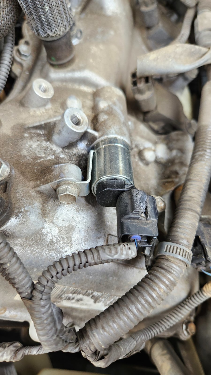

    Trying to figure out what fuses could have been blown by my battery clamp broke and the positive the shorted out the cam shift position sensor. Replaced the sensor which got rid of the code but now still have no traction control, dome light, door locks only work while running or shortly after turning off ignition

    Thanks Black Demon, it wasn't a rodent, my battery support broke, the battery slid and the cable touched the manifold and shorted it out

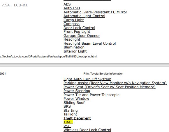

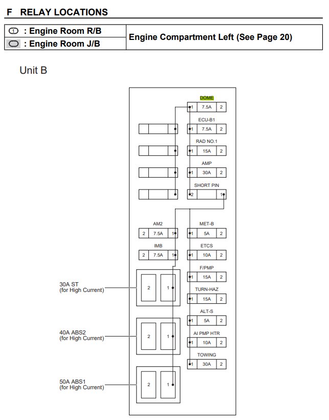

    Fuses to check, all of them.:eek2:
    I'd start with the dome fuse and the ECU-B1
