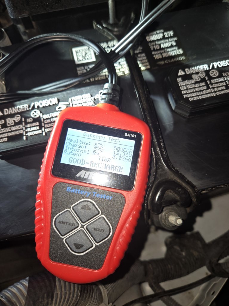

    2021 SR5 CM 4x4
    Here's the current status of my OEM battery on a truck with 27K that's not driven much. I normally full recharge monthly. Short drives won't cut it.
