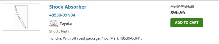

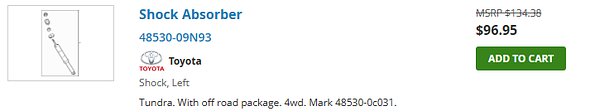

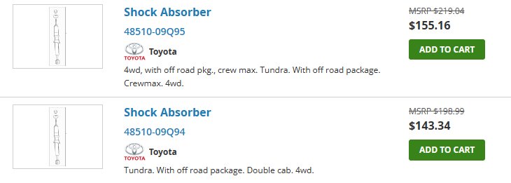

    Thanks, that however if for the TRD Pro options. If going to spend that type of money might as well upgrade to Dobinson's

    Have you tried locally for takeoffs? As we get further away from 2021, it will be harder to find "like new" take-offs just laying around taking up space. Also, have you tried our forum marketplace?
    If the availability isn't there, "upgrading" to 5100's probably won't cost too much more than the TRD OffRoad branded shocks.
