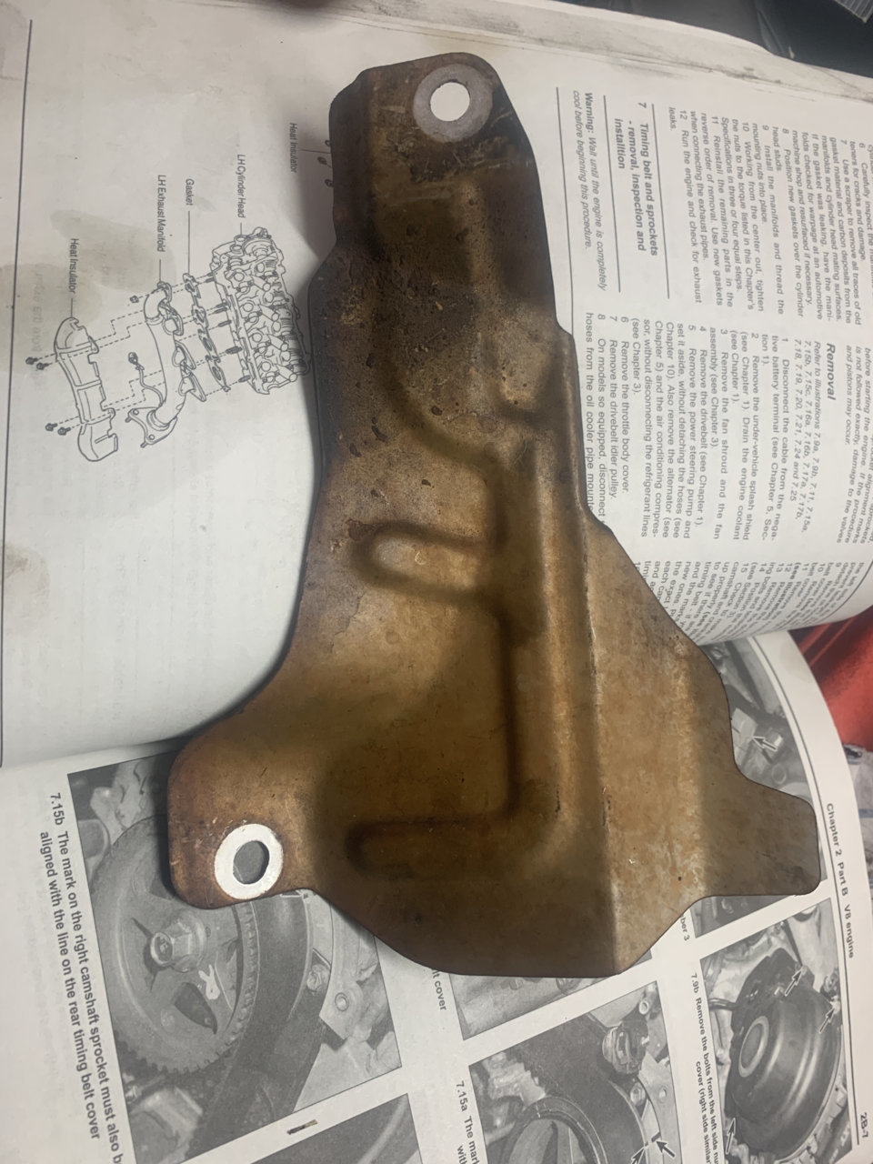

    Hey guys, I am at the end of a rebuild and I have an extra heat shield that I can’t figure out where it goes. I think it was on the drivers side covering the wiring but it doesn’t seem to fit there.
    Any help would be greatly appreciated.

    Looks kinda like the one on the driver side rear of engine that covers a little wire chase
    It might go on over the header flange.

    yes. It did come from the drivers side. I put long tube headers on, do you think I still need it? There is no part number on it.

    Oh if you put long tubes on throw it in the trash, it doesn’t fit once headers are on, I think it used a mounting point on the old manifolds.

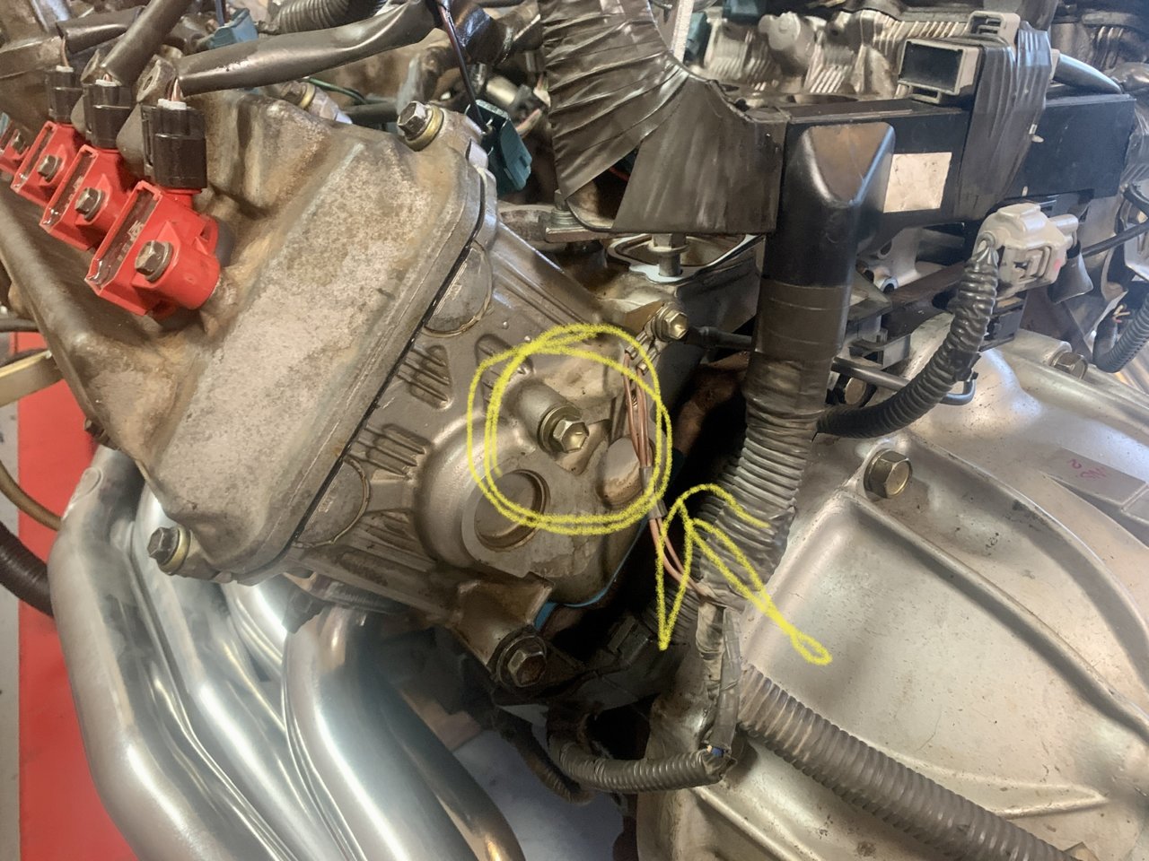

    Thanks. One other thing, anyone know what is supposed to go on the back of the drivers side head?

    I think we agree that I don’t need it since I put long tube headers on. The only other issue the bolt on the back of the drivers side head that looks like it should hold something. I don’t have anything that attaches there.

    @empty_lord look above

    I put mine on just because. But it’s only held on with one bolt

    Look at the bolt on the back of the block he’s wondering about.

    I don’t see a photo of the block?

    Pretty sure he has 2 grounds going to the one bolt when the one with brown wires should go to that bolt that’s not got anything right now.
    I may be wrong though. I don’t have the truck and won’t till Monday to check
