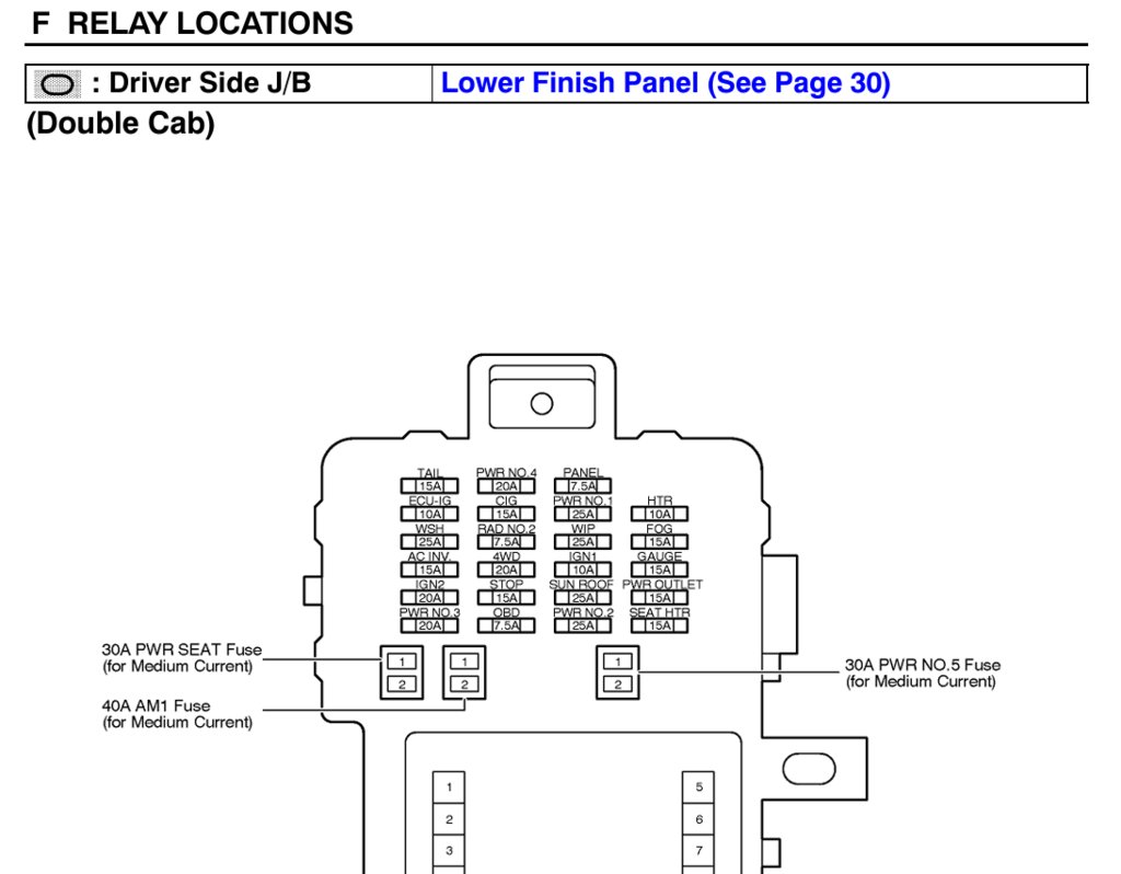

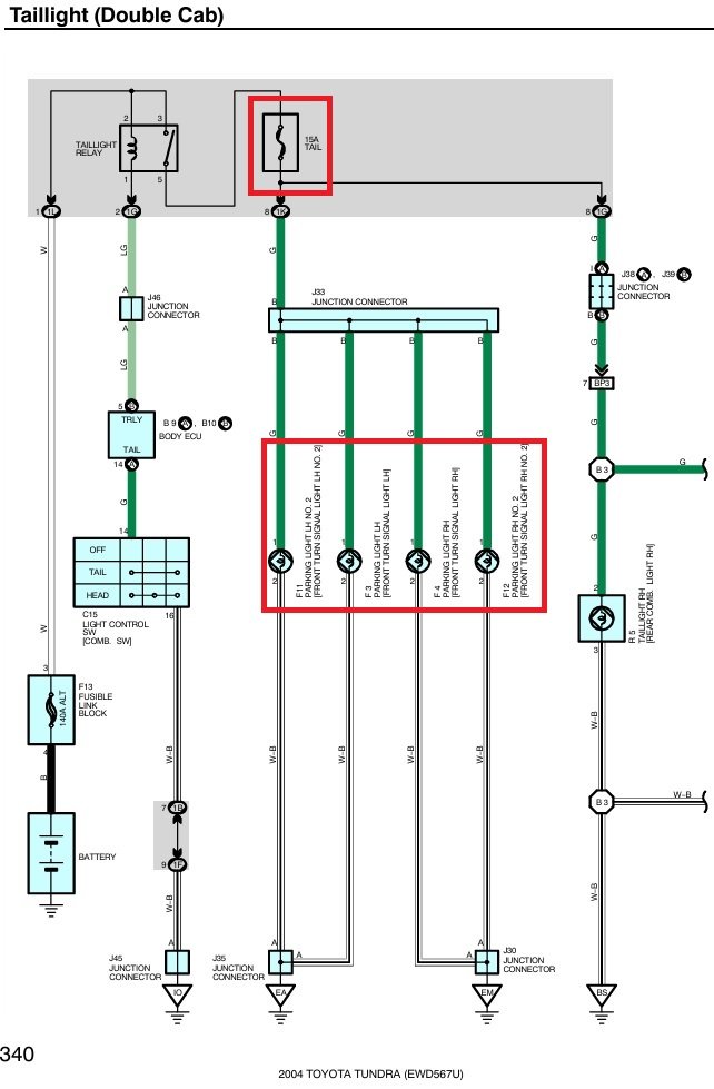

    Will assume your profile mentioning "crew cab" is what Toyota calls a Double Cab.
    The parking/tail lights are protected by the 15A TAIL fuse in the cabin fuse panel, top left.

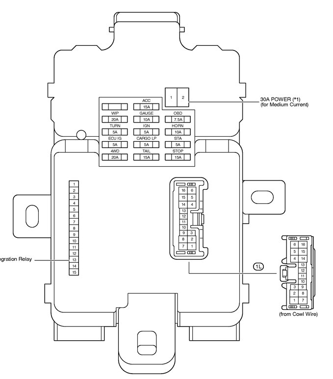

    It will be LOCATED in the underdash fuse box on the driver's side.

    That was so bold of you
    That’s one way to find out their meaning of “crew cab”….you show an AC fuse panel and I give him location for DC

    Sorry Bubs, it's in the same location, it just has a different layout.
    Besides that, we're really not sure which truck he has, so now I've posted both.:thumbsup:
