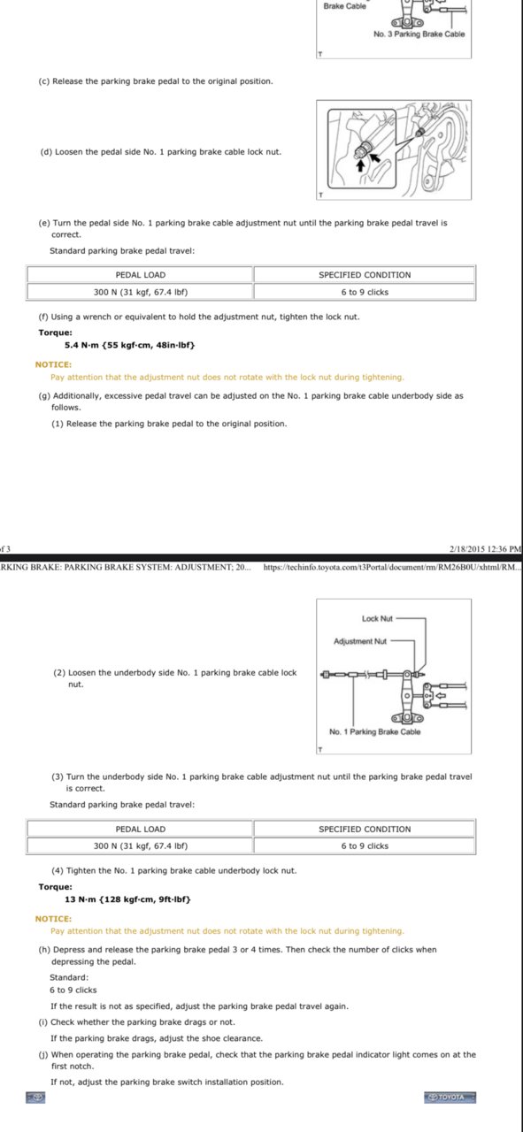

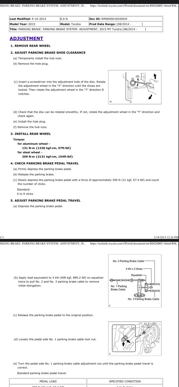

    Anyone one ever fail their truck inspection due to a parking brake not holding up to 1500rpm? I just got denied my inspection for this.
    How do you adjust your parking brake??

    Here are the instructions. GL.
  5. Aug 13, 2020 at 8:33 PM

    OP has a third gen. Is this procedure the same for the third gen Tundra’s?

    Yes, I adjusted my 2017 using this video a couple of months ago. The parking brake actually holds now and doesn't go all the way to the floor.
