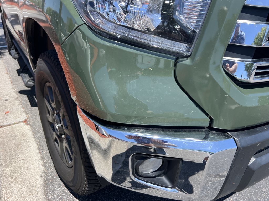

    Bought a used ‘21 and this little panel keeps popping loose at the top left and feels loose at the bottom.
    I keep popping it back into place. I’m assuming someone broke some type of retaining clip while changing headlamp bulbs.
    What’s the best fix? Are their clips back there I need to replace or can I use Velcro or mounting tape?
    Thanks for any advice?

    This happened to me when changing out some things; i used a zip tie to secure it in place. Drilled a hole in one of the "fins" on the back and zip ties around a secure point behind it. Will see if I can get some pictures later this week

    That would be helpful. I’m tempted to use silicone around the edges but may have more trouble removing in future.

    Don't silicone it, you need to remove it to replace the headlight and parking light bulbs.
    Since you have halogen headlights, that happens too often..:(
    There are 2 inner clips for that part and two bolts hold the outer part in place.
    Make sure the outer edge is 'clicked/pushed' into place.
    This part of the video shows you that part.
    https://youtu.be/COmW6j2A1EU?si=hDpa3cmwCIFLKZ8f&t=164
    The entire video can show you how to pull the grille and headlights.
    https://youtu.be/COmW6j2A1EU?si=LaoTV8X6I1llvS3S
    This is the inner clip.
    1997-2025 Toyota 1997-2024 Toyota - Bumper Cover Clip 52161-02020 | Sparks Parts
    $7 for 20 on Amazon, they are used all over the truck.
    Amazon.com: Rexka 20pcs Fender Liner Bumper Cover Grille Retainer Clips Compatible with Toyota Lexus 52161-16010 52161-02020 : Automotive

    Thanks gents. I’m convinced they put this grill back on without the inside retainer clips since it seems loose all the way around. Just ordered some and will pull the grill and get everything back right soon.
    Might as well go ahead and replace bulbs while I’m at it.
